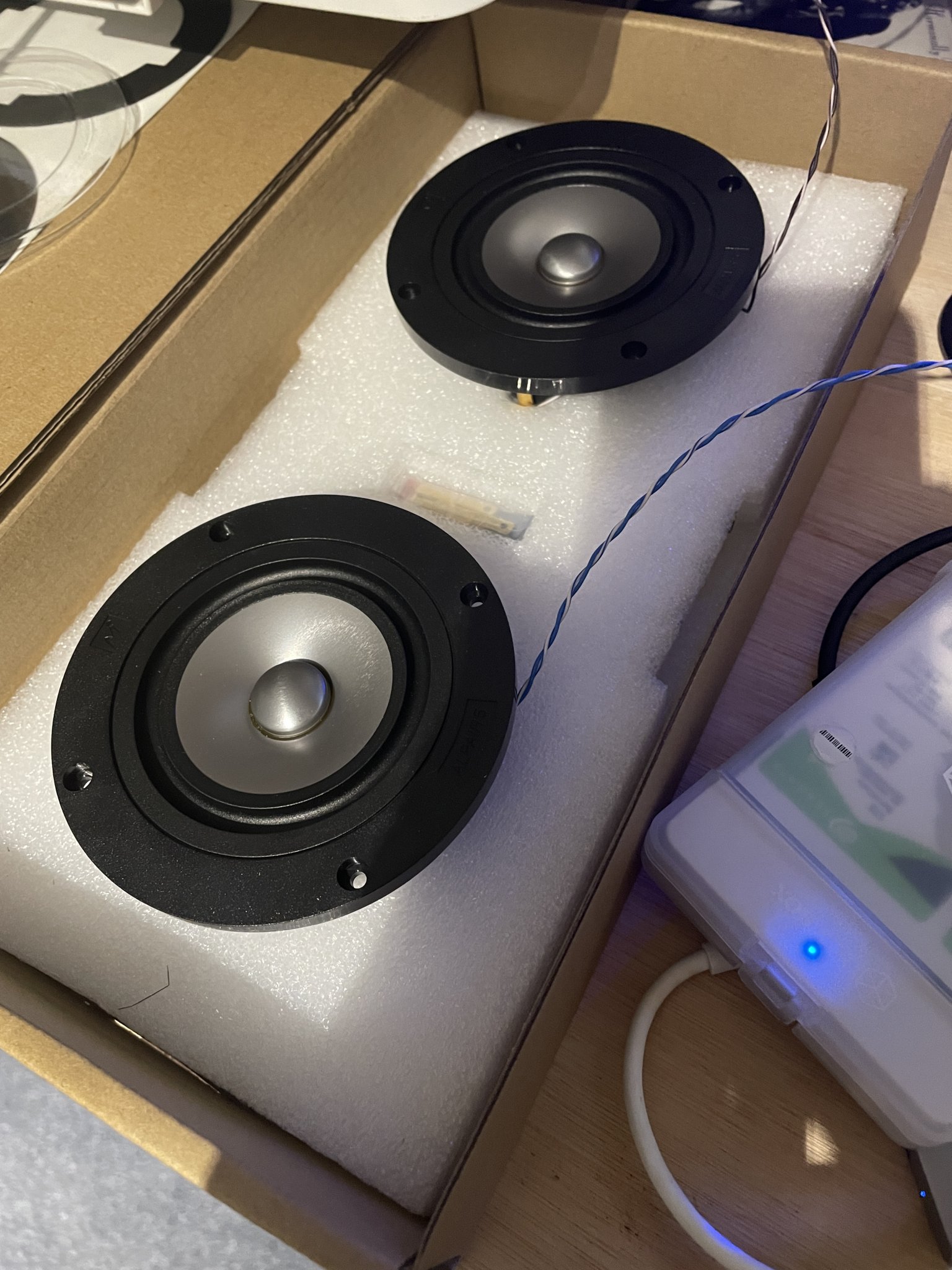

My pair of Apair 5.3 have arrived. They're tiny !!! I'm running them in on my desk just playing on random through my music collection. Every now and then I hear some detail of instrument texture sound or something in the layering of the track I've not noticed before. Can't with to get these going!

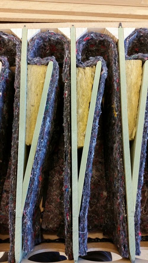

There's the reducing chamber of the Tyson, but that appears to have an opening at the narrow end. Along with progressive stuffing I think this makes for an aperiodic design? Not sure of the specific benefits but I trust Dave, Chris et al. Maybe someone could explain it better for me as I've not dealt with this type of tuning on a high frequency driver?
I saw this as an alternative on a full range line array. What do you think?
…. an opening at the narrow end. Along with progressive stuffing I think this makes for an aperiodic design?
An aperiodic midTL. Low pressure, “sucks" the back wave down the line, flattens the impedance curve (good for passive XO), but won’t reach quite as low as say a sealed box.
picture looks like a weakly damped half-wave (closed) TL.
dave
