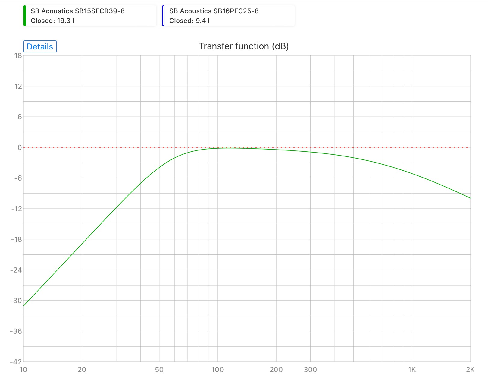

For the bass I’ve always liked the look of the SB15SFCR39-8 from SB Acoustics (https://doc.soundimports.nl/pdf/brands/SB Acoustics/SB15SFCR39-8/SB15SFCR39-8.pdf) A pair in an opposed side firing,push push design but sealed. This might be nice as they have a lovely deep roll off for tuneful lows In a sealed box.
Am I nuts for going sealed? Will the Alpair 5.3 keep up? What sort of positioning in the room should a Tysen have with its side firing woofers? I’m used to much larger speakers 15/10/1.4CD inch drivers, but have lost WAF. I know the A5.3 is renowned for detail so I’m wondering what sort of picture will this design can paint?
Any thoughts would be greatly received.

I like sealed, what we used in Ellipsa (by do i miss SDX7), but a driver that works well sealed is hard to find, i will have a look at the SB. Sealed allows for EQing as low as the power you have and the excusion limits are not pushed too hard.

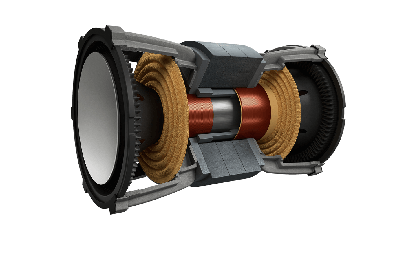

Disucussion of the LS60 has, finally, really slammed home the advantages of push-push and the sensibility of mountint them on the side. Monitor Audio has also taken the same idea and turned it inside out. Both the KEF & the MA have custom designed woofers for the application.

The Unicore woofer design is rather interesting to look at - sleeved/coaxial voice coils in a single large magnet assembly, but it does raise some questions as to enclosure assembly, etc.
Meat in the sandwich. 🙂
jeff
The woofer mounts from one side, one driver pressed into place… at least that is what i understood from the white paper.

As to the SB15SFCR39-8, all I can offer is that it’s rated at 10mm ‘linear coil travel point to point’ is 10mm. I guess this is SB speak for Xmax?
Thanks for all the other input on the LS60. The dual concentric voicecoils of the woofers is a stroke of genius and gives the daintier cabinet width.

Unusual, but workable. What if this actually meant +4/-6, would that make it 4mm?‘linear coil travel point to point’ is 10mm. I guess this is SB speak for Xmax?
Yes the lack of xmax detail is weird. I’m not too clever with design specifics. Other than the max oddity, can anyone see a problem running the SB oval sealed in this design? Before I order that is 😁
