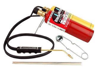

Hey guys, I was wondering if you can do light use welding of like steel and aluminum with these hand held butane torches. They say they can get up to and over 2000*F
Like these little things;
Most likely not. Temperature isn't everything, you also need to consider the energy the torch is able to put out. If it doesn't put out enough energy, the material you're welding will dissipate so much heat that the torch is unable to heat it enough. Look for something a little heavier😉

Ya. It can't even weld your fingers, and skin is really weak stuff when it comes to comparisons with metal. 😉 Seriously, those POC's have less heat than a candle.

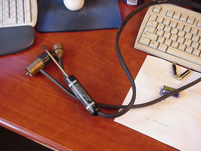

Note that with a burner like THIS, it only gets maybe orange hot (1600-1700øF) in free air, despite the prodigious amount of power output. Putting up some firebricks to hold the heat in can bring that to melt steel but the heat is too diffuse to actually weld a joint or anything.
So. For one you need a temperature higher than the melting point of around 3,000°F. Acetylene and pure oxygen burns upwards of 5,000 degrees, it's very hot stuff. Plasma in the form of a high-current arc has even more, the low end being around 10,000°F. Put 100 amps at about 20V into a space that small and you'll melt anything. 😀

mine is older but you can braze weld with it and more cost me $100. i have had it for 5 year's now it's worth the money😉

To join aluminium you can use a torch like that for fusion welding. Technoweld have some little kits for that purpose, that comes with a good beginners manual.

You need something oxy. Oxy-MAPP can weld, I believe. O/A obviously can. Oxy-propane can't (it gets hot enough, but I've never heard anyone say they have done it effectively). Any gas and air cannot weld, such as the torch on the page you linked. Solders quite well though.
Which reminds me, you can solder with these torches, and braze (at least with a large one). Is there any reason why you can't use that instead? You can get fluxes for stainless, relatively strong silver-bearing solders, and the heat won't discolor it. Brazing uses lower temperatures than welding while providing nearly the same strength, and you can get a color match.
