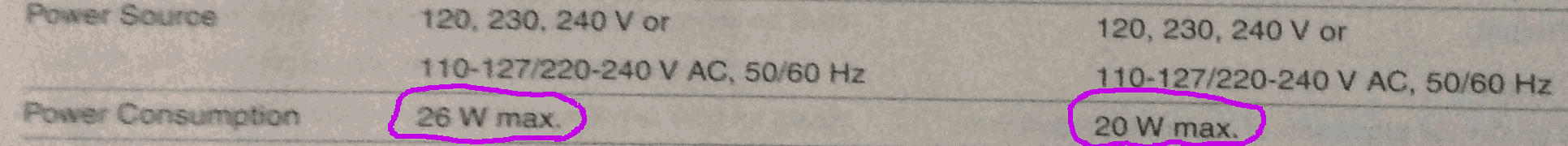

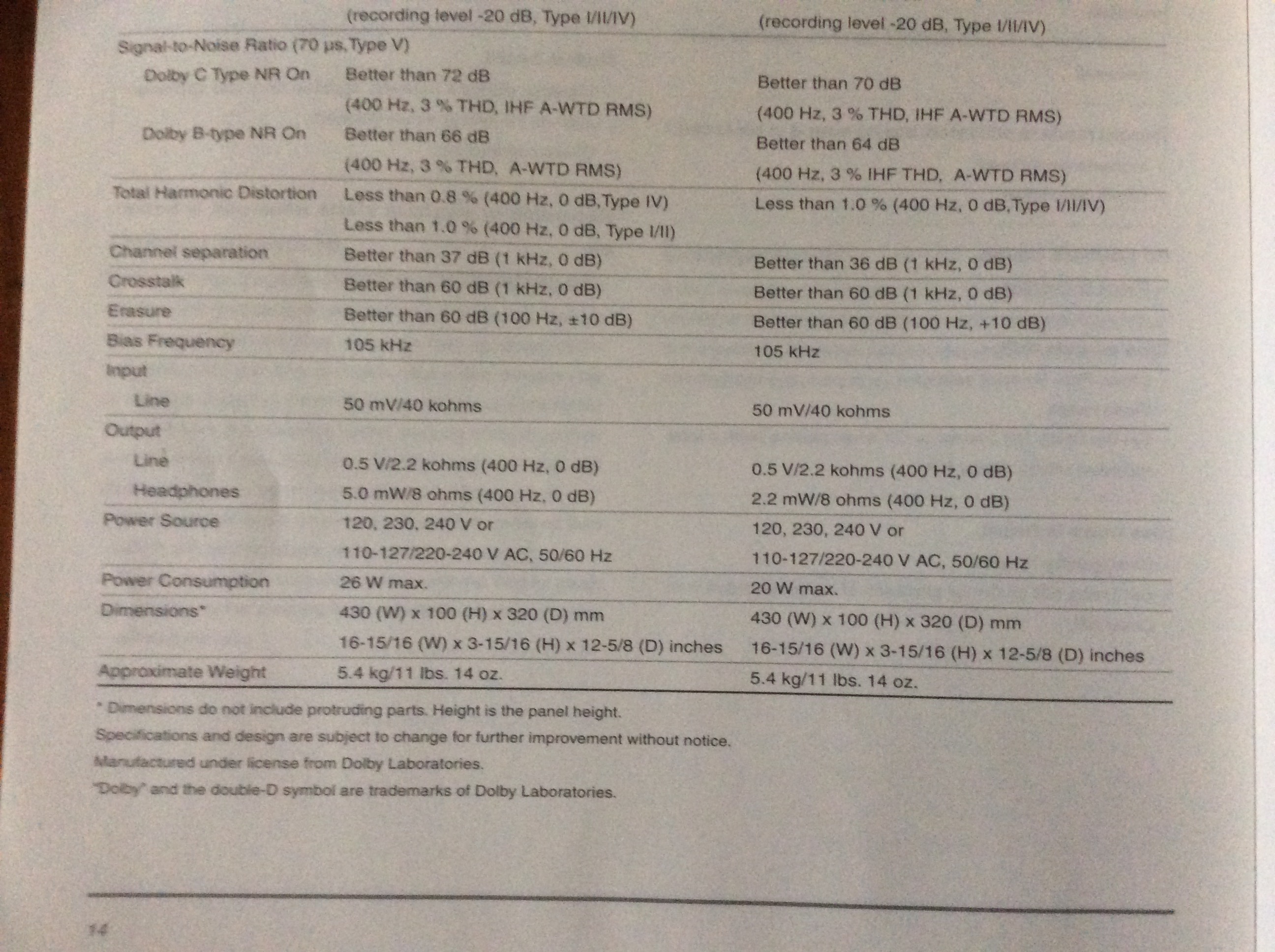

Thank you! It's listed right in the owner's manual, but I hadn't thought of that.

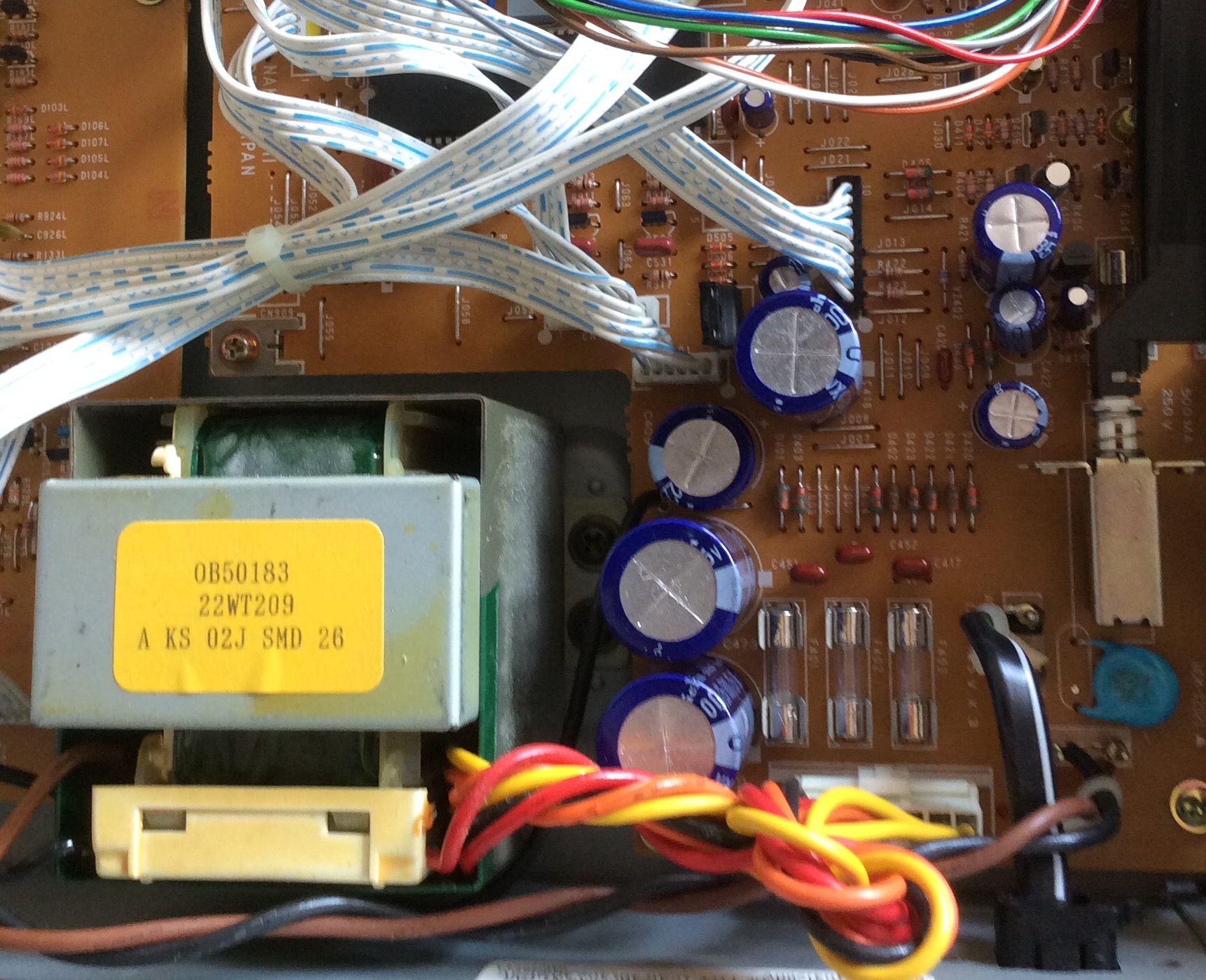

I have ended up bringing my c.1998 Nakamichi DR-10 back to the UK, but before I plug it in, does anyone know for sure that it can take 220v? On the back, it says Voltage: AC 120V, though as noted, the owner's manual indicates this deck runs on either 120 or 220V. I attach a photo of the power supply section in case it helps, hoping the fuses would protect it, at worst.

There are versions for 120V and 240V, I don't believe you can just plug it in. Since this is the north american version and there is no evidence of a voltage change over switch or reconfigurable jumpers I think you will need to use a step down transformer.
Plug it directly in and you'll probably regret it.

It sounds as if you can tell from the photo that this deck can't take 240V, am I right? I had hoped the owners manual page shown above indicated otherwise, but may end up going with a 12V PSU and sine wave inverter to run it here.

Yeah, I don't see evidence of multi-voltage primary and the provisions to switch it.
Also all you need is a step down transformer for this deck. You don't need a sine wave inverter to run it, it's not frequency sensitive.
