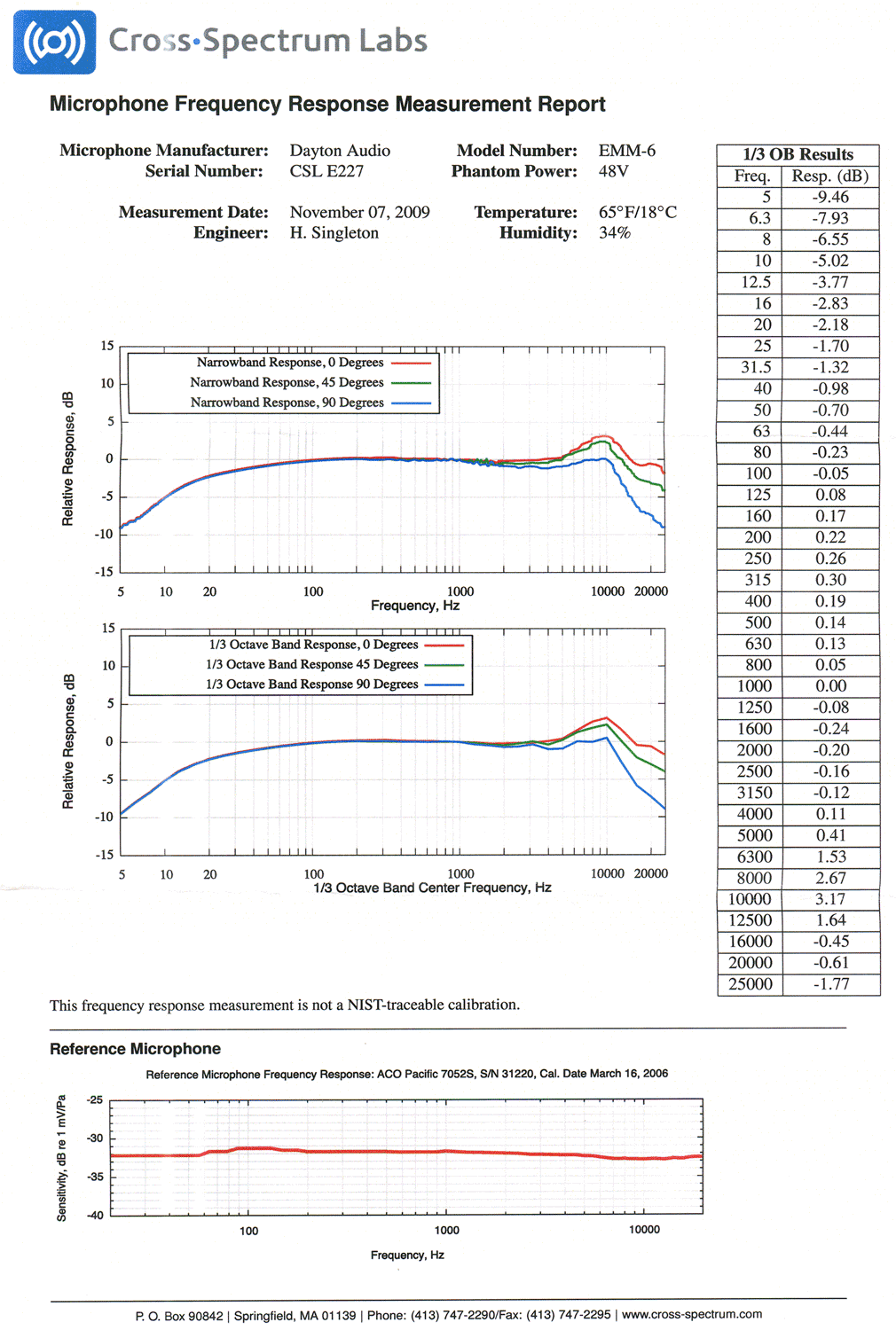

I have a dumb question. If the measurement mic is omnidirectional and calibrated, how does the method take into account the ears are not omnidirectional, but much most sensitive front-left/right, not straight front nor straight to one side. This phenomenon is of course critical to stereo sound perception. Thanks.Calibration has become overrated. It's nice to have but you can still achieve the correct result on the crossover proper regardless of calibration.
It's the USB interface. You shouldn't have to worry about acoustic centres and phase correctness, which you do with USB mics.
The crossover will still be correct even if the microphone varies all over the spectrum. The errors will be the same for all the measurements on all the drivers, so all that happens is your global voicing will be the opposite of the microphone response but the relative crossover contributions won't be affected.Interesting, but outside 100-10khz is where practiced ears cannot calibrate sound pressure levels so require help most. First-order XO regions can go ouside that range. Cab LF tuning and HF directivity measurements?
Polar plots (directivity information) will also still be intact.
All these matters form a complex part of speaker design in general. The microphone shouldn't get involved in this process, and it doesn't. The fact that it is omnidirectional is irrelevant if sound isn't coming from anywhere but the speaker itself during a measurement, which it shouldn't for crossover type measurements.I have a dumb question. If the measurement mic is omnidirectional and calibrated, how does the method take into account the ears are not omnidirectional, but much most sensitive front-left/right, not straight front nor straight to one side. This phenomenon is of course critical to stereo sound perception. Thanks.

No, they sell the calibrated mic directly. Their cal files are for both 0deg and 90deg. $110 plus shipping.
https://cross-spectrum.com/measurement/calibrated_umik.html

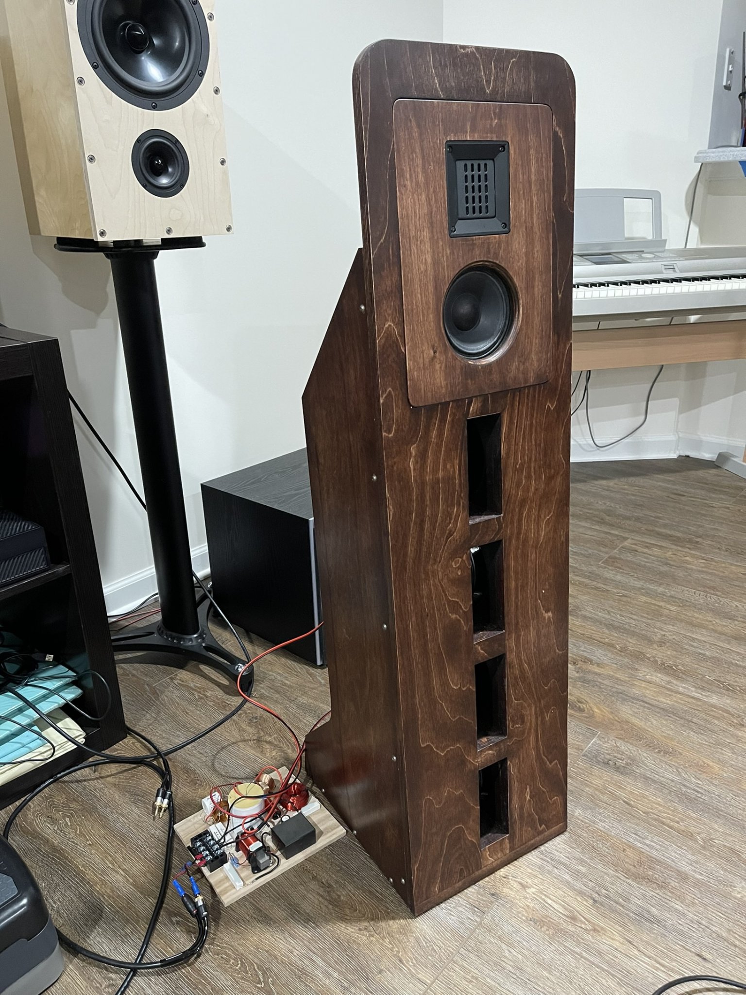

Is it common practice to build a speaker and instead of just building a crossover, just use a DSP to make it an active crossover temporarily basically until you are happy with the real world results and then build a crossover?
Very best,
Very best,
It’s a way to do it so you can listen to different topologies and settings. I used to use DSP crossovers but prefer passive ones now as it allows transportability between different amps and I don’t need 4 Chan of the same amp.
What I do is have a complete set of all common crossover component values and Wago connectors. I wire up the temp crossover in 15 min and listen.
It’s actually faster than setting and tweaking DSP filters if you can believe that. DSP may be easier to tweak but I find that a lot more measurement of the adjustments are needed.
