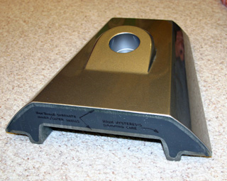

Picture of the composite panel construction:
It is simply a fiberglass epoxy skin on both sides with a high dampening epoxy foam core.
Speaker bases can be made with sand or lead shot filled epoxy to create high mass bases for the speaker cabinet.
Getting the right foam consistency will be the biggest trick for optimum stiffness and dampening.

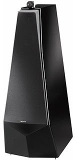

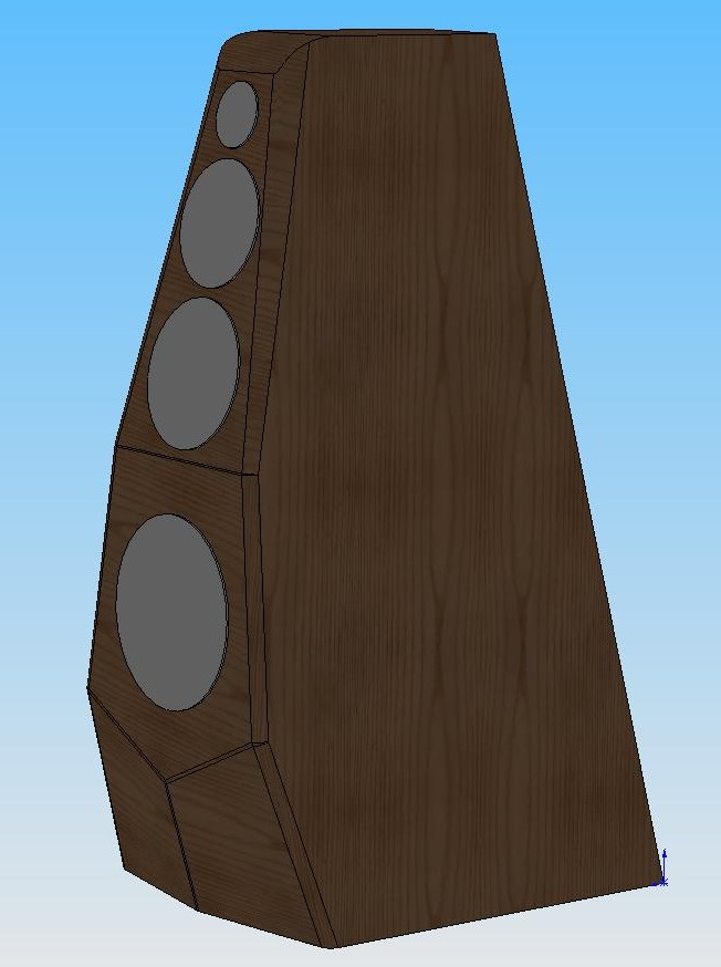

I am in the process of designing and building a 3 way 4 driver system based on this speaker shape with drivers that I have had laying around for some time begging to be used. The speaker is a Sony ES SS m9. Perhaps the best budget high end speaker ever made. If I make a MDF cabinet it will look similar to the picture without the supertweeter. The epoxy composite cabinet I have in mind has a few changes for better diffraction characteristics around the top front edge.
