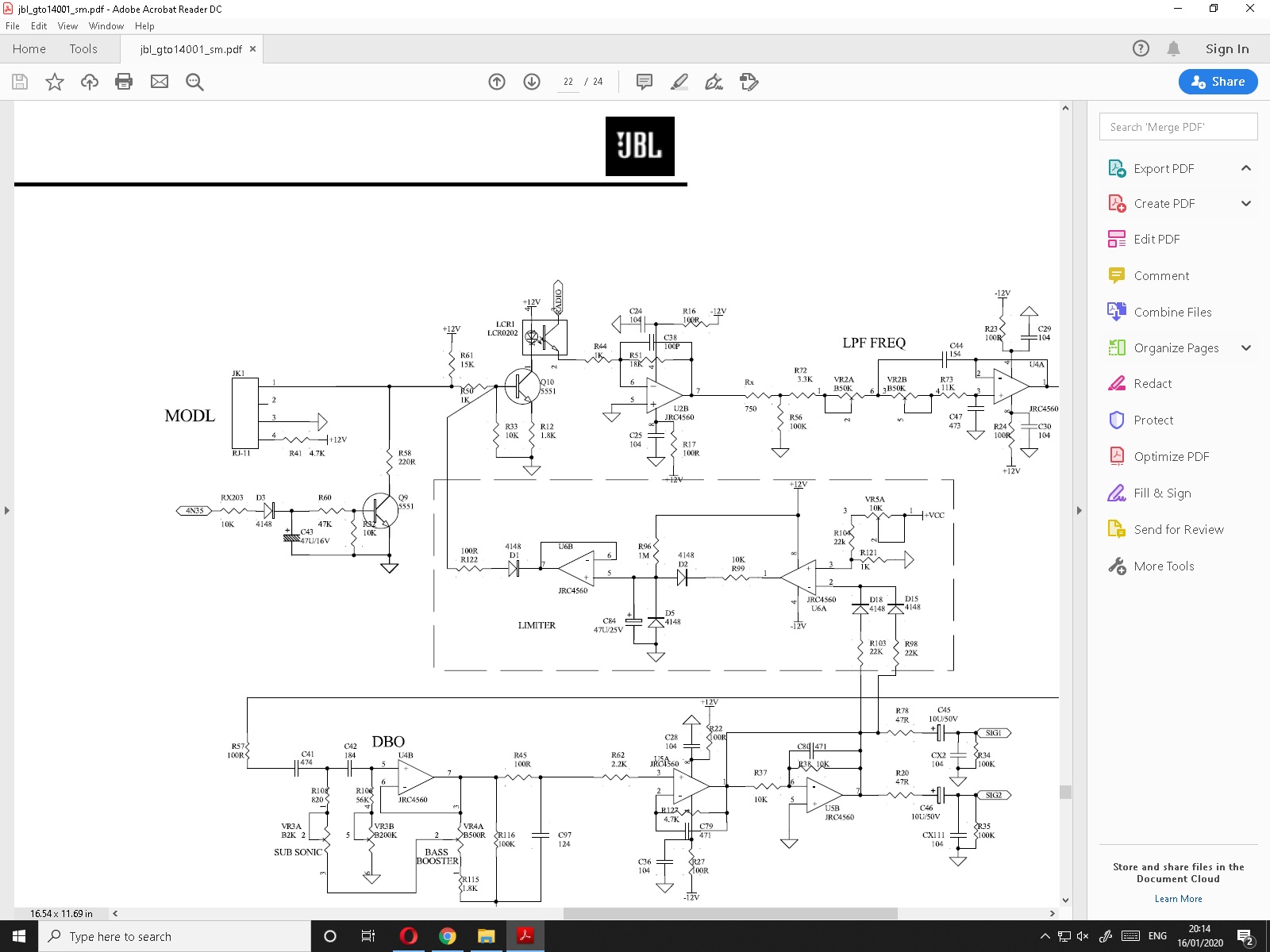

By bridging, and please bear with me, you mean simply soldering a wire between them and installing back in the car?
Yes.

I neglected to make any reference measurements before taking it out of the car and thought it would be easiest to compare in the car and to see if the same amount of gain gave the same amount of output from the sub.
Do I drive a signal into it, measure the voltage at the speaker terminals then install the bridge wire and do the same again looking for an increased voltage?

The difference seems significant, with the jumper installed the output is 36V and without it's 30V.
Just to be clear, the input shields read infinite resistance both to ground and to each other.#
So if I have understood once more, installing that bridge defeats the remote bass knob circuit and I have my answer, being that if I do buy a bass knob I can turn the gain up a bit and probably get the headroom I wanted?
I see, so in other words without replacing it there is no way to know definitively?
Would leaving the jumper in long term cause any harm?
I think I'll order a bass knob anyway but could test it in the car in the meanwhile if not.
