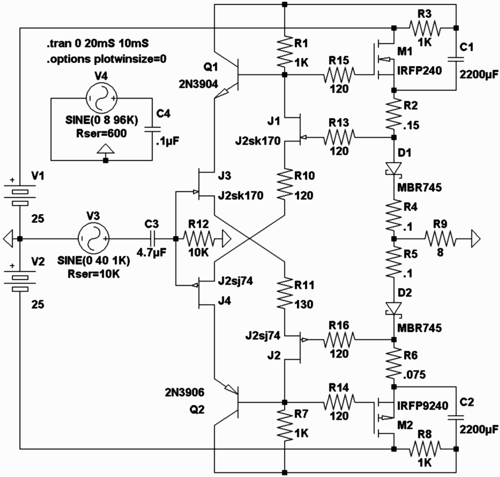

Another screwy idea: Did not exactly improve the thing I was
shooting to fix. (Drive bandwidth can't make 20KHz rail to rail),
but still might be of lame slackademic interessence or whatnot...
I'm still working on the original problem.
JFETs didn't work better than bipolars as comparators. But in
this case, matched sums (from matched pairs) make voltage
spanned across the input buffers equal. Toshiba 2sk389/2sk
109 matched pairs. I abuse the models for 2sk170/2sj74 as
JFET singles. It seemed plausible...
Equal, but not necessarily right. Got to jigger with resistors
to equalize thresholds at the MOSFET gates. Inequality is
almost assured. And mind you, the thresholds of the JFET
comparators have to be significantly less than thresholds
of the MOSFETs to be controlled.
Whatever else, the input impedance increase seems useful.
