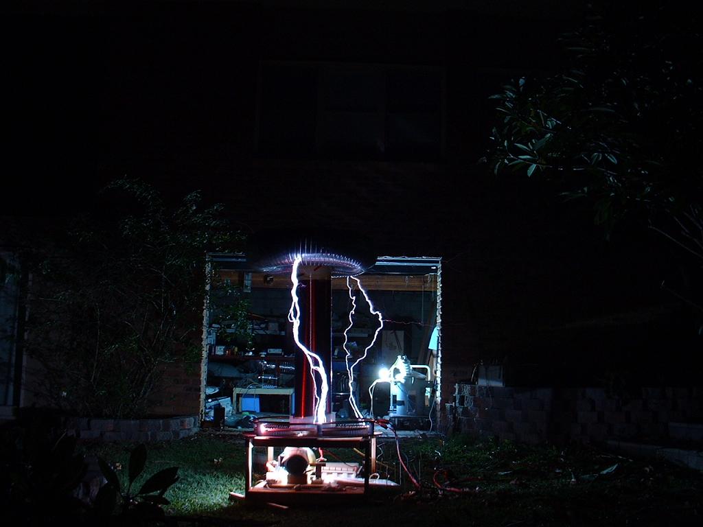

Firstly a pic from a previous hobby, and yes that is a 10kVA 11kV pole transformer in the background.... I made this when I was 15, and without the help of the internet, so I am capable of learning and doing things safely under adequate instruction.
I posted this circuit as a conceptual idea, and yes I did not consider the need for isolation. It seems obvious now. I would never have built the circuit without first discussing it here with everyone and working towards a suitable and safe incarnation.
I can see now that perhaps posting an unfinished circuit was a bad idea and may mislead others. However, I would still like to try and make it work with the help of forum members, either publicly or discreetly, if you are willing.
