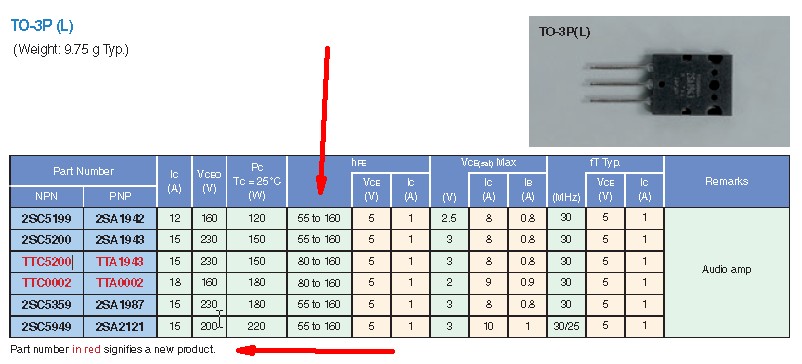

I think this are TTC5200 they do not have marking in their datasheet.
What's the difference between the TT vs 2S devices? I didn't see anything after a quick scan of the datasheet.
This version is also from Toshiba:What's the difference between the TT vs 2S devices? I didn't see anything after a quick scan of the datasheet.
http://www.rlocman.ru/i/File/dat/Toshiba/Transistors_Bipolar_BJT_Single/TTC5200.pdf
Ask by Toshiba about
http://www.semicon.toshiba.co.jp/eng/contact/index.html
what means "2S" and "TT" (perhaps "Toshiba Triplet difused")
check out also this sites:
http://www.semicon.toshiba.co.jp/eng/product_detail/transistor/bipolar/1254093_13589.html
and
http://www.semicon.toshiba.co.jp/eng/product_detail/transistor/bipolar/1253921_13589.html
These are new one from thoshiba and have better IC/VCE linearity and lower Cob than old version 2SC/2SA.These are Original
Best regards
Joshvi
Best regards
Joshvi
Stormsonic,
2SC5200/2SA1943 are classified in to two hfe groups R (hfe 55-110) and O( hfe (80-160).But TTC5200/TTA1943 have no hfe classification and thus character indicator is not printed on packing . Hfe varies from 80 to 160.

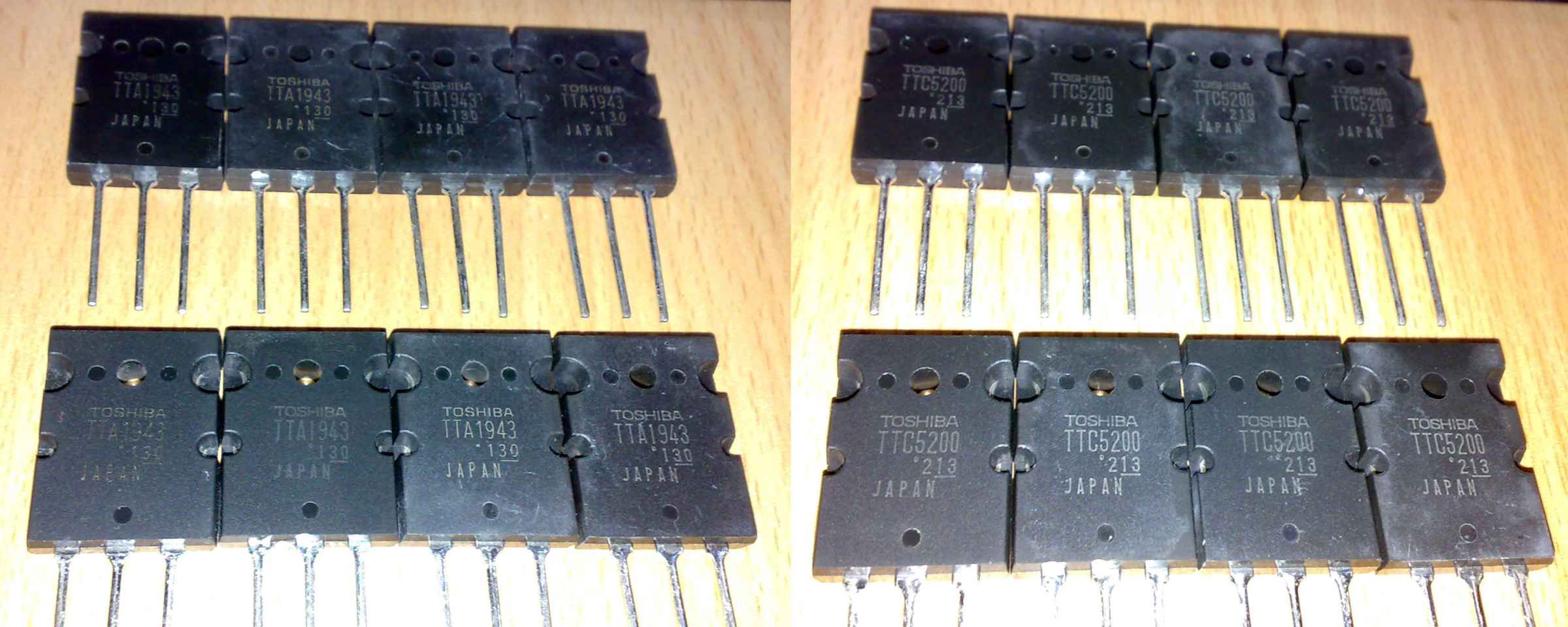

2SC5200 & 2SA1943
Regarding the 2SC5200 & 2SA1943
To be honest the transistors in the image look real however it is hard to know. I have been looking into these transistors of late and there are lots of fakes available on the likes of eBay and Alibaba. In my experience on the fake devices the underscore line below the batch code covers all three marking where on the real devices it only covers 2 markings.
Also the JAPAN marking is a little more scrunched together on the fakes. (Note this will always change on the fakes as the counterfeiters are very crafty )
The fakes have iron inside them and a magnet sticks quite strongly to them where as the Toshiba devices are made out of a solid copper construction. (Iron? Yes Iron it's cheaper than copper however it is a much poorer coductor of heat)
I have also seen fakes with nearly the correct size silicone dies however; they still do not work properly especially under load and they are unreliable.
This is a genuine Toshiba device from Mouser 🙂
This one is a fake from some clown on eBay UK claiming to be genuine parts😛
One other thing the fake 2SC5200 and 2SA1943 have the same batch numbers. I am not sure about Toshiba batch numbers however on the real ones I have only ever seen them with at least one digit difference and never the same. I hope this is of help.. Regards John
