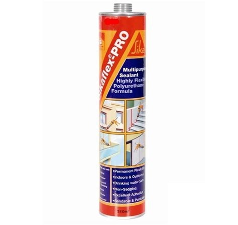

Use a more common polyurethane adhesive. Eg this, or even something similar that doesn't set as soft will do well.

Why would the designer go to the expense of using an expensive product when a cheap polyurethane would do the job?
He was able to demonstrate resonance using an oscilloscope.
He indicated the poly layer needed to be thin (1mm or 2mm) for it to work.
Has anyone tested the common polyurethane adhesive?

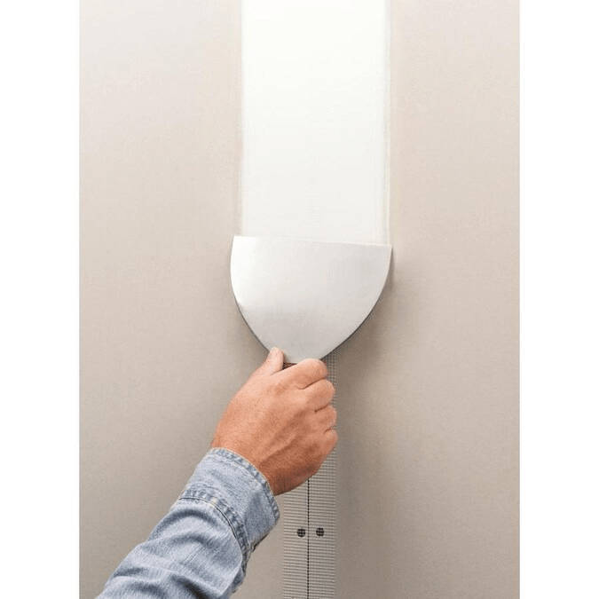

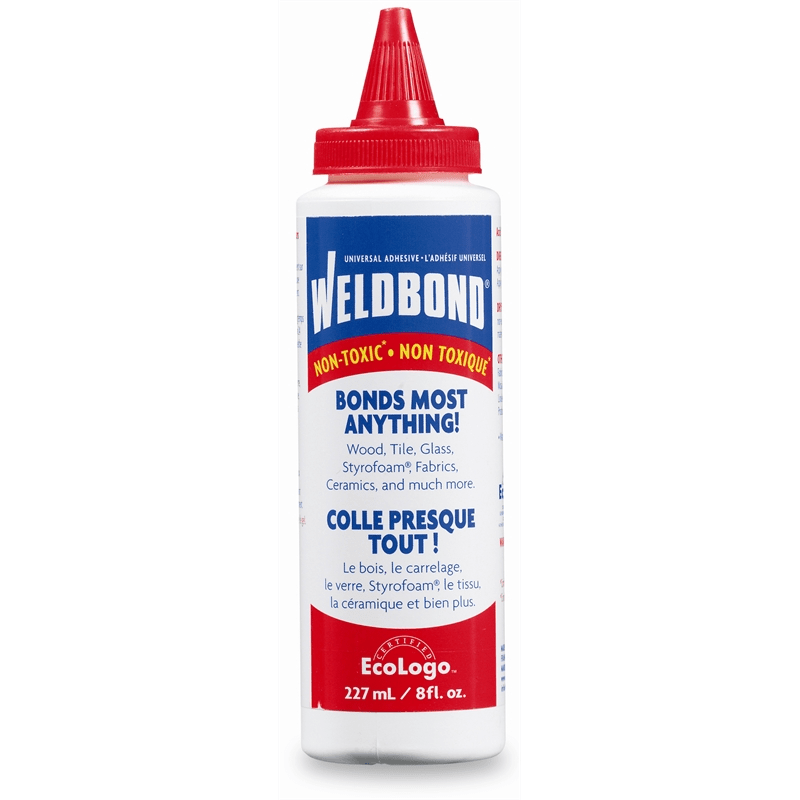

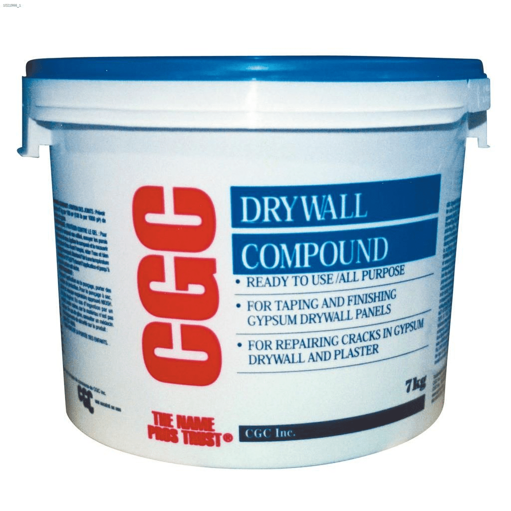

What I used for "Glop".
50/50 mixture of, Ready To Use (Premixed) drywall compound (texture like thick a milkshake or thick cake batter for mudding & taping) and Weld Bond white Glue
