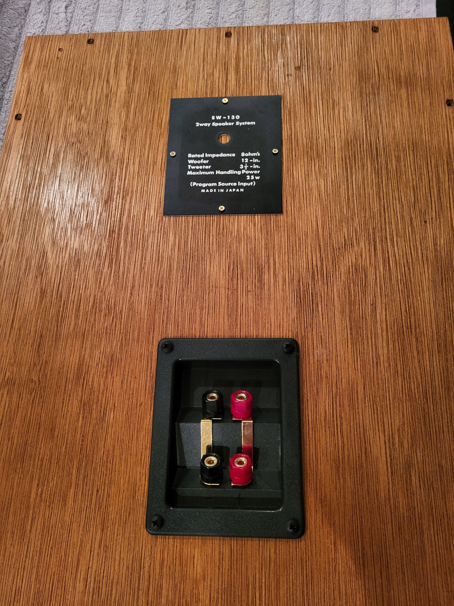

This is the back panel, sanded and with a thin coat of lacquer.
The original input was 1/4 jack only. The bi-amp plate more that covered the cut out, so that was the choice with little routing. I kept the original nameplate just because it is cool vintage and says Made In Japan.

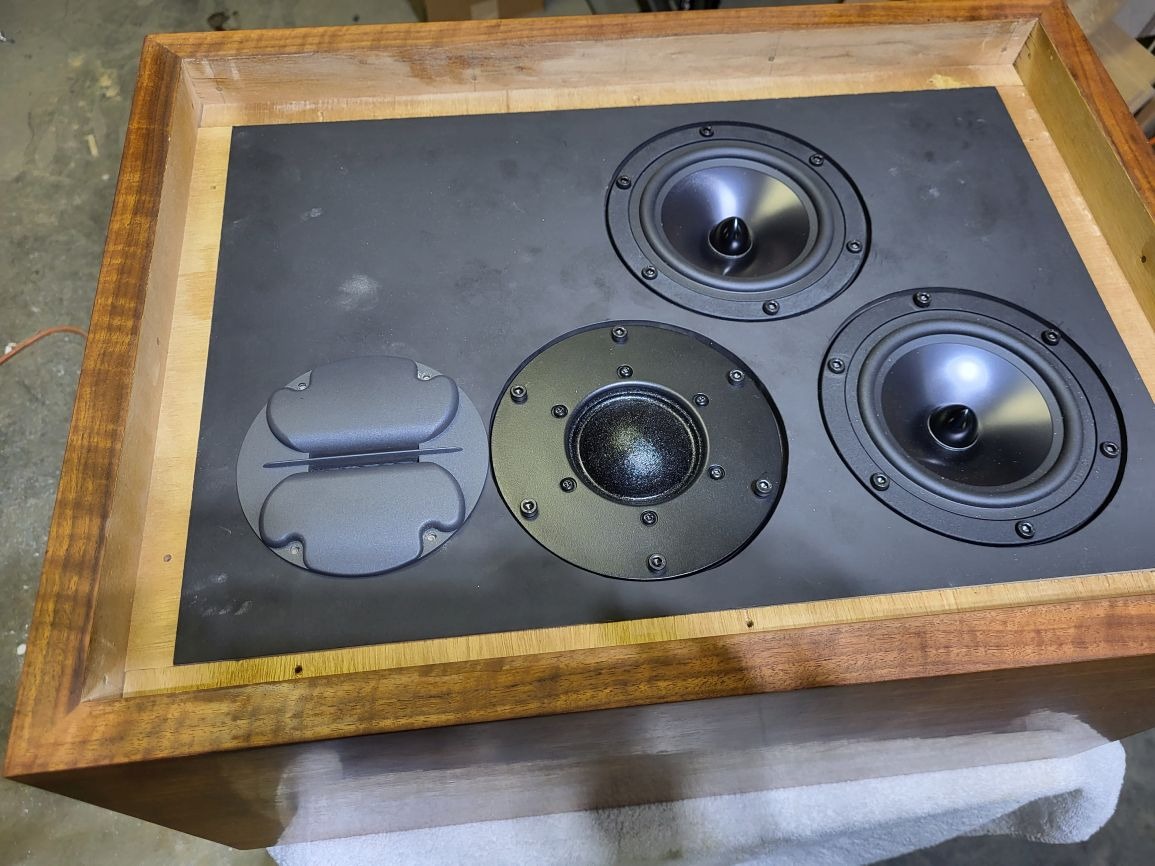

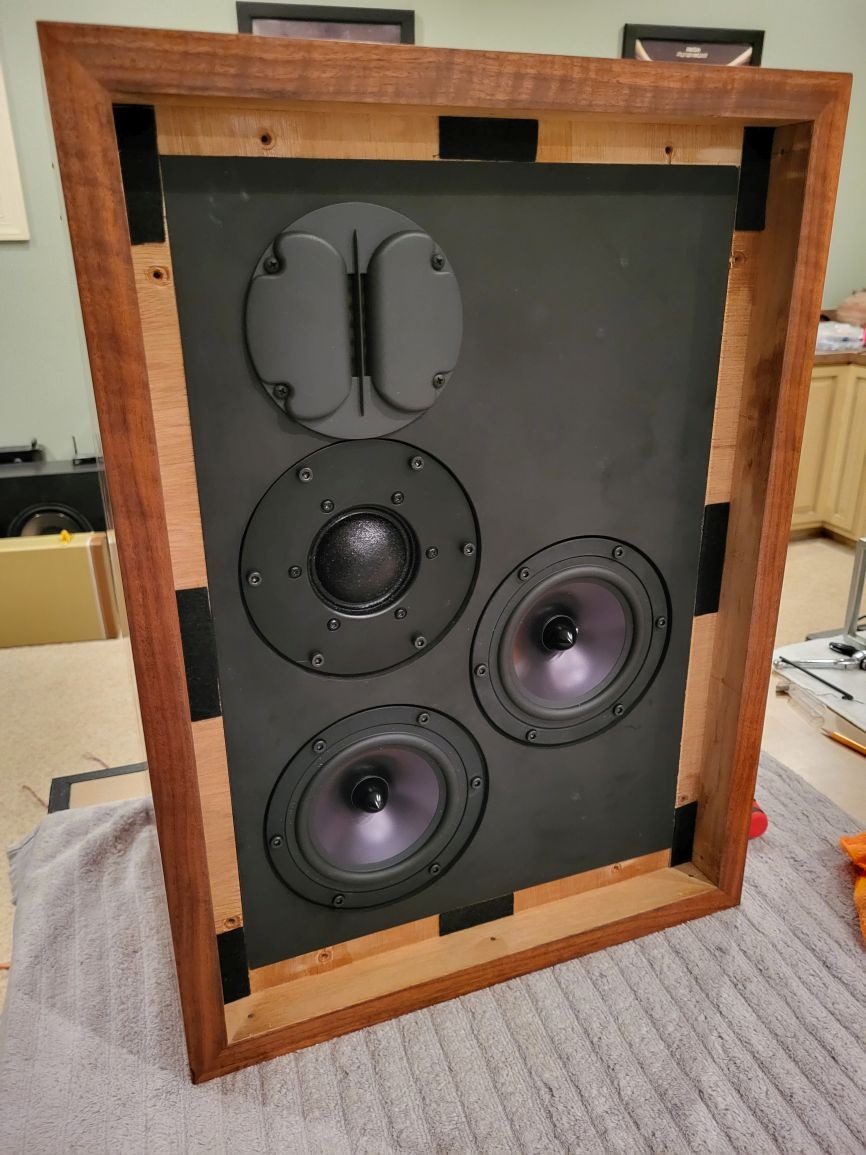

Front view of the dry fit.
The black is a primer and dust fingerprints cling to it. Wipes clean with microfiber.

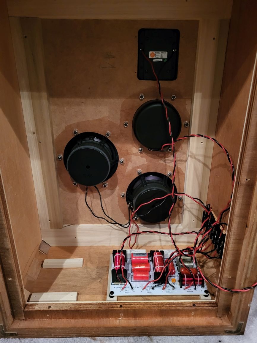

The dry fit from inside. Not a lot of spare room in there. Glad I detailed all that pileup in CAD so there were no unpleasant surprises.
Woofers and mids are thru bolt with washer and nut. These nuts are removable. The real installation ill be nylock nuts. I have two platform rails for the two crossover(s) I will be using. They are premade, and I will start out there. I have specs for one of them and have modeled to the best of my ability. The other is a better quality (???) but I cannot find any definitive information on it. The big question is what this tiny baffle will do with the mid-lower frequencies. The model says I will have a 5 to 6 dB hump there. Maybe this mount will attenuate that. No way to know, so I will be trying some basic SPL tests as soon as I get the first one complete.

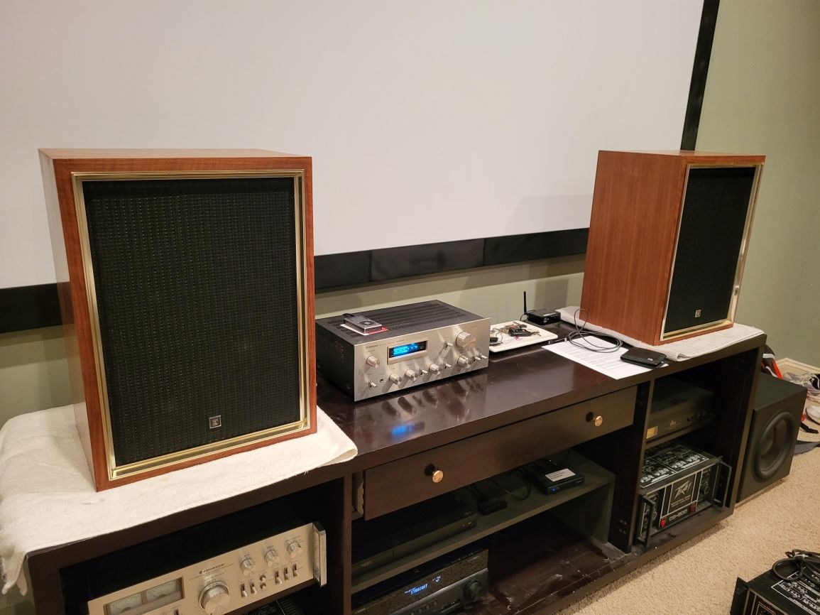

I got these finished around Thanksgiving.
I had been running these on a Kenwood KA9100 all along. Sounded great. Adding subs to the Kenwood was going to be tricky, so I integrated with my home theater receiver and its subs. The speakers sounded horrible now! I was shocked what running the digital processing did to the sound quality. Pure Direct sounded correct in level and sound quality. Anything else sucked. So, I brought down my son's Pioneer, which he would ultimately be using, and hooked it up. As far as the home theater, I turned on only the sub amplifiers. Sounded great.
These drivers were able to glaringly show the limitations of the AVR. Whoa. I would say they are sensitive and revealing. No bass to this layout, however. I think they look really cool, too.
