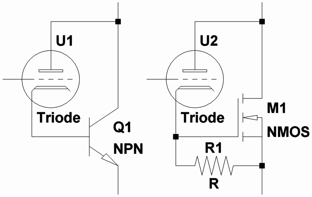

This is a big subject: And the only easy answer I know revolves
around faking the internal feedback mechanism of the Triode.
Sometimes the best way to "fake" it is with a small triode as
both the input buffer for high impedance and the reference
model for Mu.
If you were to place the base to emitter junction of a bipolar
transistor in series with your reference Triode's cathode, you
have a Triodlington. Current is multiplied roughly by Beta, but
plate voltage is still controlled almost entirely by the internal
feedback mechanism (Mu) of the tube. If plate and collector
are strapped together, the transistor becomes slave to this
feedback.
You can do the same with a MOSFET, but need to add one
resistor across the Gate to Drain.
Now, if you really wanna fake a Pentode, beam power type,
for UL or whatever... I don't know if enough voltage feedback
gets through a normal pentode's plate resistance to abuse a
small one as a feedback reference. I got a feeling that straight
up Pentodlington based on a Pentode wouldn't work..
Might just maybe could fake your way there with a Cascode
of two Triodlington type emulators???

Where in either of these circuits is there an increase in Miller?
There is definately a huge increase in transconductance. And
if transconductance is the limiting factor, thermals will make
a big difference. But if Mu is the limiting factor...
Matters little the thermals or linearity of either BJT or MOSFET.
The tube is watching the voltage of both parallel anodes, and
applying the rule of Mu. Neither type of sand likely to run away
or be non-linear when locked down by 1/(Mu-1).
The Pentode model would be a cascode of Triodlings, possibly
with different mu needed for screen and G1. That requirement
alone might make the circuit impractical...

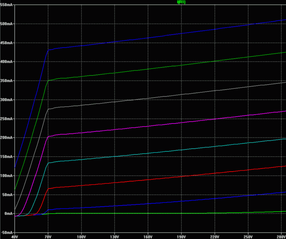

I retract suggesting cascode of triodlingtons as a pentode model.
While I can get it to "work", don't much resemble the curve I had
intended to model. The complexity involved isn't saving any time,
space, or money...
This was 6DJ8's with MJE340 boosting the lower cathode, and
ST8NM60 with 4K7 in parallel with the gate boosting the upper.
The upper grid "fake screen" voltage was held at 70V...
I can't find a way to make this any better, so I'm throwing in...
To be specific, I can't seem to round the knees realistically...

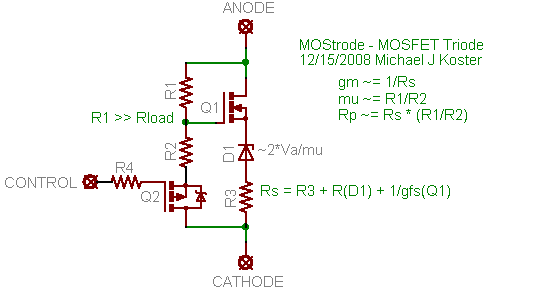

Here's a concept for MOSFET based triode emulation that I've been
thinking about. I've omitted any cascoded devices and G-S diodes
for clarity. It's the same basic O.H. Schade local feedback idea but in
an internal loop isolated from the input terminal.
