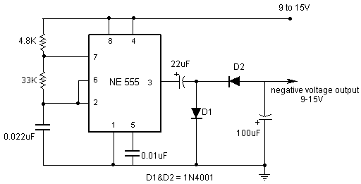

This will work -- and you don't need two transformers -- you can use your Linear LT3080 instead of an LM317 if you prefer.
jackinnj said:This will work -- and you don't need two transformers -- you can use your Linear LT3080 instead of an LM317 if you prefer.
Interesting. The Bandwidth is 48Khz only?
I tried a look on National for the OPA5xx series. The OPA541 do not have a nice Package. Do you have another model to advice?

I haven't checked the BW vis a vis the LT3080 or the LM317 -- the open loop gain of the OPA541 is over 1 MHz.
The opamp shown is a Texas Instruments part -- formerly Burr Brown -- there are several in this family -- high power opamps.
