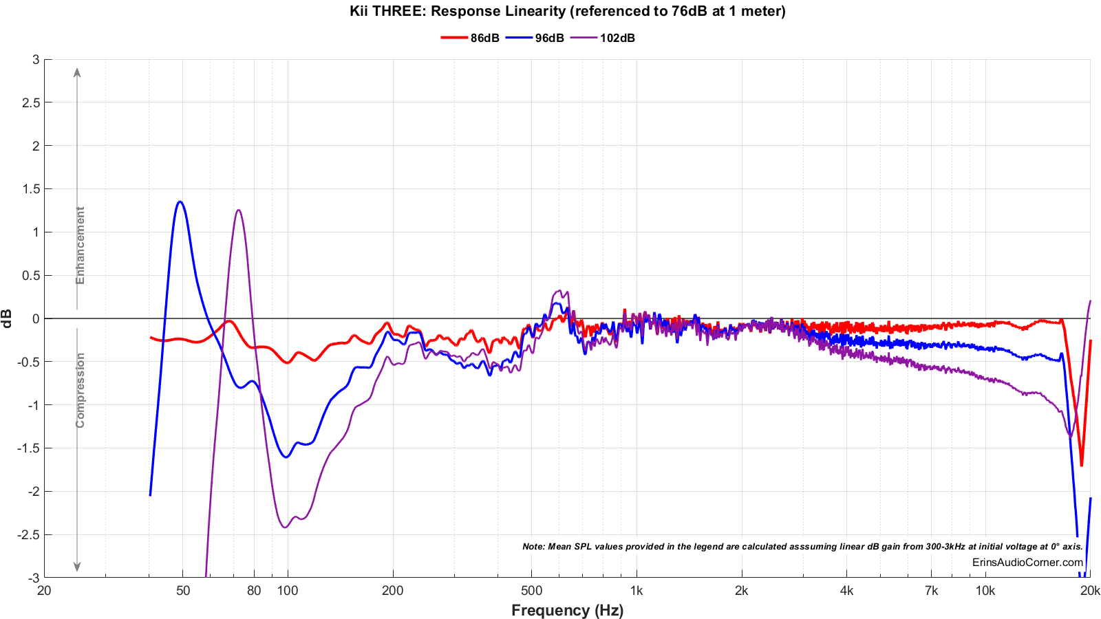

Wow thanks for all the replies!
Mattstat is right, it seems to happen on closed systems and even active ones, I had never paid enough attention.
Kii Three:
In this case, I think Planet10 must be right about the parameters of the driver changing at high levels. Presumably the impedance drops at those frequency response peaks when driven hard??

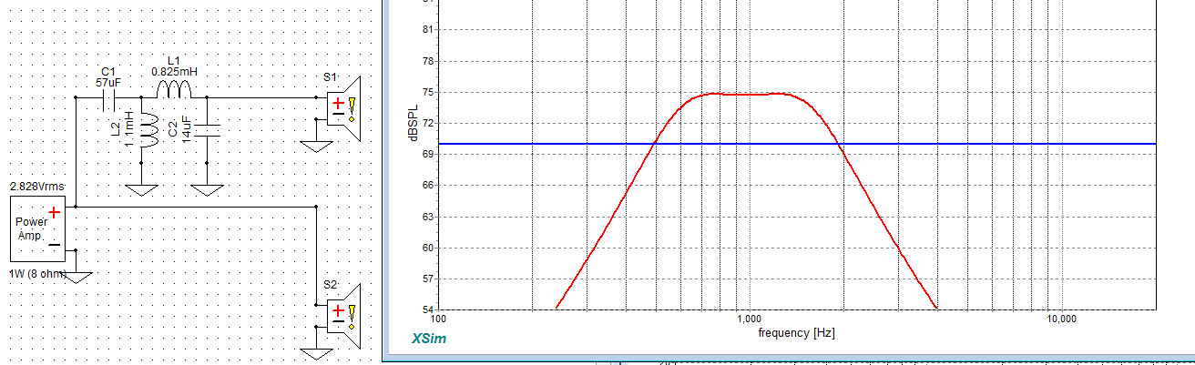

AllenB, I think what you see with those crossover parts is not an increase in efficiency like I was guessing happened in the port, but rather a reduction in impedance and is not level dependant. Using a voltage source amplifier the power draw will increase as the impedance decreases, so not really getting anything 'extra'.
Then again, what is happening at 2KHz here? Impedance of the crossover drops as the coil core saturates, or...?
Increasing distortion in that region is typical of many dome tweeters. Could be an artifact related to that. I couldn't find the crossover point listed anywhere though, so just a guess.

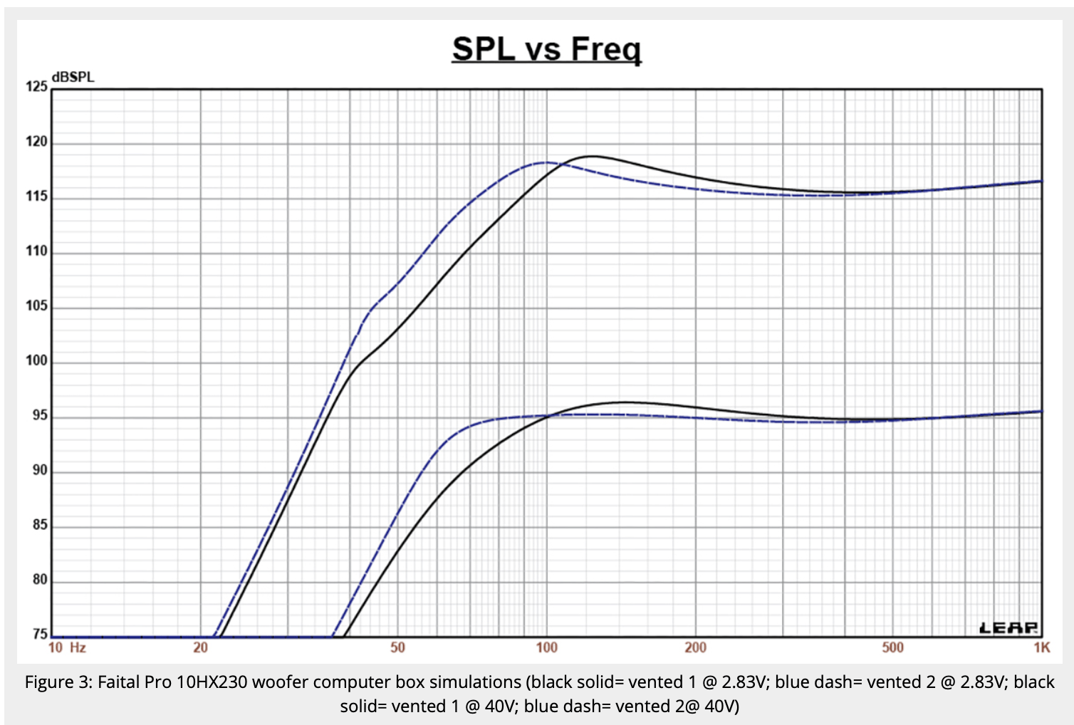

Yes, I saw these graphs in audioxpress tests.
But is it possible for example to calculate a box alignment for flat response for a woofer like with the classic T/S parameters just for specific driving power?
Anyway, according to the audioxpress tests and graphs, the tendency is roughly looks like (to me) the Qts is increasing and the Fs is decreasing with more driving power. At least in the case of 2.83 V vs 40 V.
What's happening is thermal power compression due to rapid (exponential) heat rise with increasing power/time, which HR can do up to 270/518 deg C/F, so yes, it's basically just increasing Qts, making the box alignment increasingly under-damped.
FWIW, the pioneers' version of what I assume you want was to preload the cab in that while a max flat alignment (by their definition) was Vb = Vas/1.44, Fb = Fs and for prosound Fb = 1.56x Fs to ensure it wouldn't exceed some value, which nowadays seems to be the VC 'blows' open before Xmech, though while still relevant for many of today's drivers being little more than higher power handling versions of them, this may be moot for the latest super high power VCs/Xmax 'monsters' where it might be best to just add (build in?) thermistors to protect them.
