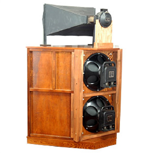

And that makes me think of the Western Electric retro vintage.😀
They are lovely OB. Links to picture below.
retro vintage modern hi-fi: September 2009
retro vintage modern hi-fi: Western Electric
Of course it has nothing to do with the title of the thread. But they are nice and make me think of the simplicity (or not, maybe they were the Rolls-Royce of the time) involved.
