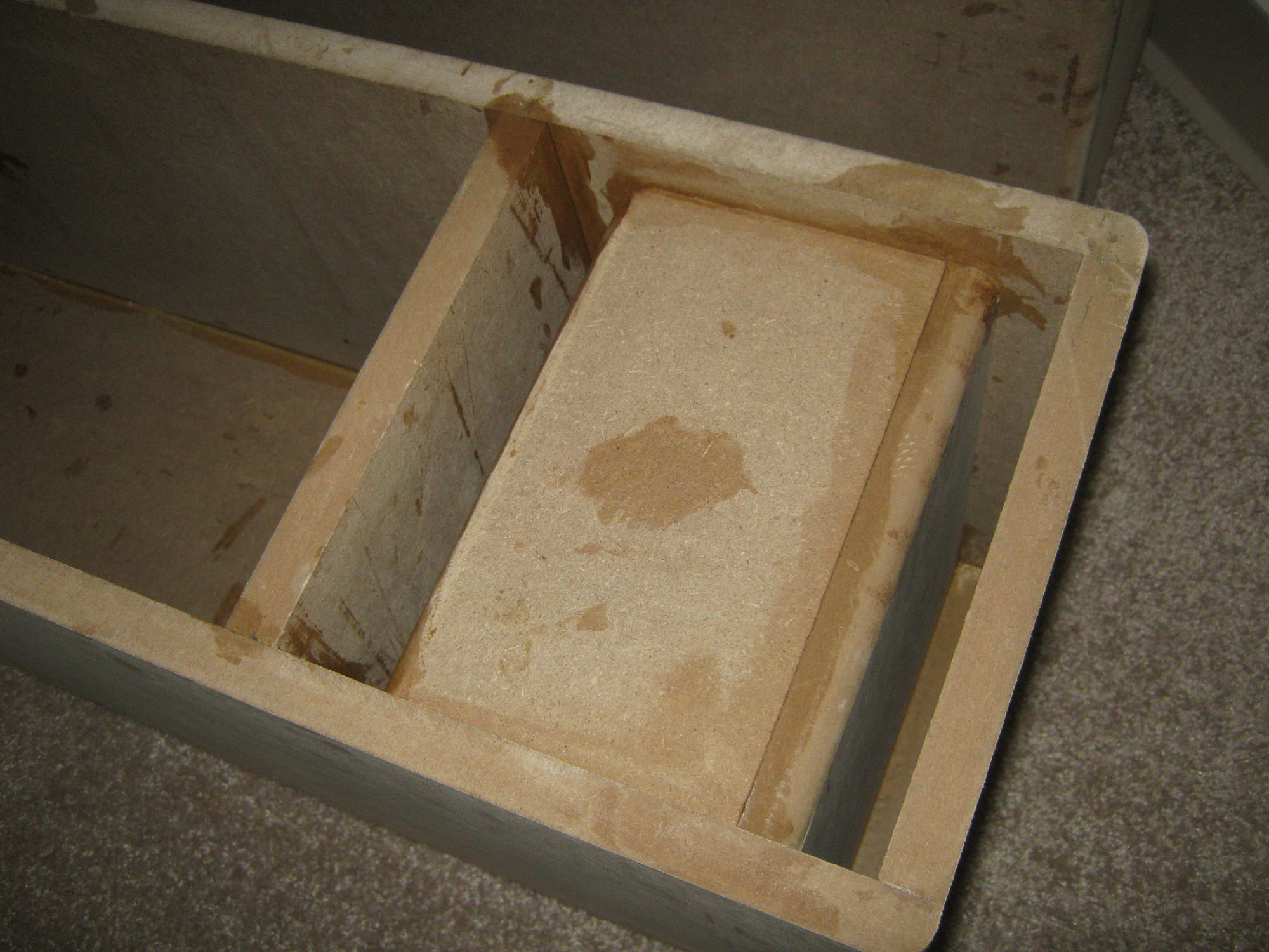

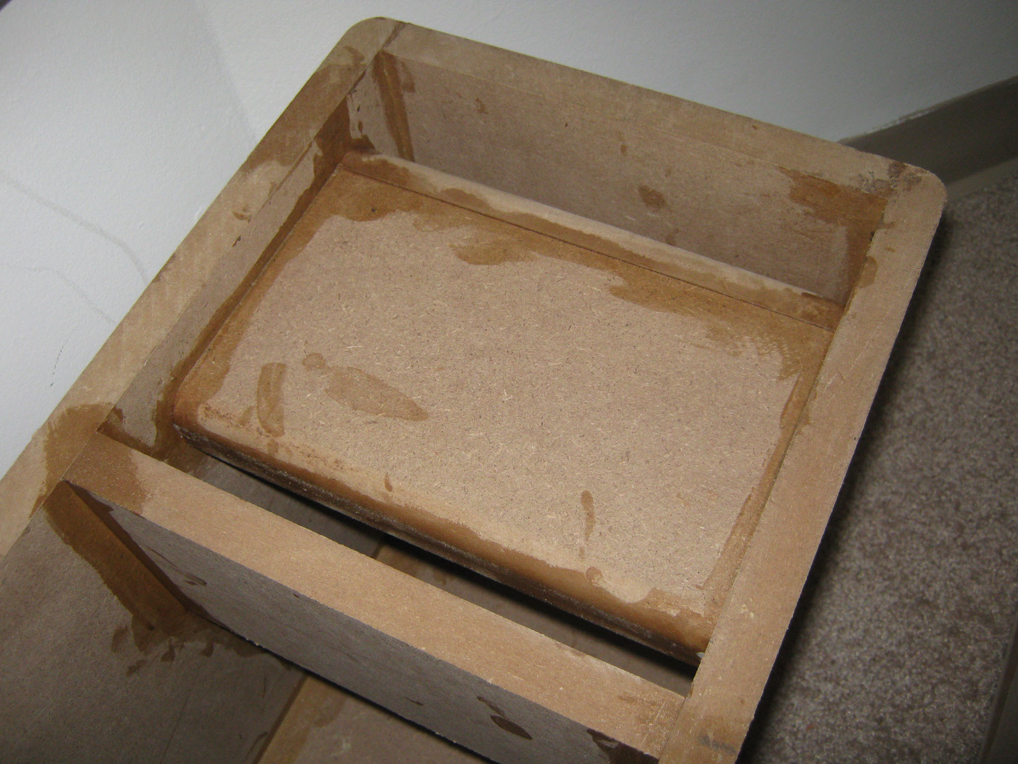

Yeah, I'm asking about the inside. The outside I will route with the 3/4" bit where I can.
I'm using ScanSpeak 21W/8555-01 per 1.70 cu. ft. enclosure with a 1 x 8.5 x 19.5" port with .3 lbs/cu.ft. polyfill. I don't plan to play them very loud, but it would be just dandy if they could without port noise.

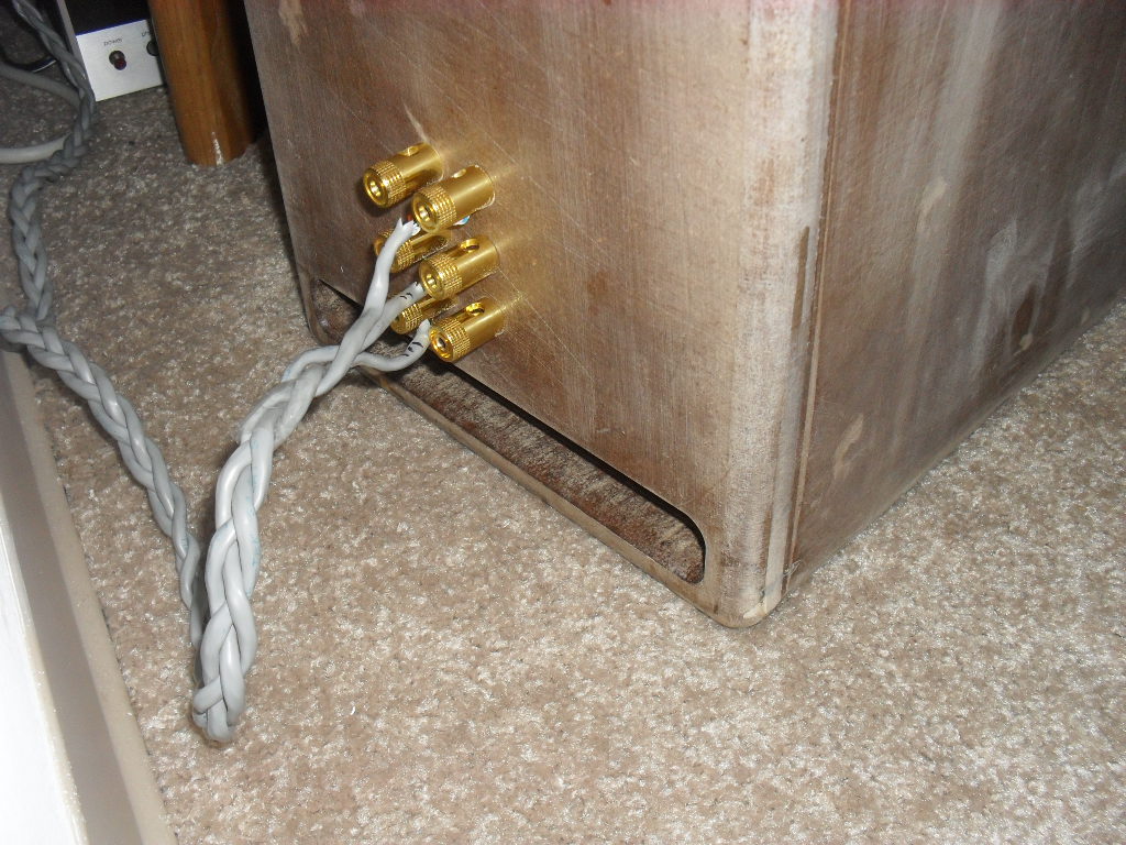

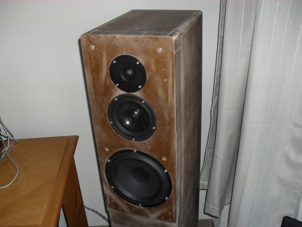

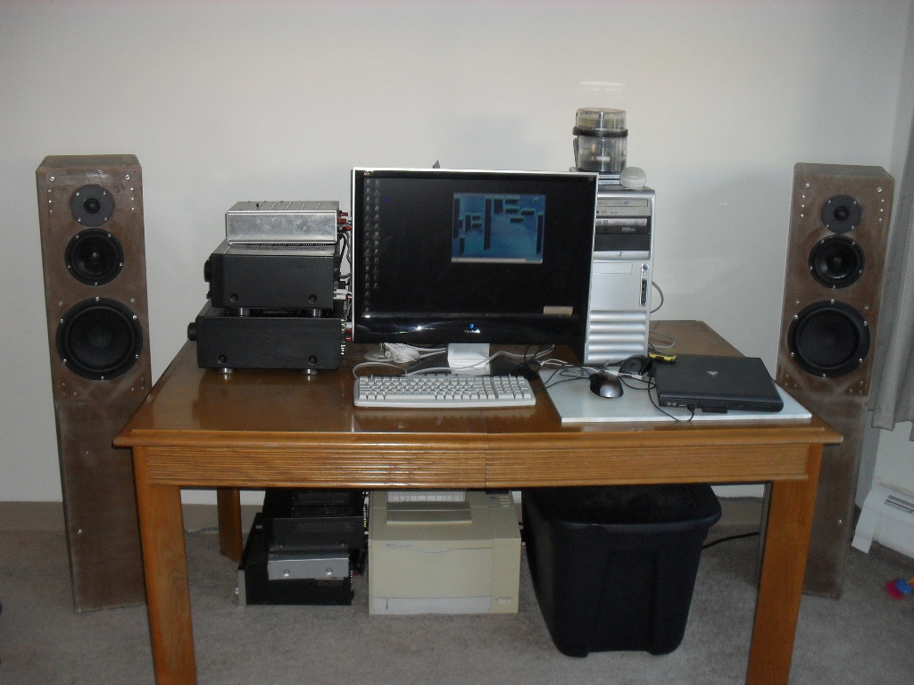

I must say that this project really makes me realize I'm not much of an audiophile. I think the ported is tuned low and the bass enclosure has a fair amount of polyfill. I will post pics now although I am somewhat embarrassed of my routing work. I didn't have the best router or bits or circle cutting jig, but I could have done better if I didn't have to drive 2 hours to my sister in-law's house to router my speaker. The grills fabric might have to be redone; you can see the staples through it because I had to make childproof grills.

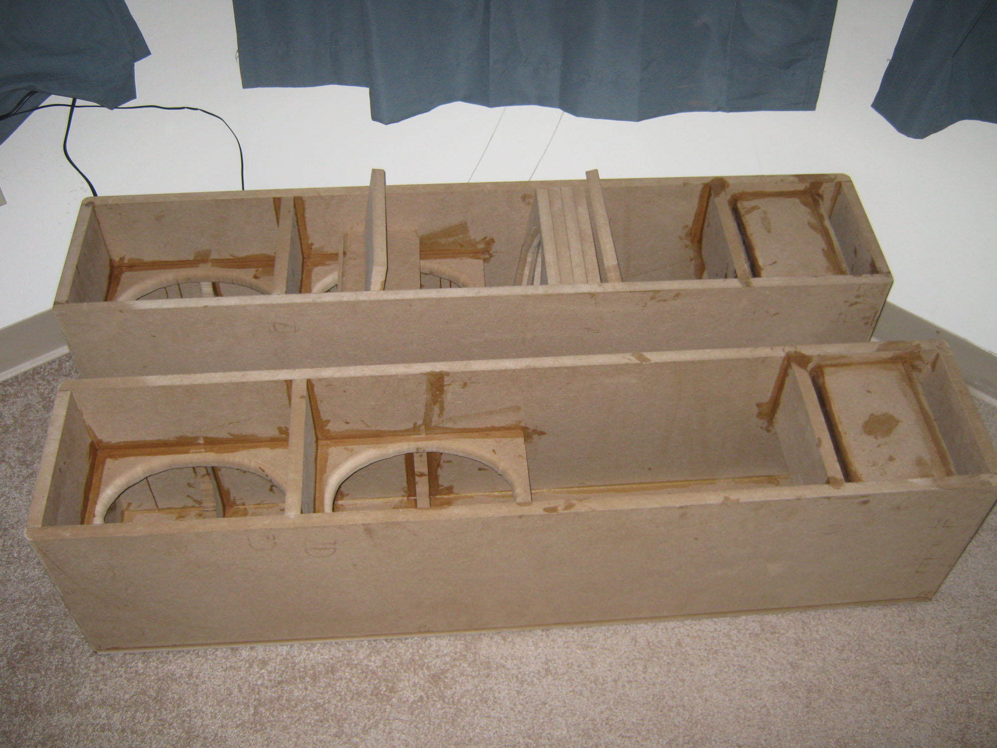

The thing that has bothered me most about TL systems is the time delay of the line output which, when I began noticing it, started to annoy me. Also, without sufficient care to damp higher frequencies from the delay line output, it can easily interfere with imaging.
I don't 'like' BR bass either, but I ultimately decided to use it in an overdamped configuration where the port tuning was no higher than 32hz with the response 6db or so down at that frequency. In this case, the group delay at 40 hz or above is significantly less than a conventional BR tuning at that frequency and there is the advantage of an additional third to half octave extension. I can augment the response down to 40 hz in this case by using special xover techniques that, incidentally, tend to flatten the upper BR resonant peak. So, overall, I feel this approaches closed box response and transient characteristics down to F3 but with the advantages of higher efficiency/lower distortion or smaller system size.

Will be a lot of turbulense in there Jimmy.
Ports +cabinets should be designed with that in mind. Asymetric cabinets and "trumpet"-shaped ports both in- and outside
Yes, I know At the time I was building them I only had a 1/2" round-over router bit I used inside the ports. But on the outside of the speaker, due to poor planning, I decided to only use a small portion of the 1/2" router bit to round the inside of the port over because I didn't want to impact the look of the speaker. But I could round it over a bit more without it effecting the side profile appearance of the speaker. I must have just forgotten about it somewhere along the way. The outside of the port doesn't look like it's round over, but it is a little bit.
Later on I obtained a 3/4 round-over bit, but the port panels were already glued in place. Also I should put in modelings were the port makes a turn, on the outside of the turn, but I haven't looked into finding those modeling, if they exist, yet.
