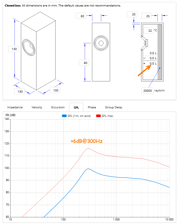

I did this today but made the sealed chamber 0.53 litre by mistake instead of the recommended 0.05 ft3 which is 1.416 litres not 0.53 litre like I have.

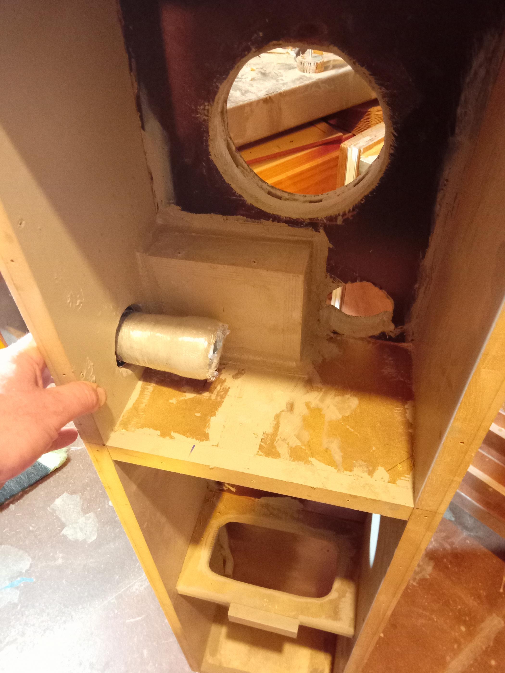

Sadly I don't have room anyway (see pic) I am crossing from my SB 6.5" woofer to the 4" mid around 600 Hz.
Would I be ok with the smaller size 0.53 litre for the 4" mid as I'm not using it for low frequencies at all?
I could modify it to 0.75 litre of that helps?

Closed Box Simulator
Looks like a good bump-up at 300Hz. In an active crossover you could shave this. With passive crossover, not so easy. A series cap gives a droop and peak shape. A 2-pole filter needs careful choice of Q.
