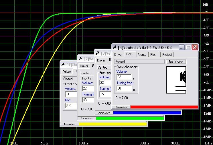

I need to design some vented enclosures for my SEAS W33 FB 13" woofers, and plugging the required data in to my software, I get a suggested box volume and port size.....
But then I came across this thing on different alignments.....
Seems there are a great number of these so called alignments, which i understand is different ratios between box volumes and port tunings.. (?) From what I understand, there are a number of benefit-drawback compromises between these.
My priority would be extended low frequency and good transient response, physical size being less important.
How do I identify the alignment best optimised to meet these criteria, and how do i make my software calculate accordingly??
Perhaps I need a different software where one can specify the desired alignment?
Any enlightenment or suggestions for further reading/ suitable (preferably free) software is much sought and welcomed! 🙂

Hi, 140L tuned to 26Hz (as given in another thread), 🙂/sreten.

Talking of ports, if i have a slopped front, is it a problem that the port would then not be perpendicular to the back of the enclosure?
Thanks for the tip regarding the software Sreten, certainly a more versatile package than the old one I had!
Still trying to get to the bottom of the different alignments though...
What's the alignment you used to get 140 L and 25 Hz tuning frequency?

sreten said:
There are no simple answers to the above. But a good rule of thumb
is detuning the Butterworth 4th order port frequency by 0.7 to 0.8 .
🙂/sreten.
About this detuning, or perhaps more appropriate, correction..
Is it about reducing the tuning frequency by said factor, or is it concerned with the length of the actual port? My understanding is that the calculated port length should be reduced by a certain factor as a real life port tend to have a lower tuning frequency than the theoretical one due to interactions/ transition to the air volumes at beginning and end?
Elbert said:About this detuning, or perhaps more appropriate, correction..
It is the former, works in some cases, not in others, generally model.
You look at what happens to f3, f6 and f10. SBB4 gives an obvious
"knee", for the detuned versions the transition is softer, there us
more lower bass and the upper bass is tighter than SBB4.
They give curves more likely to match low bass room gain.
SBB4 does give a good estimate of the volume needed,
which also typically double the sealed box B2 volume.
🙂/sreten.
