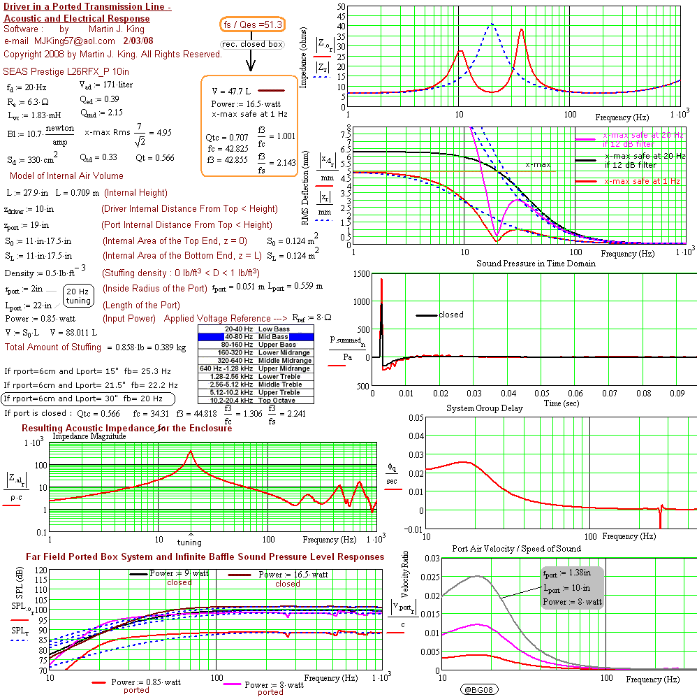

...minimum diameter came out at 9.6 cm and it said to make it a bit bigger, so i used 12cm, is this ok?...
Ok if you choose a dia.12 cm port and want to tune your 88L box to 20 Hz, then the port length is about 76 cm, but the maximum power you can put in the woofer is very limited and a port with dimensions: 7 cm dia, 25 cm in length, will result in a vent air flow less than 9 m/s at maximum input power that should be restricted at 20 Hz with a 12 dB HP filter.
