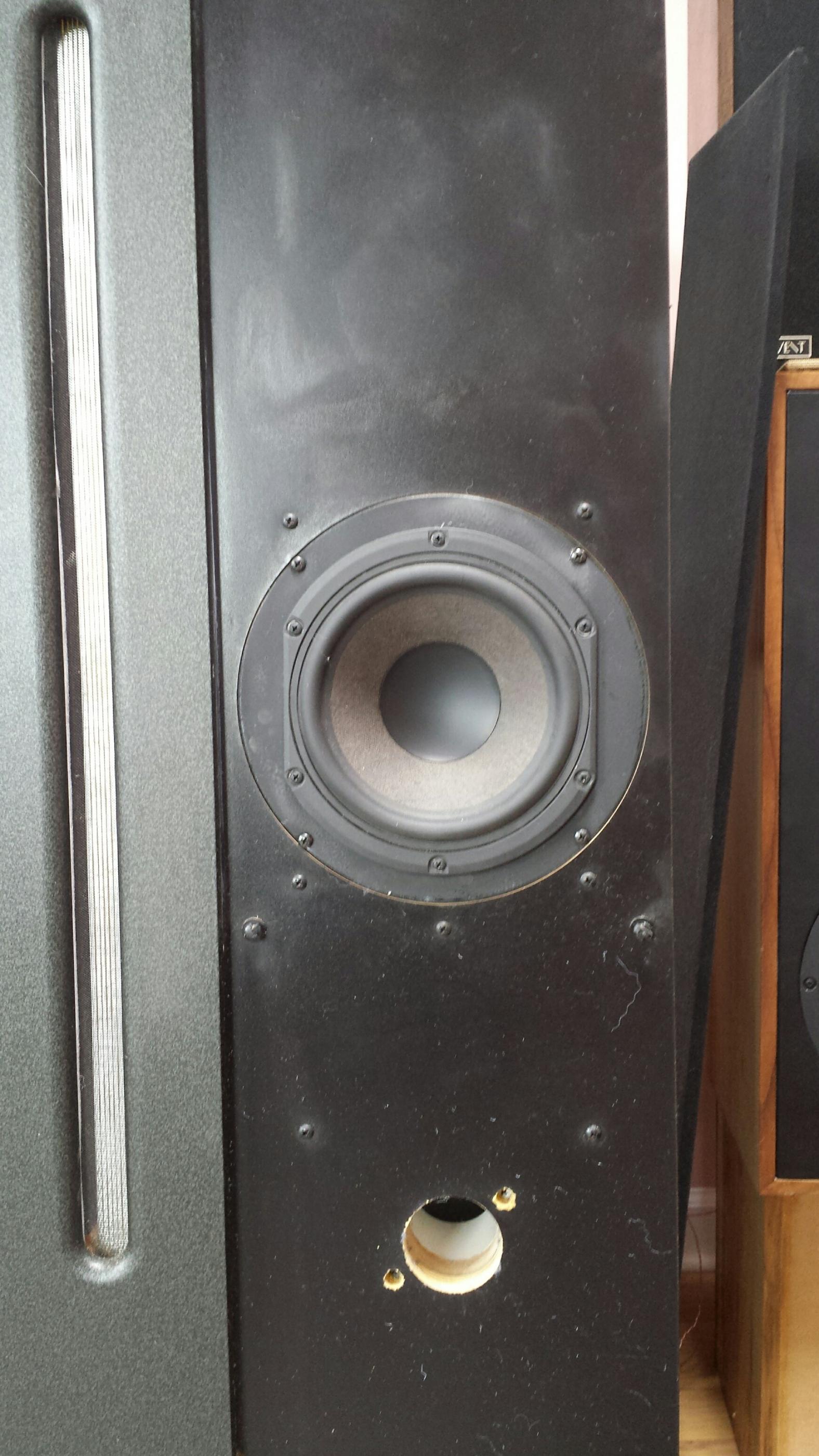

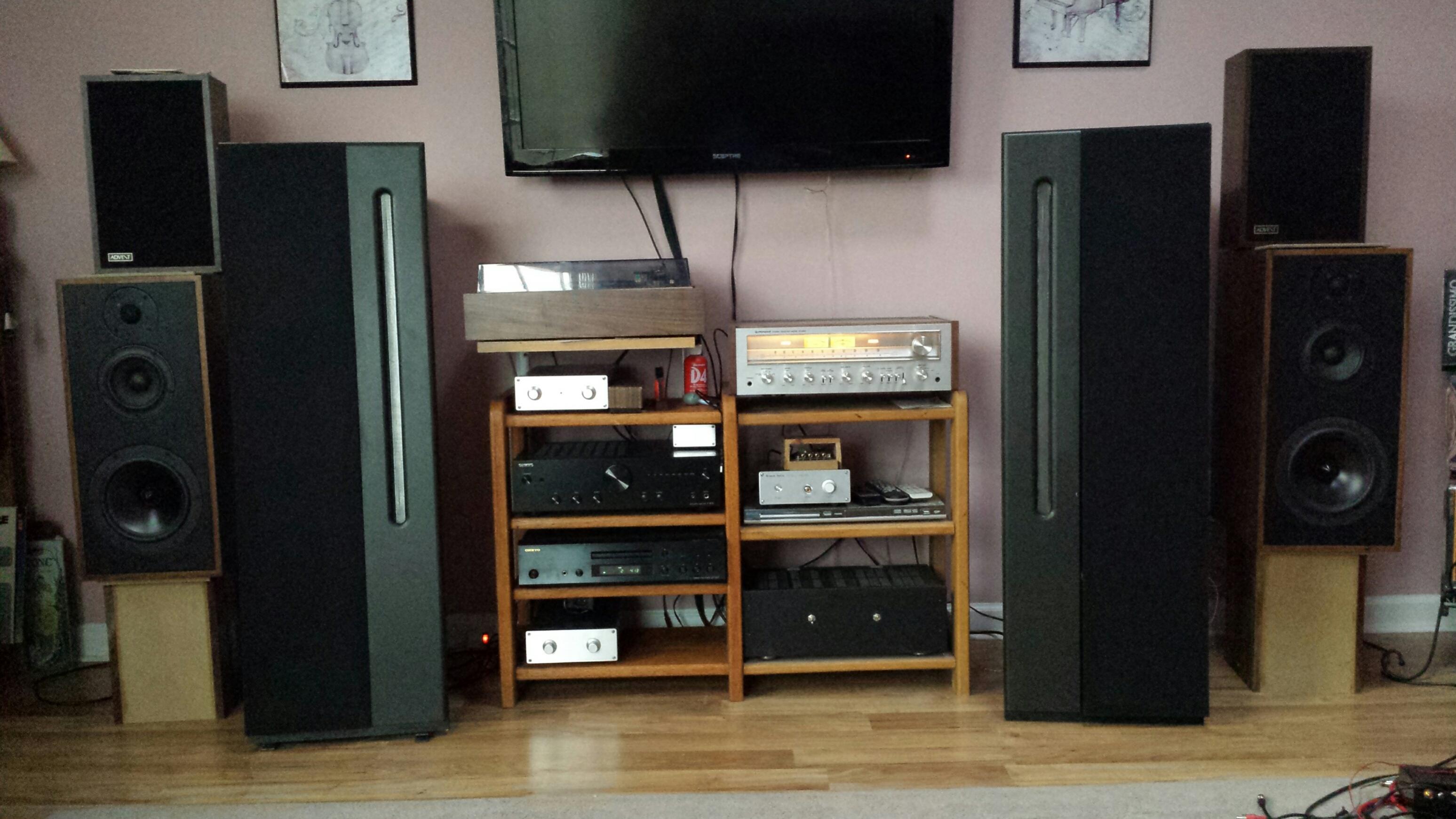

My open baffle 26" ribbon/ 4 6.5" woofers have been suffering some baffle warp age, or bending really. So I disassembled them and put the ribbons back in the original centaur cabinets while I figure out how to fix the OB panels.

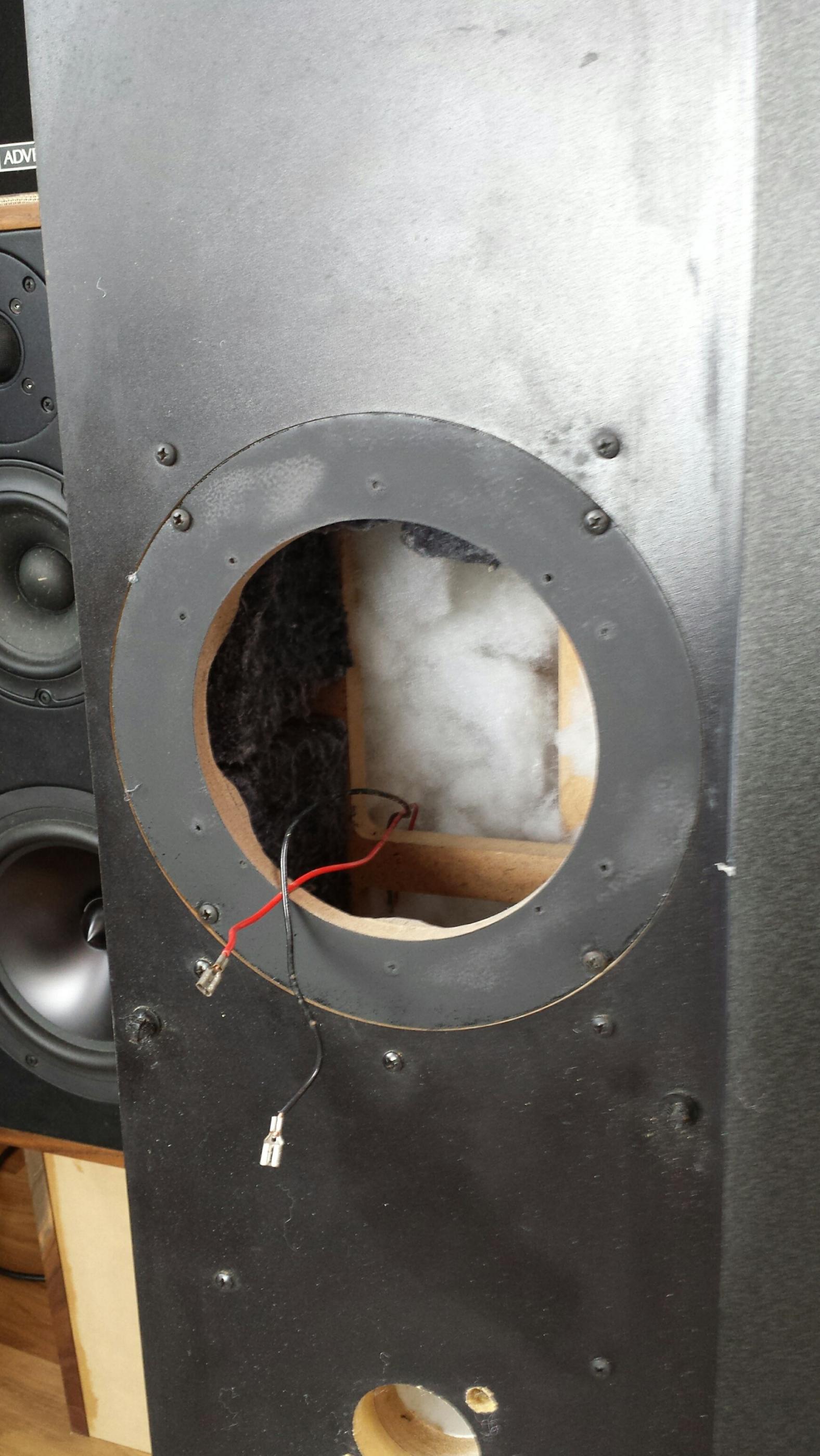

I then removed the 8" woofers from the centaur cabinets and stripped out about 100lbs polyfill(I have never seen such solid stuffing in a speaker).
I created a 2"dia x3.5" long port below the woofer, made an adapter and installed a 6.5" Peerless nomex woofer in each enclosure. Made sure the original crossovers were still serviceable, wired everything back up without any mods to the crossover, thinking that the lower rated sensitivity of the replacement woofer might not integrate well with the ribbon.
Wow! There is now some decent bass as opposed to the old dry stuffy bass. And the woofer/ribbon blending is great. There was a about a 3db hump centered around 80hz, so I placed a small amount of polyfill in each port and cut the bass pot on my amplifier(an old Pioneer SX-650 receiver actually) a little.
These things make some beautiful music. Very different from before the mod.
Highly recommended if anyone wants a significant improvement in bass performance of their centaurs. I would imagine that they now sound something like the Slant 6.

Though, in the present centaur configuration there is no need for a sub and they are really grabbing me. They have a more forward presentation rather than the original laid back. Voices, especially female, are stunning.
