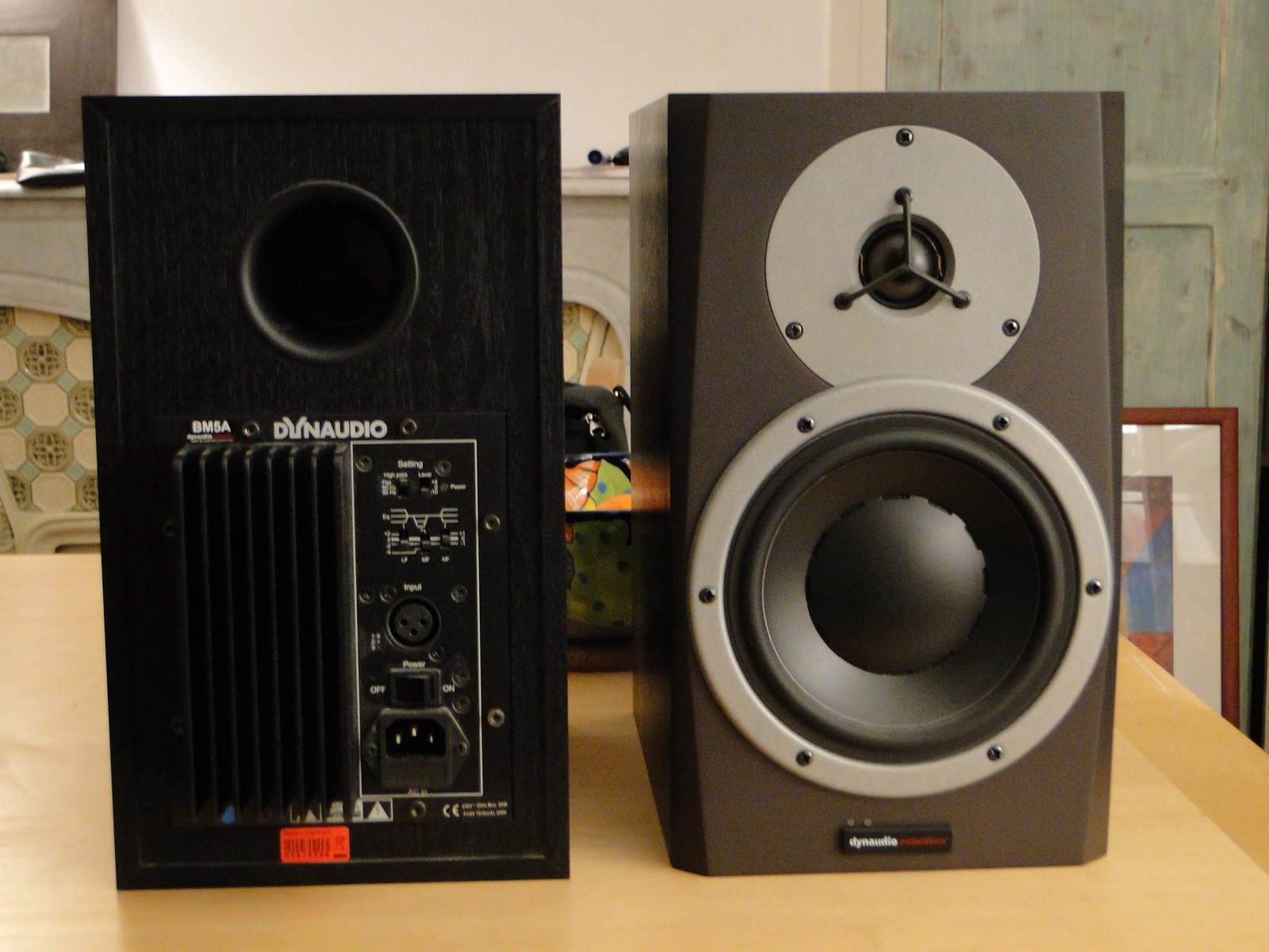

All this talk of ports......I had these Dynaudio bm5a for a while now...an I must say there sound with there mosfet active amps... an a old hhscott tube preamp ...there crossover is at 1500hz....6db .....give a big stage-image with the 1.1" Silk tweeters.. 6"mid-bass....with 3" voice coil...2 1/2" X 5 long tube port in the back....an my two 12" subs.....give these ribbons a run for there money......vary panels like sound....I say as good a sound as I have ever had....from piston type drivers.....kills B&W...mabe if the 801s had these seting in for that mid- an ringing tweeter.....
I Am thinking of droping one of these Dynandio 6" driver in the Minors......what do you think....
