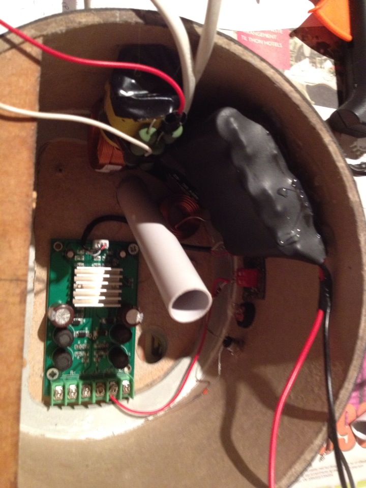

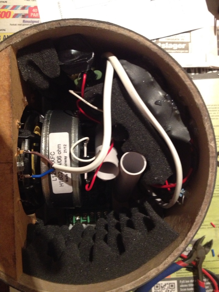

Just built this portable speaker using a Seas L12RE/XFC coaxial unit. I followed the application note from seas, but had to reduce the volume to 2.2 litres to get the size I wanted. Battery pack and tripath TA2021 inside. It plays really nice, but not too loud, could do with some more power, but in most cases it's enough. I run it off my iPhone and on some music the poor audio output on the iPhone is really noticeable. Next step would be a DAC that is iPhone compatible. But still this plays way better than any commercial portable loudspeakers of similar size I have heard.

Well regarding how it images, does it not really need to be stereo to image good? I have not compared it to any similar size small speaker with a midbass and a tweeter. I can say that it sounds very good, and the highs are definately better than my bedroom stereo speakers with tangband w3-1878 full range. And the bass goes lower too, but the w3-1878 might go just as low in a bigger box (i use them in 3.6 liters)
The reason for choosing the seas, was that they play down to 60Hz in a 2.5 liter box. I have not been able to find any other 4-5" that will do that. All at the expense of efficiency. But still enough for portable use.
I use 10 Nimh AA cells rated at 2700 mA. The batteries lasts for weeks, when i use it occasionally. I would estimate it could handle atleast 10 hours continiously at low to normal listening levels.
