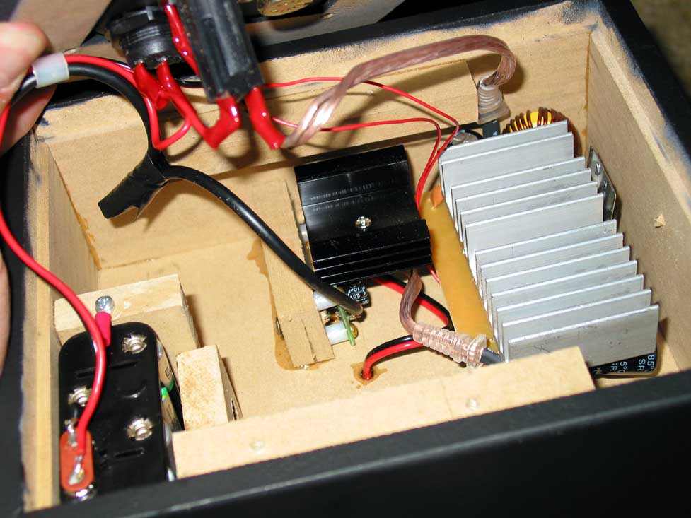

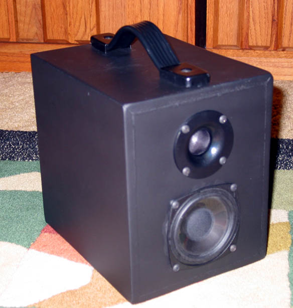

After a couple weeks of building on and off, and of course waiting for parts to come in I finally finished my small portable speaker project. This little guy is battery powered off of 8 AA batteries and put out 10 watts RMS 18 Max. I use a dc to dc converter to get the necessary 18 volts need to run the amplifier. Overall for a portable application this little guy puts out quite a bit of sound; it’s great for the trips to the beach...and much better than your average boom box. I still figuring out what I should do for a grill; I’m thinking of just using a surplus 5x7 car speaker grill but if you guys have any ideas of what else I could do let me know
The picture below is blurry I know but it an over view of the box:

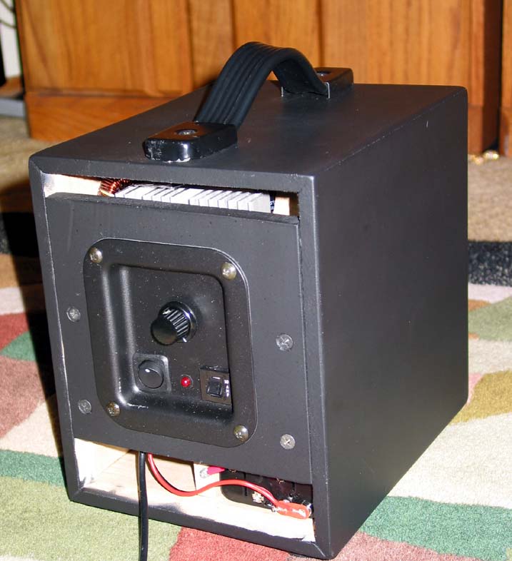

Picture of back side of the unit. On/off switch and light, 10 amp breaker, and unused audio pot. You can also see the giant heat sink of the dc to dc conveter. With the load of music at max non distortion volume it plays for more than 2 hours with AA NiMH 2100 mah.
On the larger drivers: my orginal designed box was much smaller and couldn't have supported big drivers but some how it got streched it out when i was designing the fit of the electronic area. Now that it is accually completed i see i have lots of extra room in the electonics area so basically I have an oversized box. I thought about making that speaker on the front baffle a mid and then buying a 5" woofer and mounting it on the side. Not sure how well that would work but this current design with my taste for bass doesnt quite do it.
