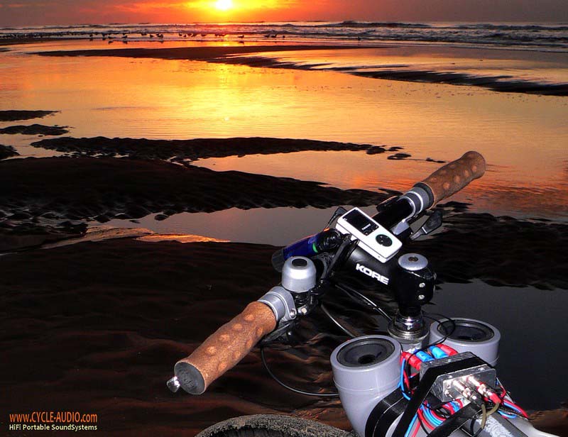

I figured class D would be used by many for portable applications. I built a small sound system for a friend who rides with it on his bicycle.
He sent me a picture that inspired me to open up a gallery.
Feel free to post your pictures with a nice 'on the road' feeling or pictures of your portable system! :)
This system uses 41hz.com AMP32, two Visaton FR7 (for now...), a Transcend T-sonic 610 (the 620 is out and is supposed to sound even better, though I can't imagine...) and a 6A Nicad battery in the bottleholder... The system runs for about 25 hours (much longer than the T-sonic..) at full power...
Love to see some of your pictures!:cool:
Hahah, thanx, the system can be detached pretty easily and it IS a flash MP3 player (there's a 4gb version out now, but this one is 2gb).
I have a Marrocan friend, cool guy...walked into my appartement one day and -as he's quite a humoristic guy- he took two of my bottle batteries in his hands and said he'd never get even near schiphol (amsterdam airfield) with those...:clown:
I'm going to upgrade the system with lower weight batteries, lighting system, phone charge, usb connection, solar panels (flexible ones!) voltage meter and waterproof speakers in the near future....
