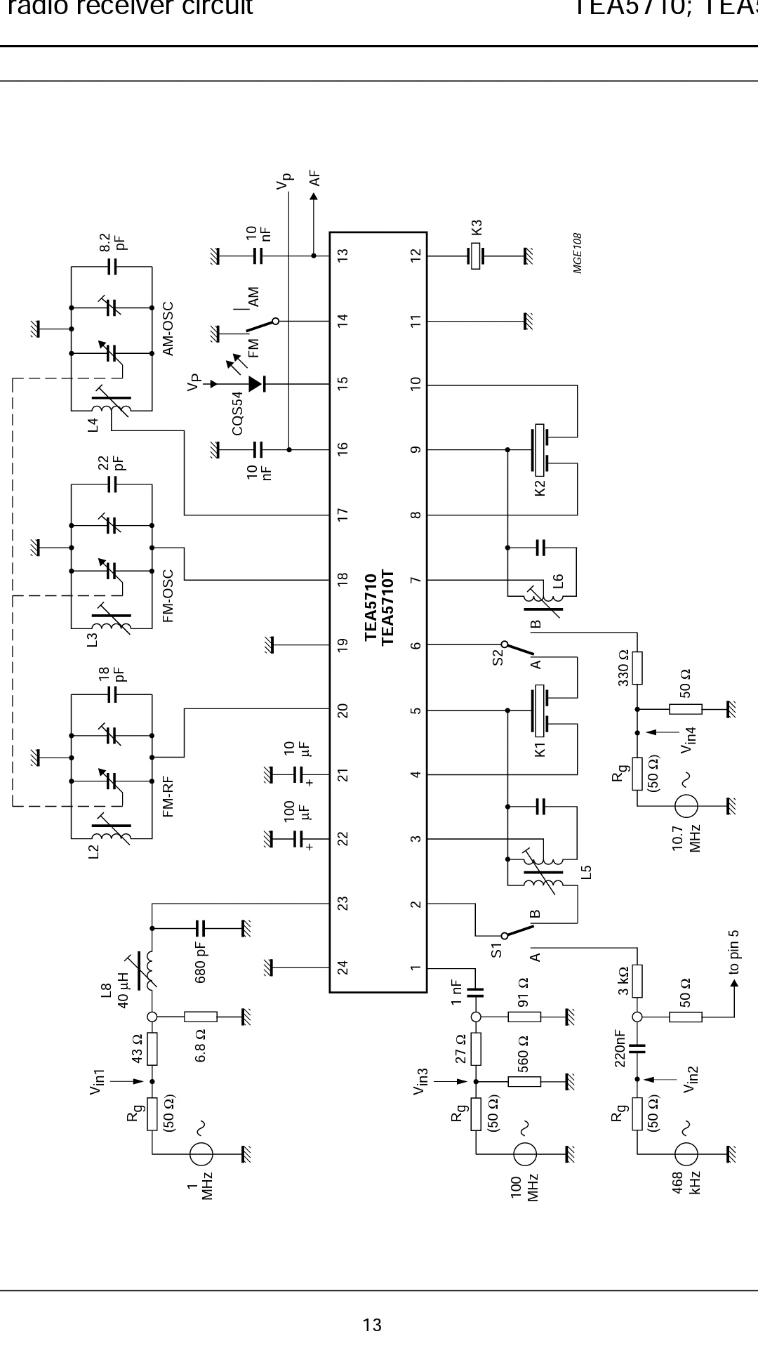

I have a small old clock radio that won't tune to 88.7 MHz, my FM stereo transmitter. I will open it and play around. I don't mind anything happening to it.
Edit: It is not made of discretes.
Gajanan Phadte
I attempted my clock radio. It is single chip TEA5713 based am/fm and has ceramic filters for the 10.7 MHz IF.
I first turned cw the ferrite of the fm oscillator coil and tuned it to 88.1 MHz(my FM transmitter) with the gang positioned ccw, the position it goes to max capacitance.
Then I tried to receive the local station 105.4MHz. This station which was tuning before had gone out of the tuning range of the gang condenser.
Brought back the FM osc coil to the initial position and adjusted the fm osc trimmer on the gang to receive 88.1 very near to the end ccw position. Tried to tune 105.4MHz and found that it is positioned near the cw end of the gang.
The conclusion...
The gang c0ndenser is not attaining the specified max capacitance on turning to the ccw position due to wear and tear. If the ccw position is adjusted for the low end of the FM band, the trimmed in higher value pf prevents the gang from reaching the lowest value needed to tune high end of the FM band.
Inference...Gang condenser needs to be replaced.
Take the pf measurement of the removed gang in cw position and adjust this value into the replacement gang condenser. Then solder it in.

I can see only one ceramic capacitor connected across the FM osc coil that, if leaky, would stop the oscillator.
The gang is a plastic 2J iirc.
