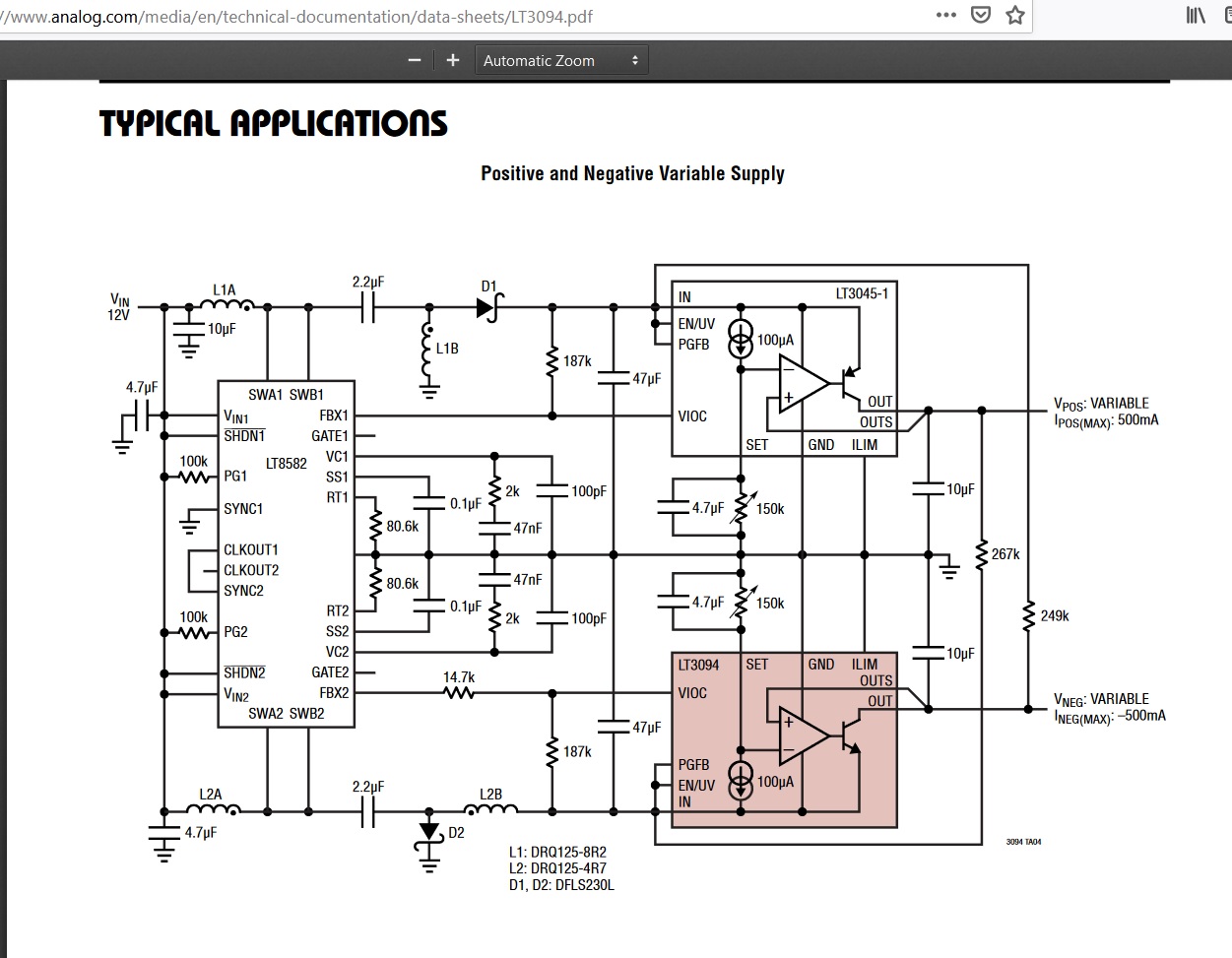

Speaking about switching regulators (used in audio projects), it is almost impossible to make it right from the first try. So I would suggest you to build and measure/test it first, then you will be able to learn a lot from inherent mistakes.

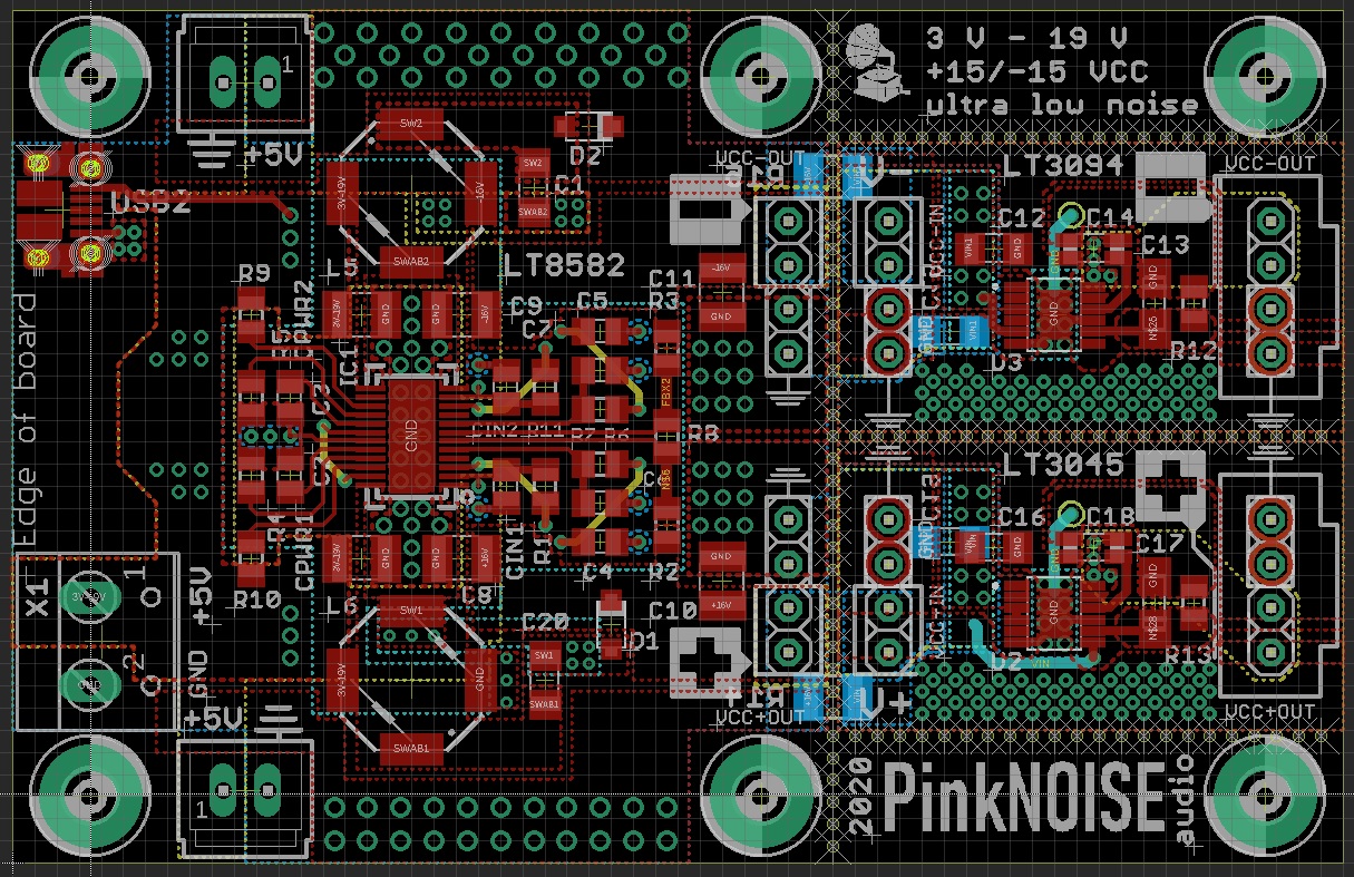

I almost finished to design a PSU prototype, also for a portable (or not) headphones amp. It is based on a schematic from LT3094 datasheet. I have never tried switching regulators in my audio projects, so this will be the first time. 🙂

Are you sure you want to DIY with DFN 7x5 (the only available package of the LT8582) ?
Patrick
3094 is the new one for AD, if I'm not mistaken, right?
Yes, it is newer, as LT3045-1 is. Their VIOC feature seems interesting to me. LT3045 (without -1) and LT3042 don't have it.
"The VIOC pin is used to control an upstream switching converter and facilitate a design solution that maximizes system efficiency while providing good transient response, low noise, and high power supply ripple rejection (PSRR) by maintaining a constant voltage across the LT3094 regardless of the device’s output voltage."
It is easier for me to solder DFN chips, like ESS9038Q2M, using hot air, than TSSOP chips, like PCM1794. For a little extra control, I always design the DFN chips footprint having 0.5 mm longer (than chip case) pads for every pin.

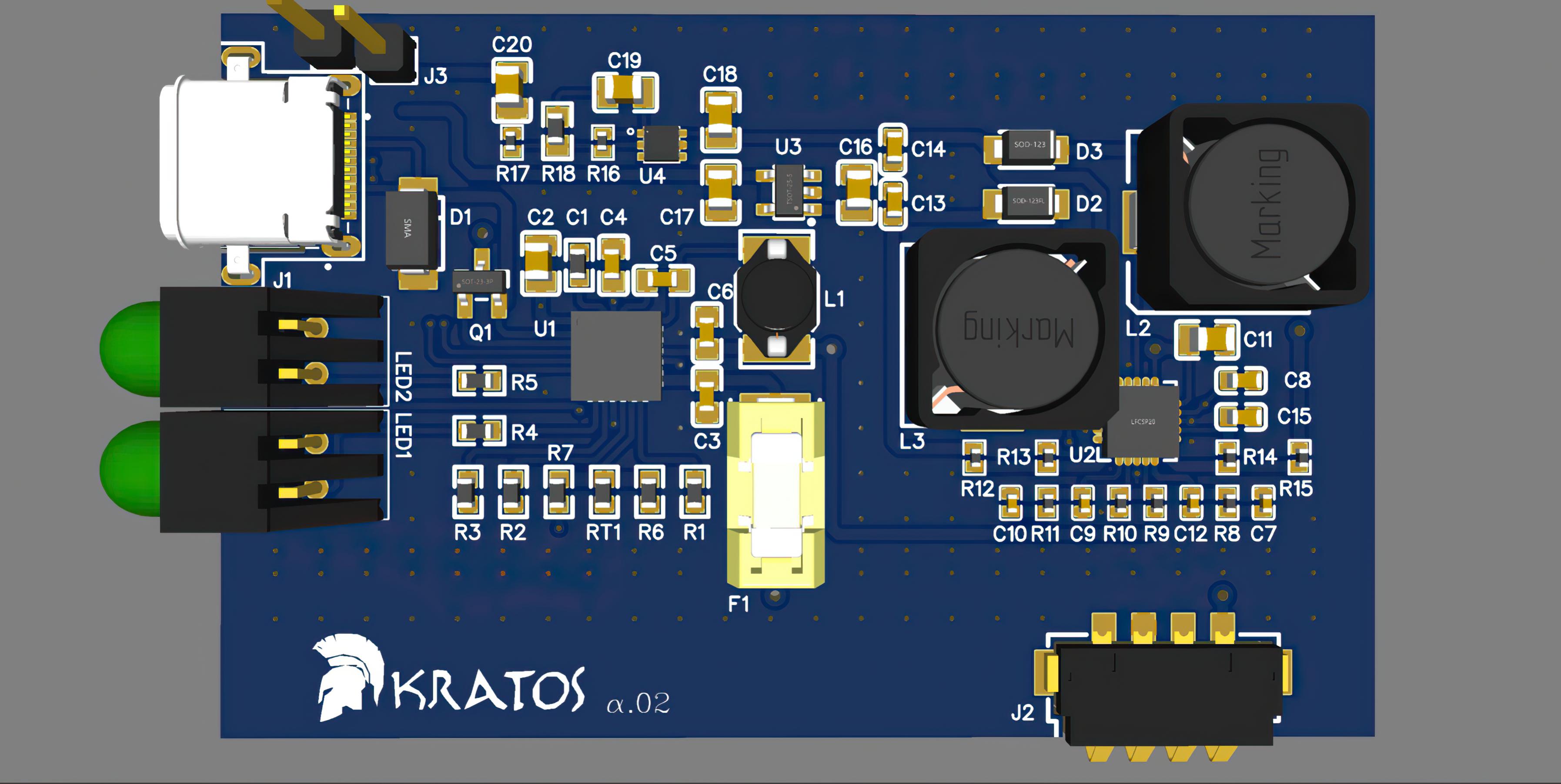

I've learnt a bit more since the time I posted the above question and went a bit different path as suggested by @sgrossklass
This is what I came up with since than:
BQ25616JRTWR 5V Battery Charger IC (/w external protection) --> ADP5071ACPZ-R7 ±10V Split-Rail Boost Converter --> ADP7142AUJZ-5.0-R7 +9V LDO for Positive Rail and ADP7182ACPZN-R7 -9V LDO for Negative Rail
