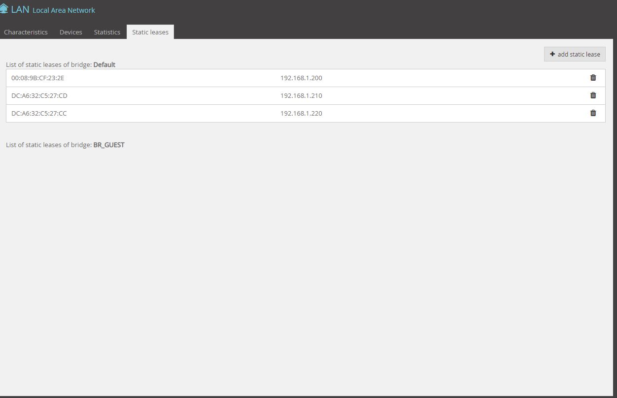

Instead of using automatic DHCP for network address assignment, You can give each device it's own fixed IP address reserving them in the router "static leases" configuration page, so they are always assigned to them.
They must also be included in the router's DHCP pool range.
Some routers begin to assign addresses via DHCP after a certain number, so You can use the lower ones for that. Most common is assigning 64 upwards in triple play subscriptions. So, 63 not assigned by DHCP IP addresses are available. In this case, just assign on each device a fixed IP address lower than 64 or change & exclude some of the upper DHCP pool configured addresses in the router if TV starts to freeze.
Don't forget to remove the static leases.
MY Picoreplayer & the QNAP NAS have a fixed IP address this way.

In my example, the first one is the NAS.
Second & third are the PI Wired & Wireless interfaces.

Yes, I already did this. This is my /etc/dhcp/dhcpd.confInstead of using automatic DHCP for network address assignment, You can give each device its own fixed IP address
Code:
subnet 10.0.0.0 netmask 255.255.255.0 {
range 10.0.0.2 10.0.0.100;
option broadcast-address 10.0.0.255;
host AudioPro_C5_6942D4 {
hardware ethernet xx:xx:xx:xx:xx:xx;
fixed-address 10.0.0.1;
So the C5 has a fixed IP address of 10.0.0.1, and all other devices are assigned IP addresses from 10.0.0.2 and up.
And I also use this approach on my home network - my NAS and music server both have fixed IP addresses.
