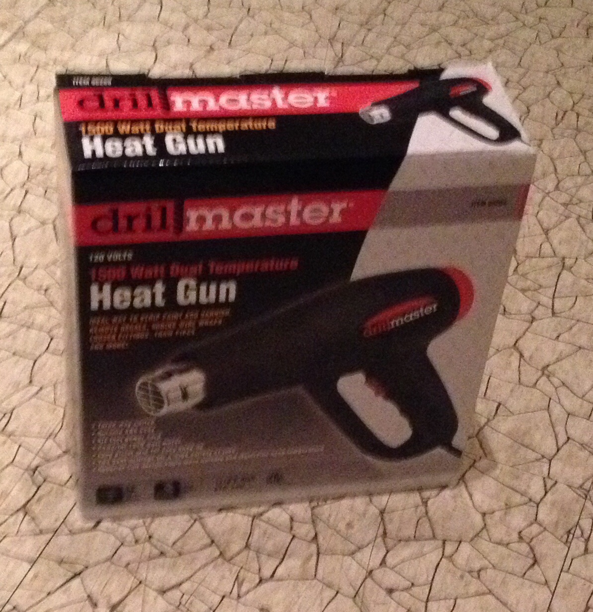

What kind of heat gun are you using? Show us a photo as I can't imagine a small shop one being able to handle how big of an area you are softening up. The curves look awesome though - it will be too nice once you paint it with an automotive finish. You will have the same behavior as someone with a shiny new car who refuses to park in a tight lot for fear of door dings. So they either walk real far or they don't drive the car. 🙂
Sure thing.... It's just an el-cheapo heat gun, $20 from Harbor Freight if I remember correctly.
