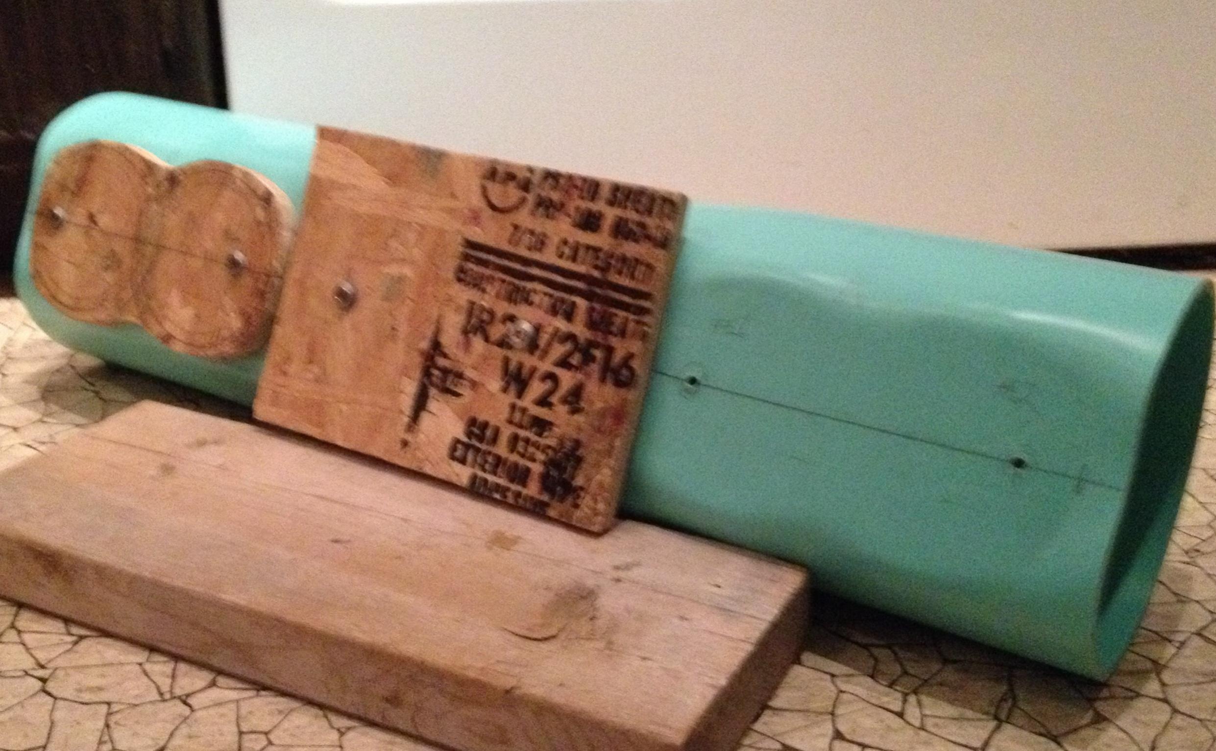

Well, I got a box. Now I need some woofers...
Right now the enclosure is about .35 cubic feet, and I'm going to glue a half pice of 4" PVC to the back to make room for the amp ( 8" deep amp, PVC doesn't stretch well, it tears ) which will add another .05 cu ft. So, after running some numbers I decided to use 4 Dayton Audio ND91-8 3.5" woofers ( PE # 290-226 ). One piece aluminum cone/ dust cap ( cool ), rubber surround ( this may be used in some harsh conditions ), good excursion ( 5.1 mm underhung voice coil, gotta love neodymium ), and the price is right. I REALLY wanted to try the new Tang Band W3-2088SOF RBM woofer, but the price was right on the Dayton's, maybe next time.
At this point I realized that this thing is going to look pretty cool, so I decided to rear mount the woofers. So, I made a back plate out of 1/4" hardboard to help distribute the pressure on the stamped frame when I mount the woofers. It was a little tricky getting all 24 mounting holes ( on each side, 48 total ) for the woofers lined up just right, remember woofers are 1 mm apart. Time for a test fit to see how everything is going...
Pretty good fit, pain to put together, but it works. Here's a peek inside.

Hmmmm, let me try those pics again... I can't seem to edit my last post either...
Test fit:
Peek inside:
And a bunch of parts:

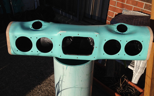

Nothing that special really, the molds are just 1/2" particle board. I cut out two pieces in the shape of the flat spots, one on the inside one on the outside. Just heat up the PVC ( heat gun or blanket ) and use the molds to smash the PVC flat by running long screws through everything to pull the molds together. It takes a little practice to figure out what the PVC will let you do without tearing or cracking.
Here's a ( big blurry )pic with the woofer mold still in place while the tube was cooling...

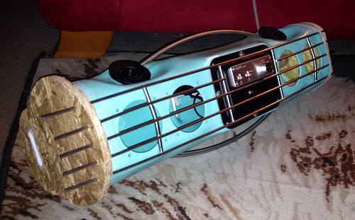

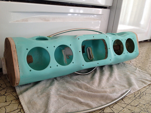

Well, I glued everything together and now I have a box. I mounted everything back into the box to make sure there were no leaks. Oh, did I mention that it is a pain to mount the woofers in this thing. Each side has one back plate, two woofers, and 8 screws all working through the amp hole. Man, I tell you what, those first two screws...…
Anyways, no leaks( OK, a little through the amp, a gasket and maybe glue gun will take care of that ). Actually, it is a pretty solid box. I can feel the flat spots on the top and bottom vibrating a little bit, but other that that it feels rock solid. I was also concerned with port noise, I only tested with 1.5" PVC but my smashed vent was only .74 square inches, less than half the size. Well, it worked out fine, lots of air moving but I can't hear it.

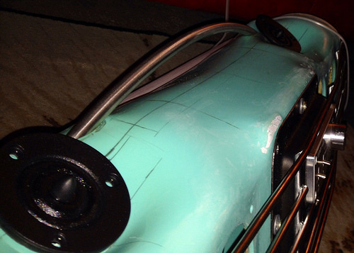

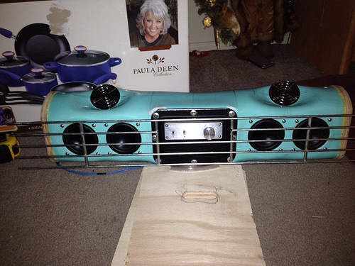

Now for a little cosmetic stuff.... First I need some way to protect the drivers. I really didn't have enough room to mount any sort of small car speaker grills. I didn't want to use cloth, it would just get so dusty plus I want to see the woofers ( they are cool ). So I found an old stainless steel wire shelf and cut a grill to go across the whole thing. Cleaned it up with a wire brush, and.…..
I got a grill. The tweeter grills are cut from computer fan grills. Looking good so far.
Now for a handle... A friend of mine suggested a kitchen cabinet handle. So, after shopping a little I found this simple sleek handle. Worked out nicely for a foot to angle the box up a little. They were cheap enough, so I got a couple different sizes to play with...
Looks good. I molded the handles in place...
Next I cut out a sample end cap, just trying to figure out the final shape of it. You can also see how I'm going to mount the grill....
Well, that's just about it for the enclosure. I sprayed a few coats of damping materiel inside the box. I was just going to paint it with some durable textured brush on stuff... However, a buddy, who works at a body shop, really wanted to paint it,. He said he will, " make it perfect "... 🙂 I'm talking smoothing, primer, base, paint, few coats of clear, wet sanding... The works, I just couldn't say no😀 ( only problem is I won't want to take it to work, it’ll be too nice, lol ) Here it is all ready for paint...
Well that's it for now.... I'm just ( imaptiently,lol ) waiting to get it back.... I'll keep you guys updated..
What do you think so far?
