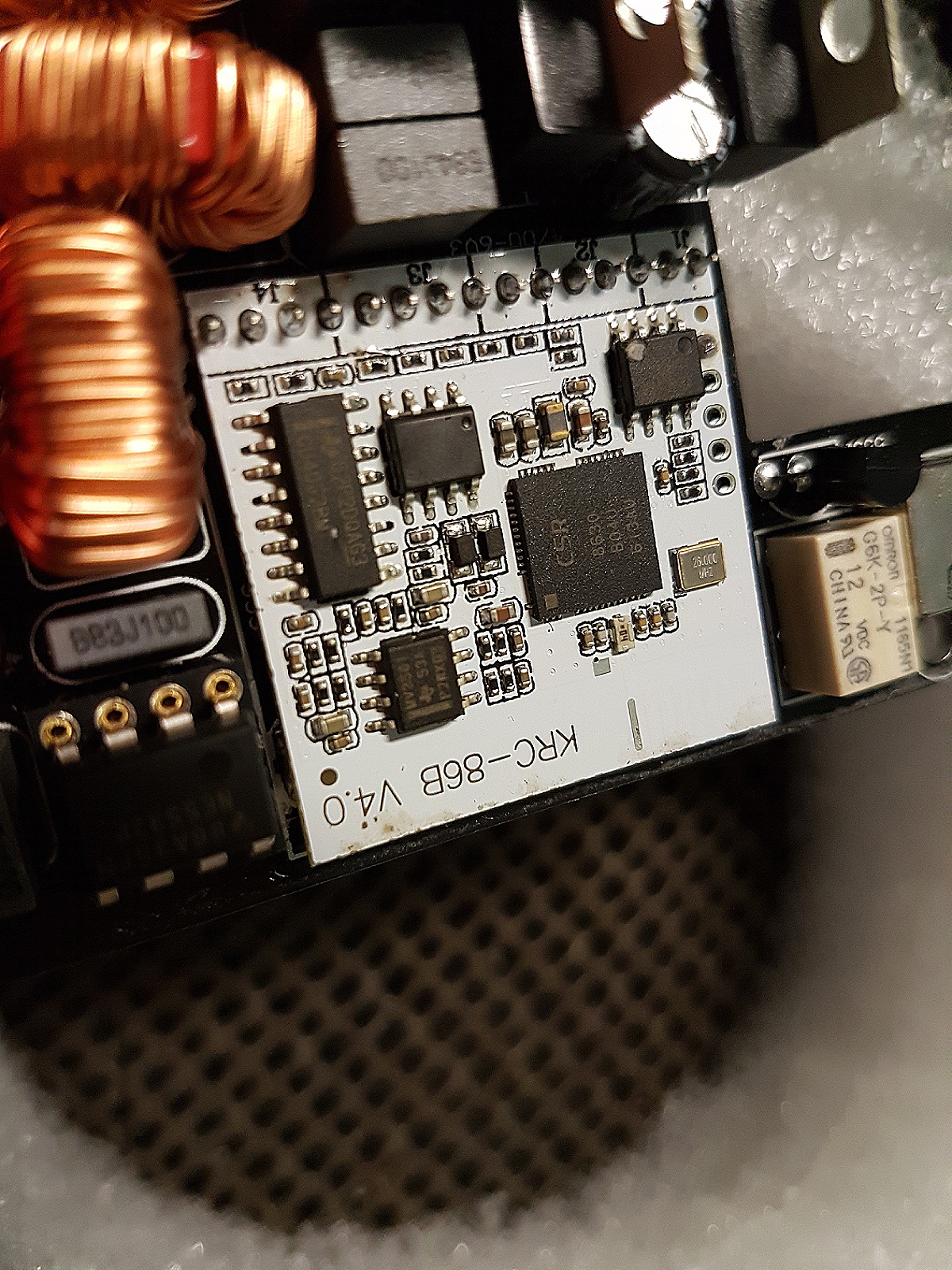

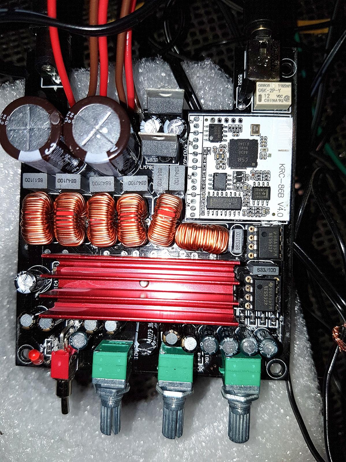

I bought a doukaudio/nobsound tpa 3116 amp bluetooth board which is more expensive than other boards but seems to have better components etc. For a boombox project. However the bt connection has static which seems to be a ground loop problem common in bt receivers. Has anyone had a similar problem or is mine defective?

I see you on your site you have a fix for "noise" for the sanwu tpa 3116 amp where you disconnect the bluetooth buffer. Is this the problem here too? The noise you mention is the bt static? Why would the buffer be a problem. Is it a grounding issue?

The fix doctormod described is for Sanwu boards where there is a single ended buffer between the differential outputs of the BT chip and the differential inputs of TPA3116. Removing the the buffer from the path and wiring differential outputs of the BT chip directly to the differential inputs of TPA3116 eliminates the noise. (I am highly curious as to why they put that buffer on the board in the first place. Probably somebody copied the schematics of a TPA3116 board with AUX input and added the BT output signals to where the AUX input was in the original design.)
In your case, this is probably not very practical. The 2.1 amp you are using has tone control and low pass filter stages which probably use opamps. I'm not sure how you can bypass all that stuff cleanly.

I haven't heard any any chinese amp-board with tone-control which did not suffered from noise problems.
Is the noise gone if you're using the AUX?
Things might get better if you put some 10R in the supply line of the BT module and solder a good low ESR filtercap across the supply input.

It's pin 1-2. It needs to "low esr" and "huge" in terms of capacitance. I had success on other modules with 10R+1500uF.
It is a pretty common issue with these modules and yours in general.
