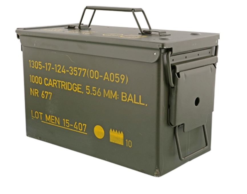

I'm new to this site and wanna ask for some advice on building my 5th portable speaker.
I was looking to build a portable speaker in a ammunition box, with a wondom jab3+ and a 4s2p battery and a inlay of wood (for stability). I was wondering what drivers to use in it 4,5l internal volume without the drivers. For playing inside aswell as outside.

That thick and it dents?

I have just recieved the ammunition box. The inside measurements are as follow: 14,5 cm x 28,5 cm x 18 cm. 0,3 cm thick. With a inlay of wood, battery and amplifier im looking at 4,5 liters of free air. I was thinking on going 2 x dayton audio tcp115-8 no dividing of the inner free space (mono). First i wil try sealed and when i'm not satisfied with the sound i can always make a tube in the side.That thick and it dents?

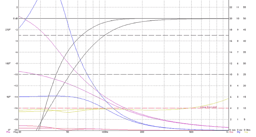

The config as followed: dual tcp115-8 in one enclosure with 4l of free air wil get me a -3db at 60hz -8db at 50hz. I can also use some algorithms in sigmastudio since im using a dsp to enhance bass.Never worked with a PR, any tips ar welcome!
A PR is a substitute for a vent. Your small box would require a vent larger than the inside of the box so one has to sub a PR.
F3 is meaninless to humans (ref Toole). Much better to consider F6/F10
dave

not 5mm walls for certain, it would be incredibly heavy.Around 0.5 cm thick, it dents easy. Thats why i wanna do the inside with 0.9cm wood.
Expect around 0.9 to 1 mm or so.
Absolute tops 1.2mm but I´d be surprised.
