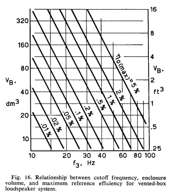

Anyway, to the 1st approximation:
Low corner sets Fs = 25*.707 = ~17.68 Hz Fs
For vented, Vb sets Vas for optimal Fs tuning = 8 ft^3*1.44 = 11.52 ft^3
Qts' sets BW = ~17.68*2/200 = ~0.1768 Qts'
Vb sets box efficiency, so guessing per chart: 8 ft^3 = ~1.5% = ~93.76 dB
Qts' = Qts + any added series resistance [Rs]: Calculate new Qts with Series Resistor
You might find a driver with 'close enough' specs at some exorbitant price, but down low were're normally trading efficiency for BW, smaller box. :(
