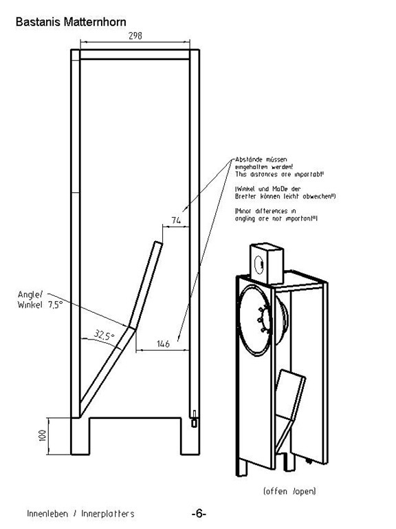

G.R. Koonce did it that way long ago in Speaker Builder magazine - IIRC called a "diiffusorr port" I did it with two ramps forming a "V" on a SEAS 3-way box.
It was eon with a BVR - "Materhorn"

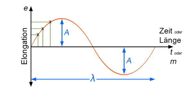

All, I searched the internet and found KEF’s suggestion on their website: “For those who prefer to make calculations, you can figure out the affected frequencies with this formula: 340/4 times the distance from the front baffle to the rear wall (in metres).” Could anybody explain this formula, please? Where does it come from? v=f*lambda?, etc.
It is about the positive part of a wave hitting the wall behind it, being reflected and reaching the source of the wave, again. The source has turned negative at this moment and the wave is canceled.
You have to see a wave in whole and slice it into 4 parts 90° apart. So you start at 0°, go to the top positive, down to zero again, then to top negative and back to zero. This is a single sound wave. Depending of frequency, this takes some time. For 50 Hz the whole cycle takes 1/50=0.02seconds. For 100Hz it is 0.01sec.
The wave travels at 340m/s which make a 50Hz wave 17m long. So at a distance of 4.25m from a wall, there is cancelation.
This is a very corse way of describing in room acoustics, more or less useless to be honest, as any object around the speaker, wall, ceiling and floor affect the sound energy at the listening point.
KEF was very good at inducing physics into advertising and leaving the sense in the dark, knowing most customers would not even try to understand. Like talking about magic "acoustic Butterworth x-over" without explaining what simple idea was behind it, used by any measuring speaker constructor anyway.
