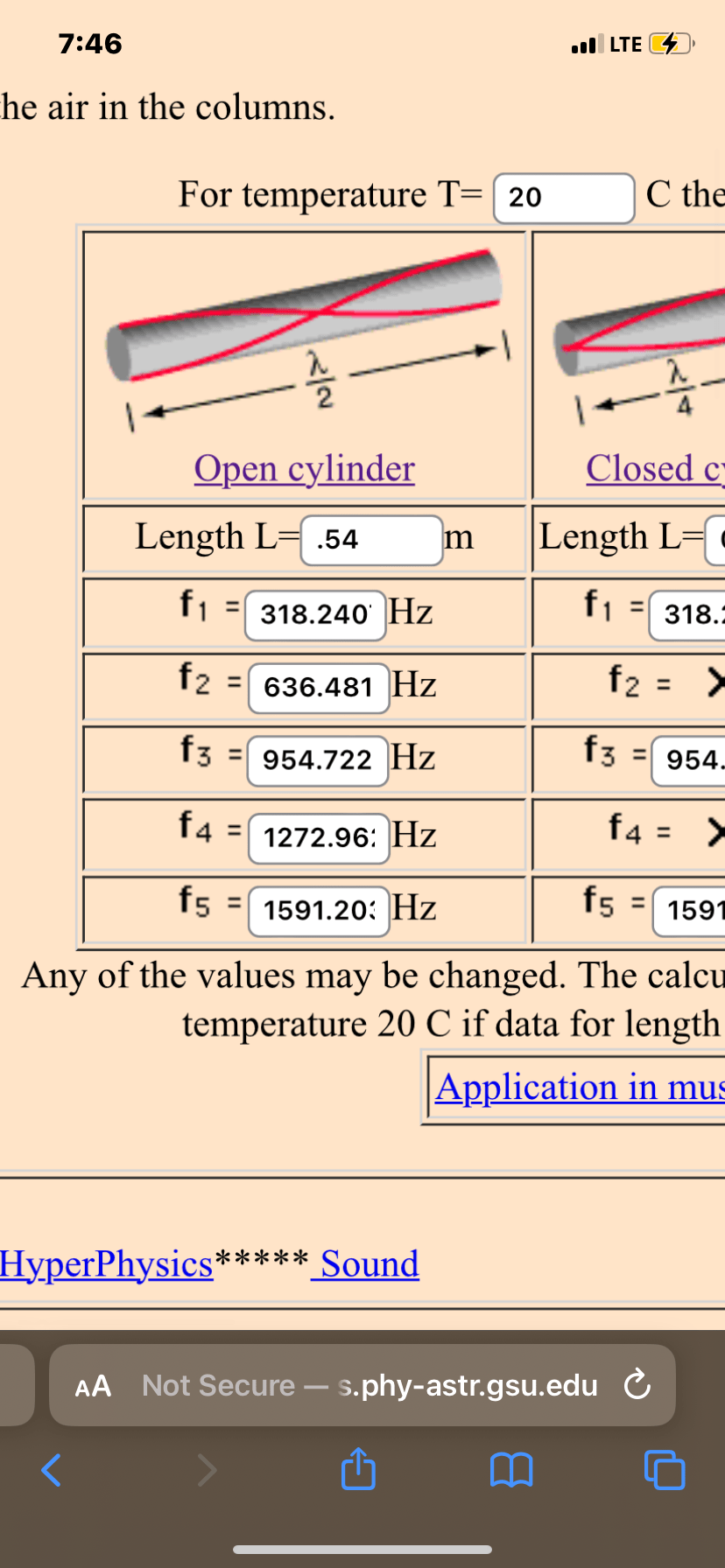

Port tube resonace?
That’s a ‘54cm port tube resonance (halfwave) not a 81 cm/3, 1/4 wave resonance , right?
(320 hz in the response shape)

‘It does seem to be the case. The port is open at both ends, as per the cylinder example that you have provided. It's gratifying that the simple analysis works so well.’
yeah, I didn’t realize so many different resonances could exist based on the geometry of these sort of TL, sort if bass reflex types of designs?
