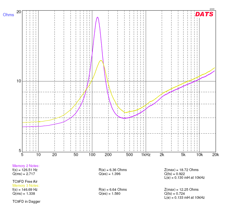

Here is the measured Qts for the TC9FD in free-air (Qts=0.922) and in the 1.1 liter Dagger (Qts=0.724). That is a substantial flattening of the impedance peak by the sealed aperiodic TL to do that.

I'd like to see a Qtc with the TC9FD. Running the 10F through WinIDS in a 1.1l sealed box gives a Qtc of 0.636.
Hmmmmmm.
Bob
X can you confirm this that when talks Dagger combined 10F its the the sealed Dagger see below and when talks Dagger combined TC9FD its the Dagger that is open in the end (TL) see below and makes a difference : )Here is the measured Qts for the TC9FD in free-air (Qts=0.922) and in the 1.1 liter Dagger (Qts=0.724). That is a substantial flattening of the impedance peak by the sealed aperiodic TL to do that.
10F in sealed Dagger.
TC9FD in Dagger (TL).

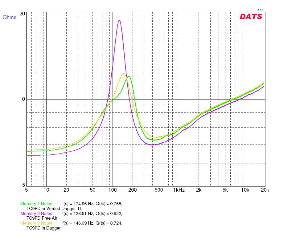

I just put the TC9FD in the vented Dagger TL (green) and the Qts is higher than the sealed (yellow)- although the dimensions of the Dagger are not identical. Free air is magenta color:
There is a small feature in the peak that makes it asymmetric once the vent is added. I recall that the phase is smoother with vent though, and that may be result of the smoother curved shoulders of the peak as evidenced for example near 400hz for sealed vs vented TL.
Your Dagger is running as an aperiodic enclosure. No question here. The point of departure is Qtc. The TC9FD has a Qts of ~0.9. The physics of the matter is that ANY enclosure will RAISE Qtc. So, what you need to explain is how the Dagger DECREASES Qtc.

I did not realize I was violating physics here... the measurements are the measurements and I trust the DATS v2 as working properly (verified to measure Qts of known drivers properly compared to manufacturer specs, and it measures L and C of know passive components accurately). What I do know is that the impedance peak is wider than the free air case. It is wider because the high-Q mechanical resonance is squashed with all the non-resonant non-parallel walls and lots of stuffing. So I think the effect is coming through as modification of the Qms, not Qes. Look at the TC9FD's Qms, it went from 2.72 to 1.34 before and after the Dagger. The Qes actually went up a little, but the Qms went down a lot - so no magic here that Qts went down as well.

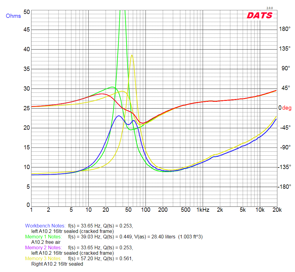

Also i think of if leaking is some of the answer because looking my old files for A10.2 i see same behavior for my left speaker which have a cracked frame that then can leak. Right speaker have textbook Qts higher than in free air and the one with cracked frame have less Qts than in free air and as xrk971 example then resonance get a little wider than the free air. As the A10.2 can leak thru the cracked frame i think 10F in the foam core DCR box have same possibility in that foam core is not stiff as wood and can flex where driver frame and foam touch each other between the four mounting screws.

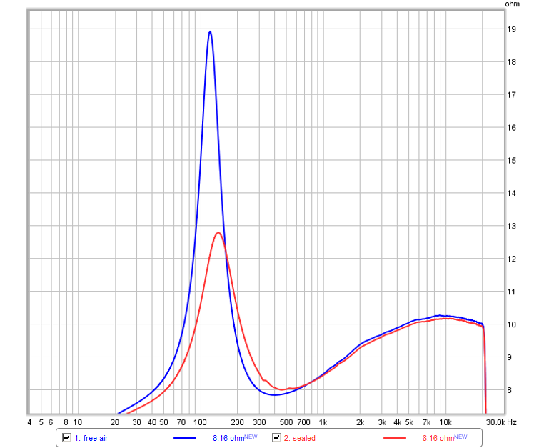

I ran impedance sweeps with REW; haven't done this before. Here is TC9FD impedance plots I got with driver sealed in 4" PVC pipe with about 13.5" internal length and stuffed full of Dacron batting and with a second TC9FD driver in free air:
This looks very similar to X's results. The TL approach reduces possible number of reflections; and forces sound to travel through greater depth of damping material while constraining internal volume. An external baffle may then be used for dropping the baffle step frequency as desired.

That is interesting that your impedance peak doesn't appear to widen like mine. My TL was about the same length 12in, but perhaps the non-parallel wall shape, small volume, and I used pink fiberglass as the stuffing, and foam core as the walls. The flexing walls may be how I get the wider Qms. This is interesting and can be repeated for identical Dagger with hard material to see if peak stays narrow.

For info the leaking A10.2 with cracked frame mentioned post 31 have this same scheme wider than in free air, and that box was made of wood. A10.2 DATS plot below.
