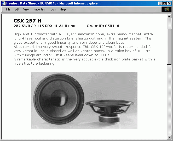

Make it easy, do like the rest of world.🙂 Use millimeters. What is 250 million people compare to 5 billions.😀
Ahem ahem.....I notice that your very own countrymen at Peerless of Denmark use inches in their product descriptions! 😛 😛
Well Well
We do a lot to please🙂 But under the skin it's millimeters.
CSX 257 SWR 39 115 SDX 4L AL 8 ohm
Diameter 257 millimeter 10" would be 254millimeter
Voicecoil 39 millimeter 1½" would be 38millimeter
Magnet 115 millimeter
So if you get used to millimeters, you will get more informations.
mvh
Claus
