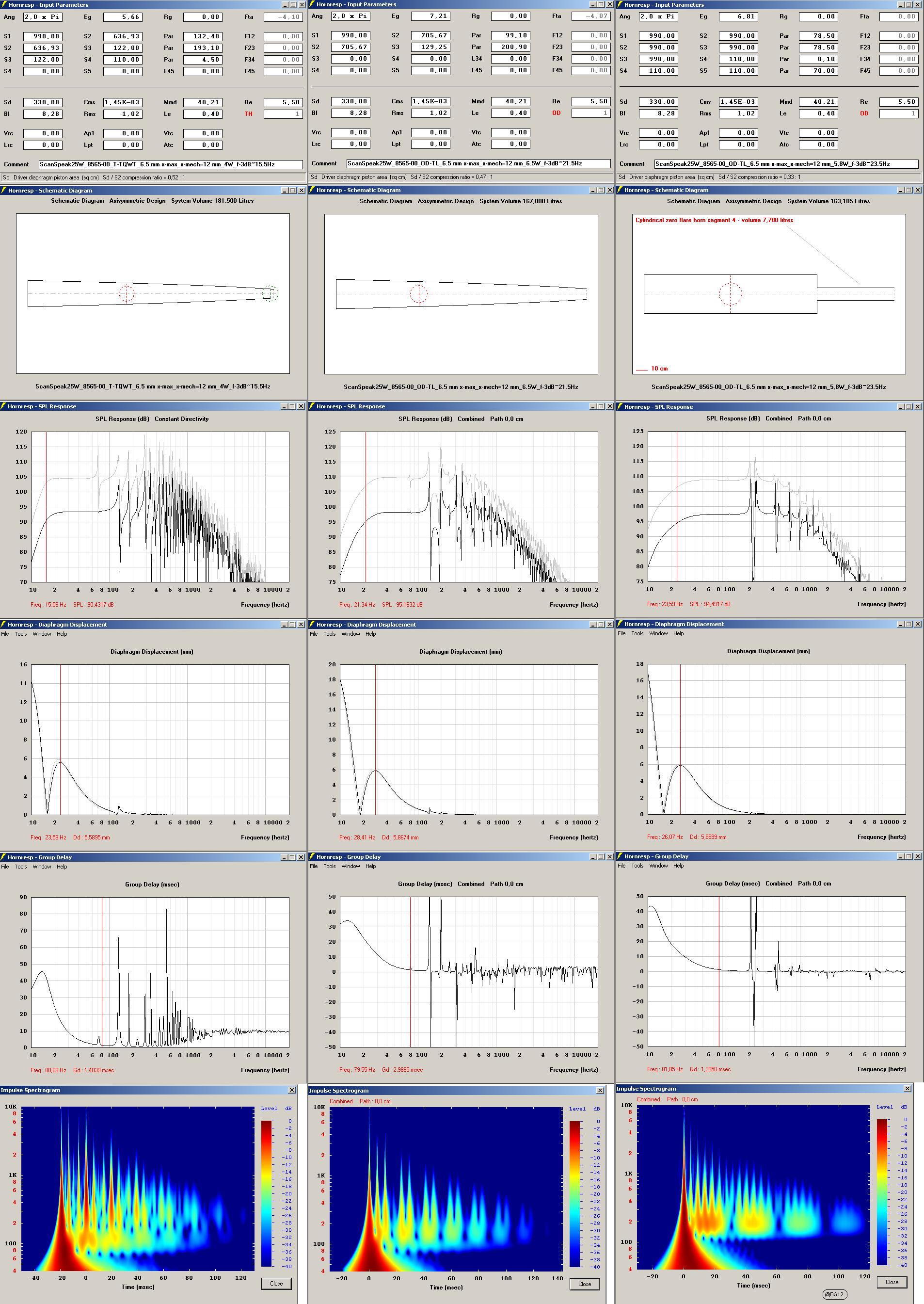

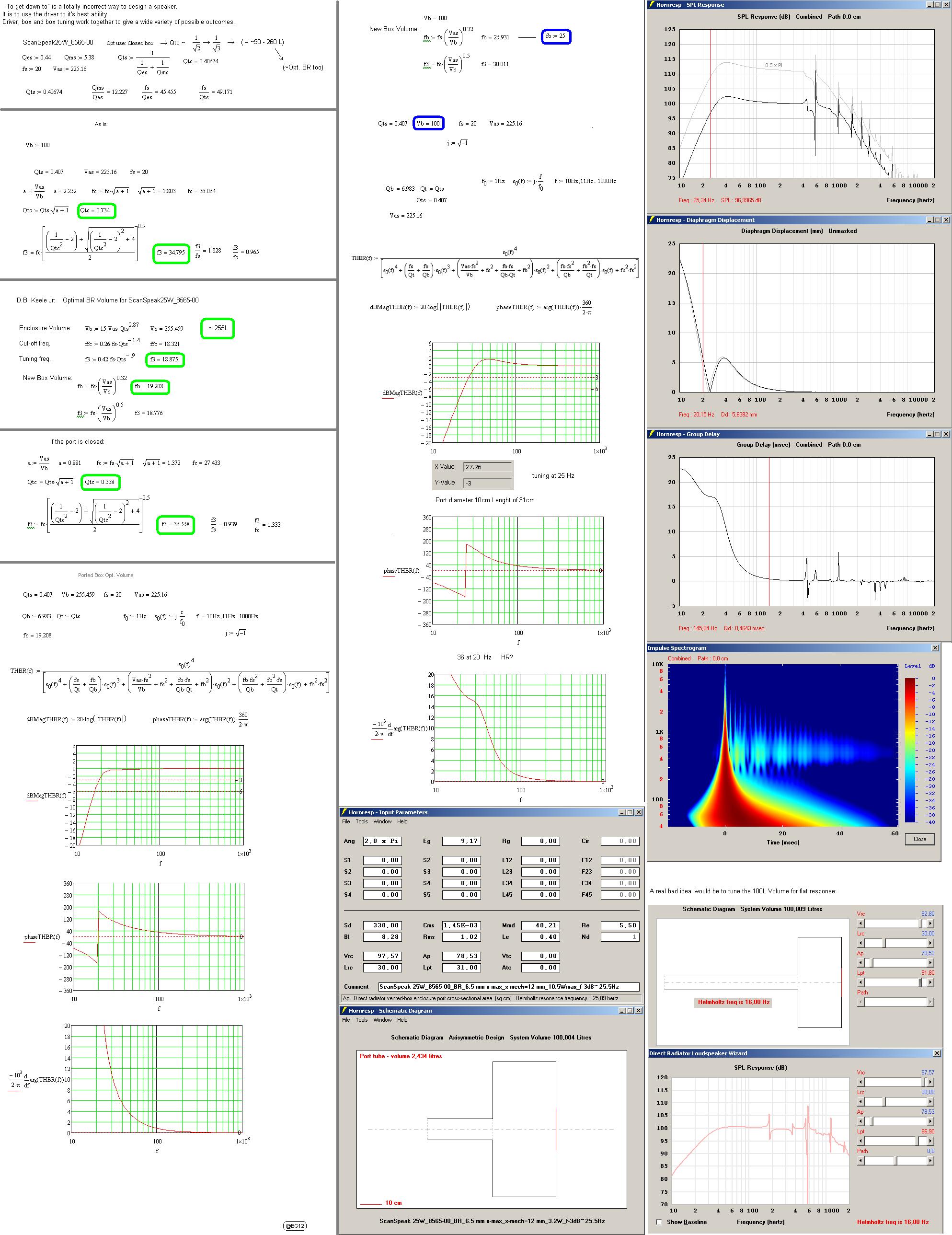

i have built a 100 lt sub with a Scanspeak Classic 25W 8565.00 drive unit and would like to port it to get more bass from it.
could anyone tell me the diameter and lenght of port to get down to 25 hz many thank gareth

IMO it's not a good idea to convert your near 'optimal closed box' into a BR as you would only gain extension when trading SQ.
IMO, a volume of >= 160 L is required using the very good Scan-Speak driver in a BR box, i.e. I would consider to build a ML-TL BR box.
