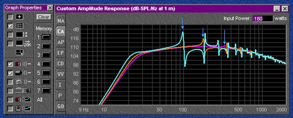

how about the amplitude of the pipe resonances? does the larger or smaller port have the loudest resonances,or are they equal
Lower frequencies carry more acoustic energy, i.e. they ring the bell louder. That's why higher frequencies are easier to damp.
Here's a pic to help visualize. The frist arrow (left to right) is for a port that is 68" long, second 34", third 17", Notice the amplitude of the third pipe harmonic of the 68" is stronger than the primary of the 17".
If your only demand is to attenuate low frequency as per your diagram, you would me much better off to use closed box. Much less complicated work (box), no frequency shifts etc...Any port will augment low end frequncies, BR or TL, so what is the point of introducing them in the first place if you are happy with subdued low end...just my opinion.
in my diagram the port still offered a increase in overall output, when compared to a sealed box it looked alot better.
my demand is to amplify low frequencys, just less over a longer range

In reality, your port will have almost negligible output (except for the resonant spikes), the important thing is the control over the woofer. I've been using this approach myself, lately.
