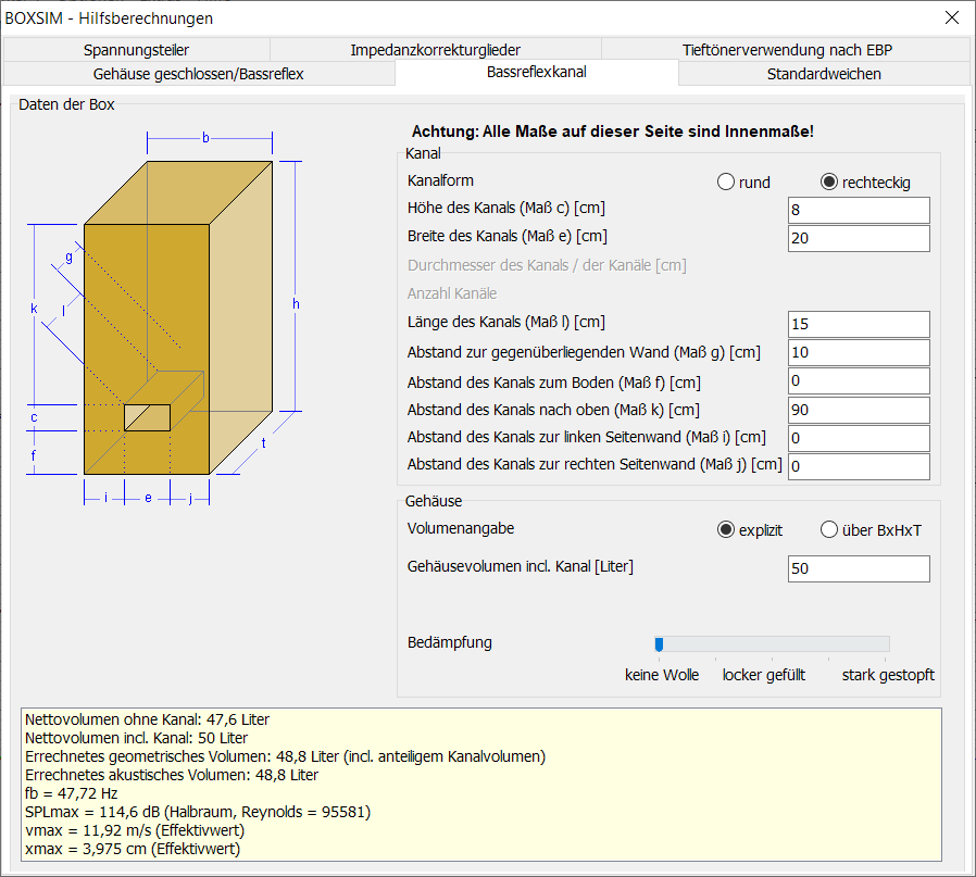

Boxsim contains a tool to estimate the effect of walls on the tuning frequency. Extras --> Auslegung Reflexkanal
Boxsim - Homepage
