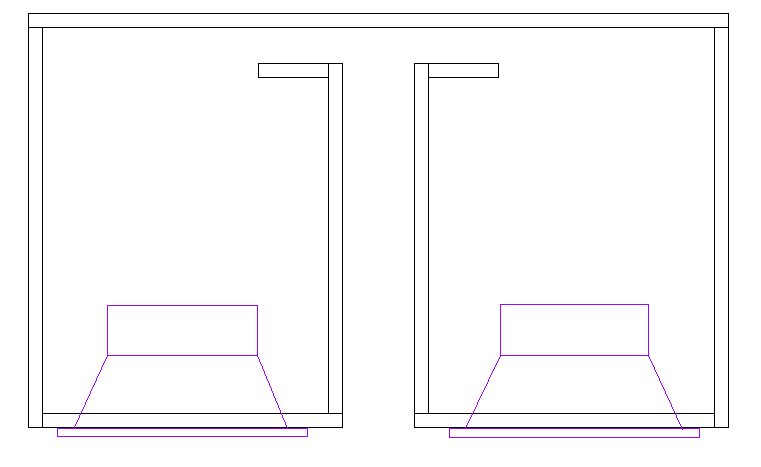

Gents I am building a box for a pair of ten inch subs.

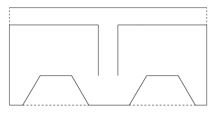

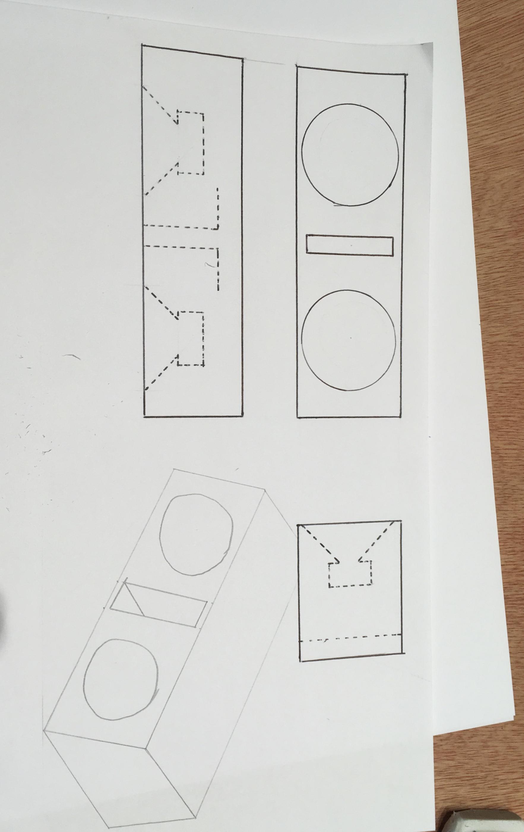

I want a ported box and have calculated the volume and size for a port which will run the full height of the box and about an inch wide. This will run the full length front to back, providing bracing at the centre of the longest panels, and out to either side in a sort of “T” shape ( when viewed from above).
My question is there any reason I cannot put the port in the centre of the box rather than to one side?
I think this will effectively create two boxes breathing through one port, any potential issues with this approach?
I can't envision how two air spaces can share a common port and remain separate. I think the compression/decompression of the air would be distributed between the two volumes evenly, making it a single shared air space. A picture would help to understand what you have in mind.
If the OP means can I build the port like in this sketch, then the answer is yes.
Because the end of the port is built in along the back wall of the box, it may behave as if it's longer than the physical length - this is due to the fact that three of the 4 walls of each end of the port continue past the end of the remaining wall. That means it may yield a tuning lower than predicted by simple box modelling tools such as WinISD - you may need to be prepared to build a prototype with a removable back so you can get access to cut the port ends shorter once you measure your actual tuning frequency.
HTH,
David.

Spot on David, thank you.
The subs I'm using are JL audio 10w3v2s and the manual says to contact JL rather than simply just double up on box volume and port area.
They suggested 15"sq of port area and a length of 16.125 inches with a box volume of 2.25 cu.ft. net. this box is built to that spec.
I take your point about the port, is there any way apart from prototyping to model this behaviour?

Hmm, a slot loaded port with both a fairly huge baffle/side wall end correction plus another one on the backside, so maybe can be simmed in AkAbak; otherwise if using a standard vent calculator it will predict a much higher tuning than actual.
This should get you closer [B: high pass filters], but AFAIK will still be tuned too high since I've no clue what the end correction would other than the standard slot port one [K = 2.227] may be a 'close enough' compromise: http://users.cms.caltech.edu/~ps/All.pdf

Thanks BSE, it will be powered by a Soundstream monoblock so no worries on that account.
My chief worry, before David raised his point, was that the two subs might be pushing air "against each other" due to the 180 degree port entry orientation.
Nah, that'll be fine.
If you think about it, as long as each each driver moves in the same direction, they each create the same pressure change inside their own chamber, and thus the same activation of the air mass in the port.
If you screwed up your wiring and had the polarity of one driver backwards, then you'd have a problem all right, but barring that you're good to go.
Re the calculation of the port, if you want to do a bit of number crunching you can recalculate port length with a different end correction value as alluded to by GM, but I don't know how well it would account for the back part of the vent being split with most of the port being single, hence prototyping will probably still be needed.
