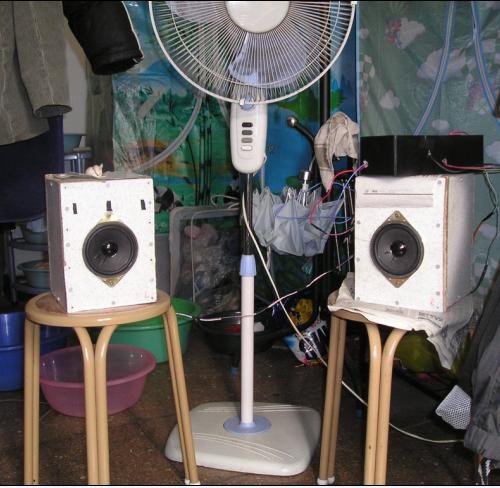

i'am coming here to improve my English,meanwhile,i like hi-fi audio very much.i made a pair of sound boxes last month,but i don't know how to post the pictures here.
