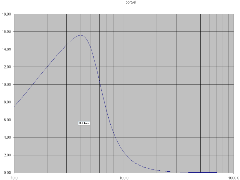

What is the voltage measurement where you start to get noise?
Attached is the port velocity graph for 10W RMS (12.65Volts RMS). Velocity is proportional to Voltage, so you need twice the voltage or four times the power to double velocity. Supposedly we want to keep out port velocity below 15m/s to avoid problems.
Chances are you are expecting too much and running the woofers louder than they can handle. The predicted displacement limited power handling of that box is only ~10WRMS (12.65 Volts RMS) at 65Hz, but since the suspension will not be perfectly linear, it might handle twice that power.
Any more than that and it isn't hifi, it's distortion.
P.S. I know the rated thermal power handling is 80+ Watts, but that has nothing to do with driver mechanical limits.
