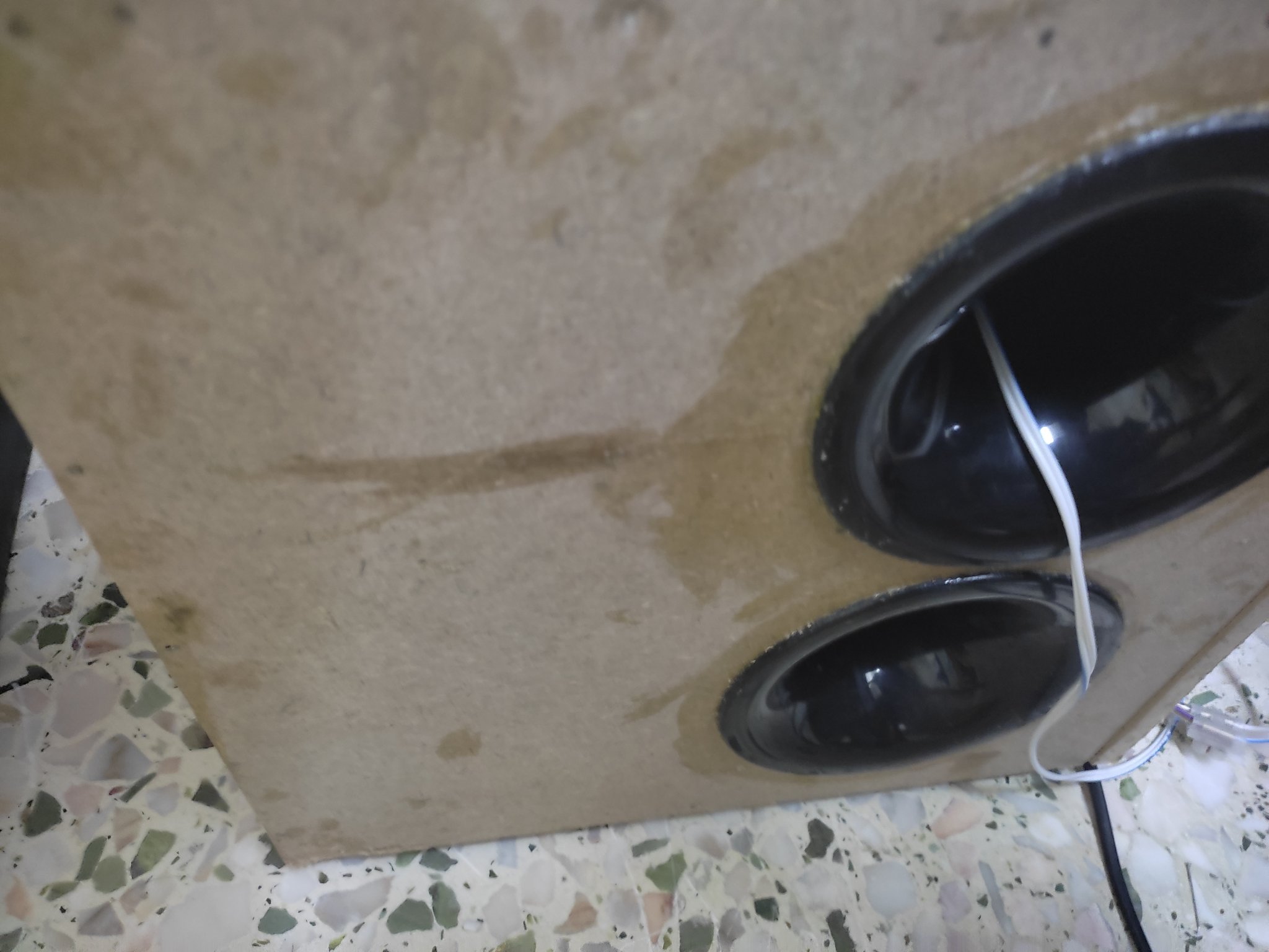

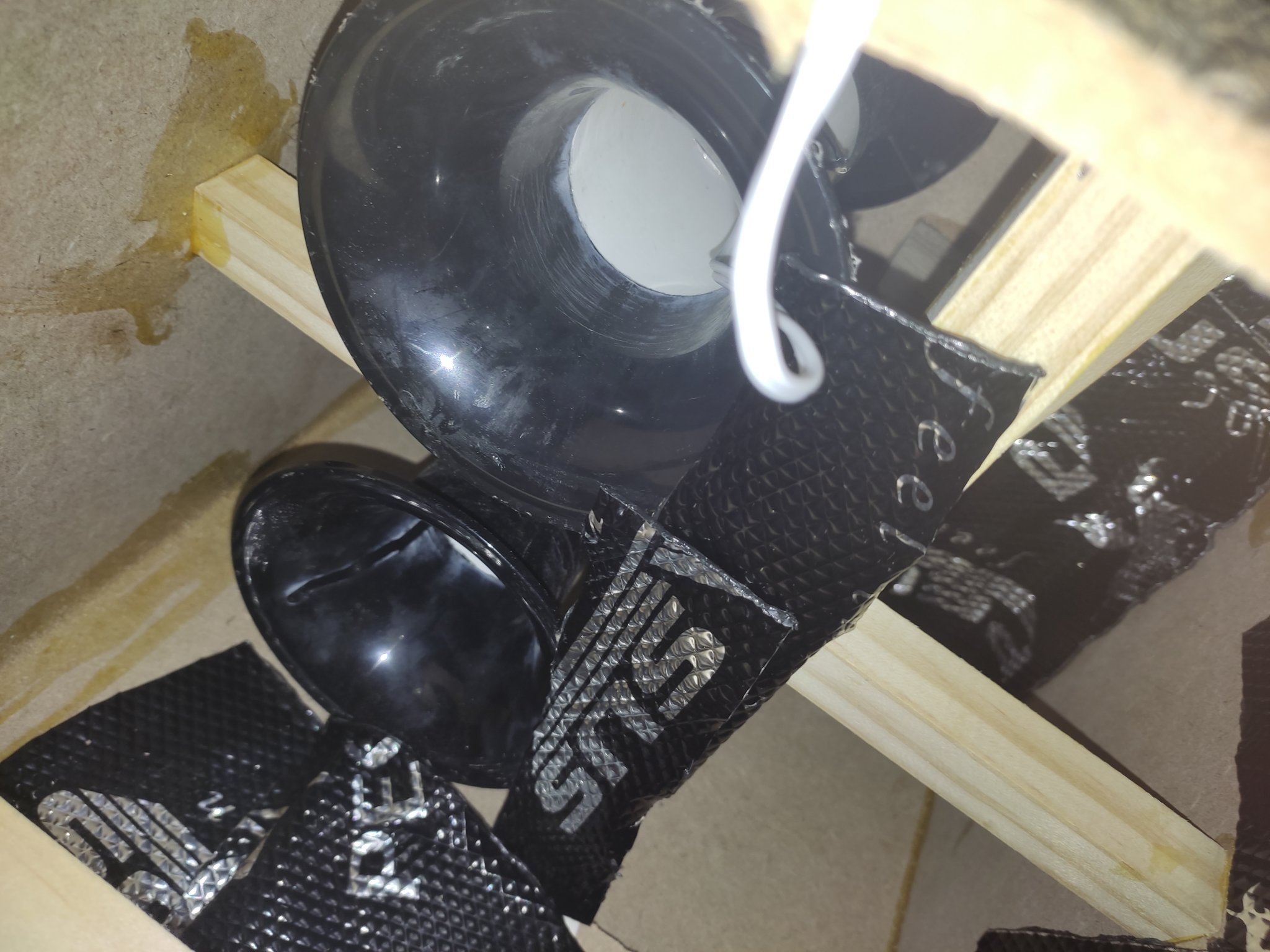

Port noise could be dealt with using double large flared aeroports ... From my experience ... Make sure to seal it from the mounting inside too ... Some air can leak past there

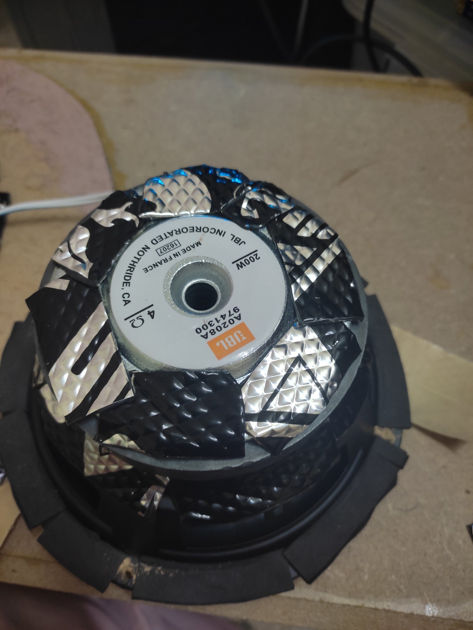

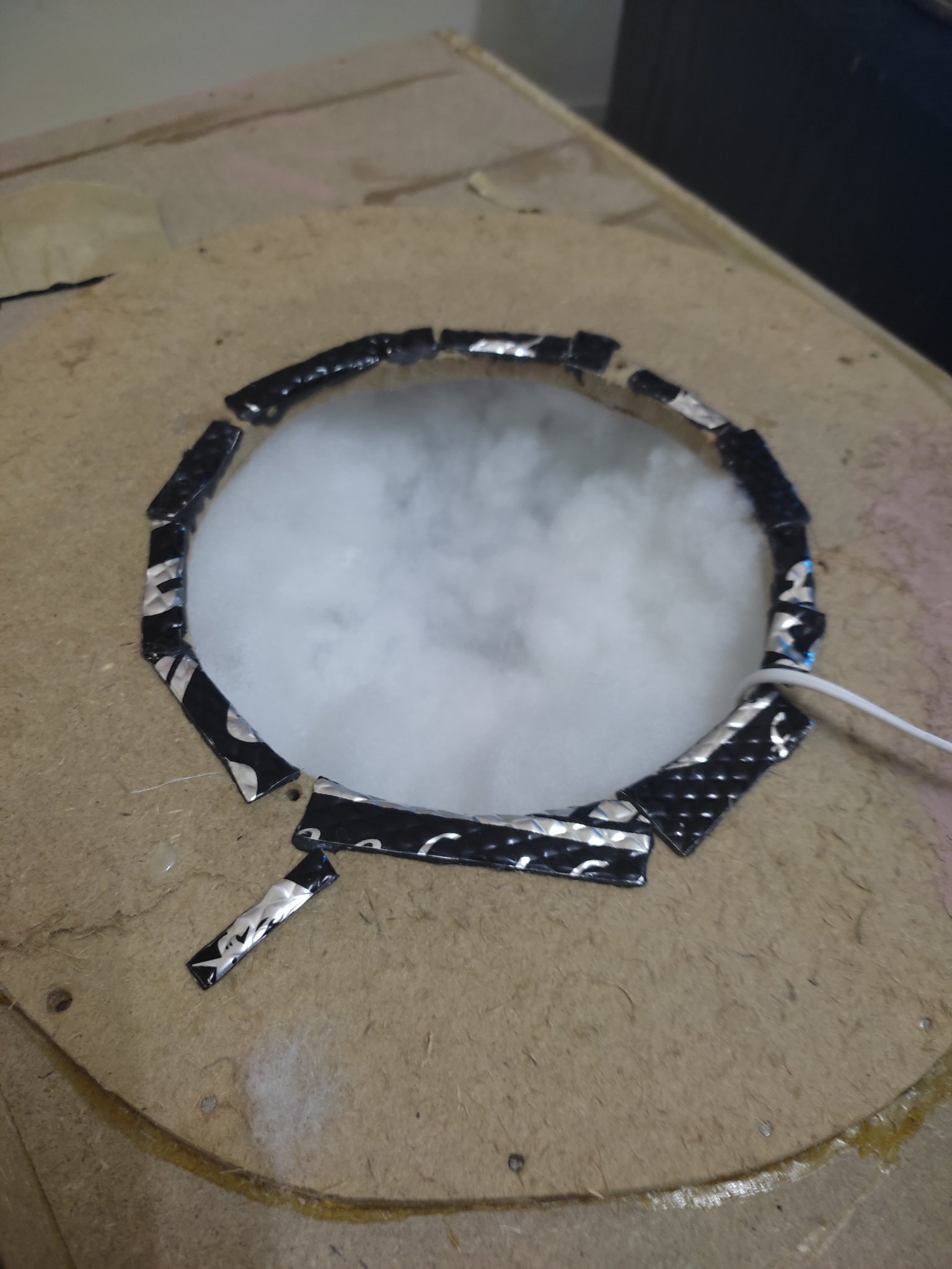

Drivers ... Some soundproof sheets proved to be useful .... Attach them behind the magnet frame and basket frame assembly ... Some polyfiber and loose pillow may help with the noise too
Mount the drivers really air tight by using modelling clay to make driver gaskets ... Works for me so far so good

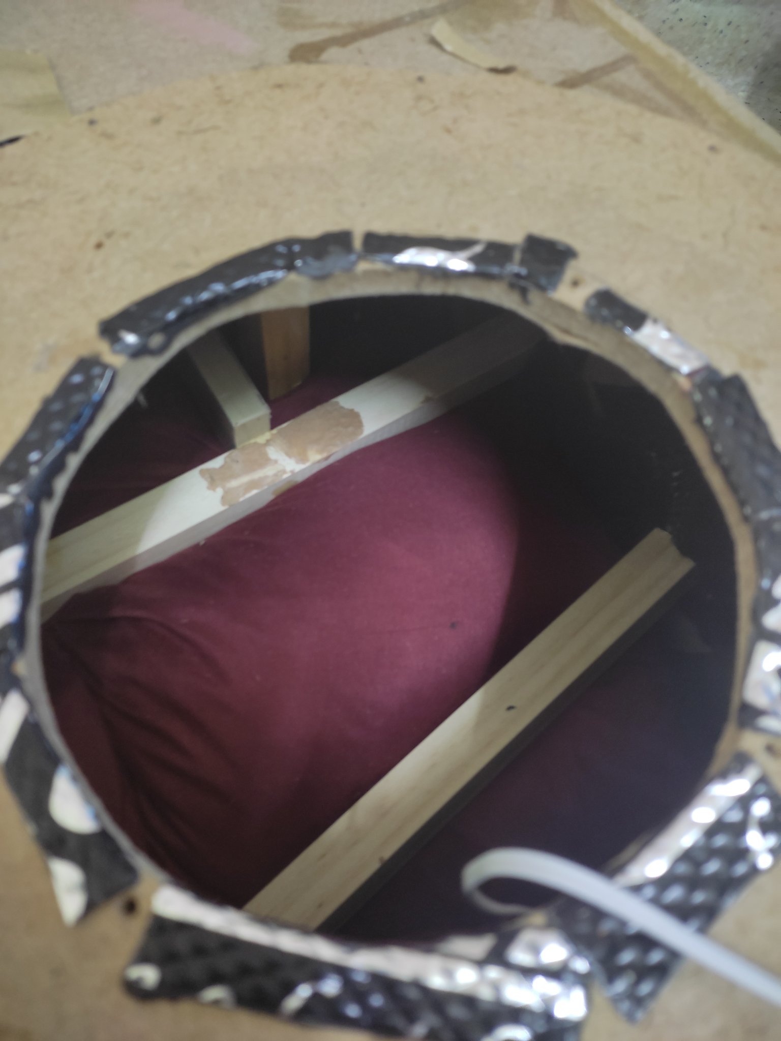

Box ... That is something needs to pay attention too ... Wood glue alone is not enough ... Sometimes i need to layer it with silicone and even some wood putty filler to make it really sealed
Below photos showed how i prepped for the subwoofer box treatment ... Might be considered overkill 🤣😅
