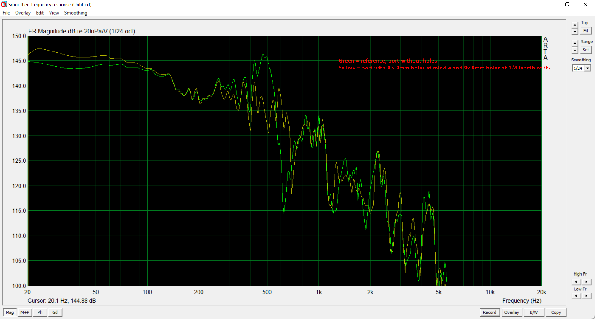

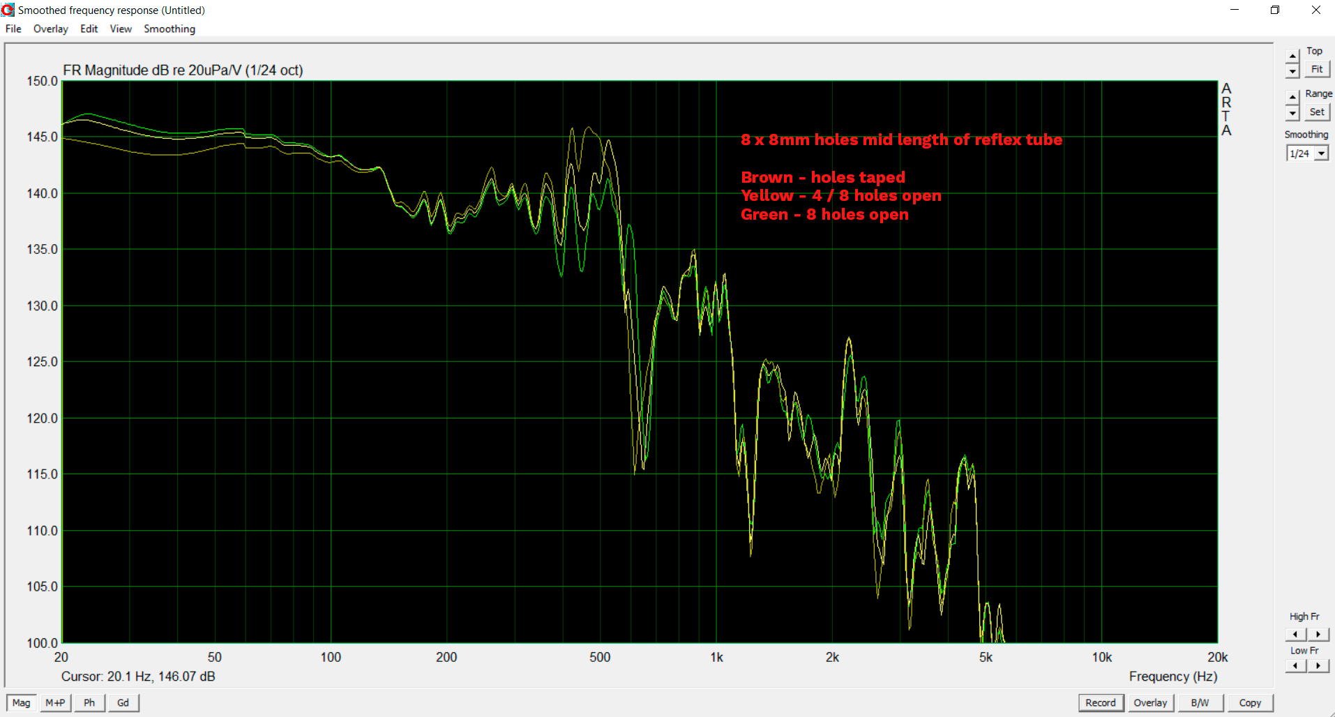

Hi all,
did an unscientific test with perforated tube and result was positive to reduce midirange leakage from the port. Also, with quick check in WindISD port effective length seems to be in ballpark what Pit Hinder said, ~1.4 times the actual length with the perforations I made.
I have no clue how this affects the port response on high SPL. All I know that this single experiment reduced midrange peakiness in the port, and raised the port resonating frequency.
the ports are 100mm plumbing pipe, 26cm long. I drilled 8 holes with 8mm bit to the midway of the pipe and another 8 to quarter length. I first taped the holes with gaffers tape and then removed the tape revealing some of the holes at a time. It seemed that the mid leakage and low tuning frequency pretty much walked hand in hand with the amount of open holes.
I don't have outer shell or damping for the holes, they breathe freely to the enclosure.
If one makes a speaker with ported woofer and high crossover to mid and find nastines in midrange by measurements and listening tests this might be a good tweak to try 😉 Make port 1.4 times too long, drill some holes and adjust the low resonance to target with tape.
