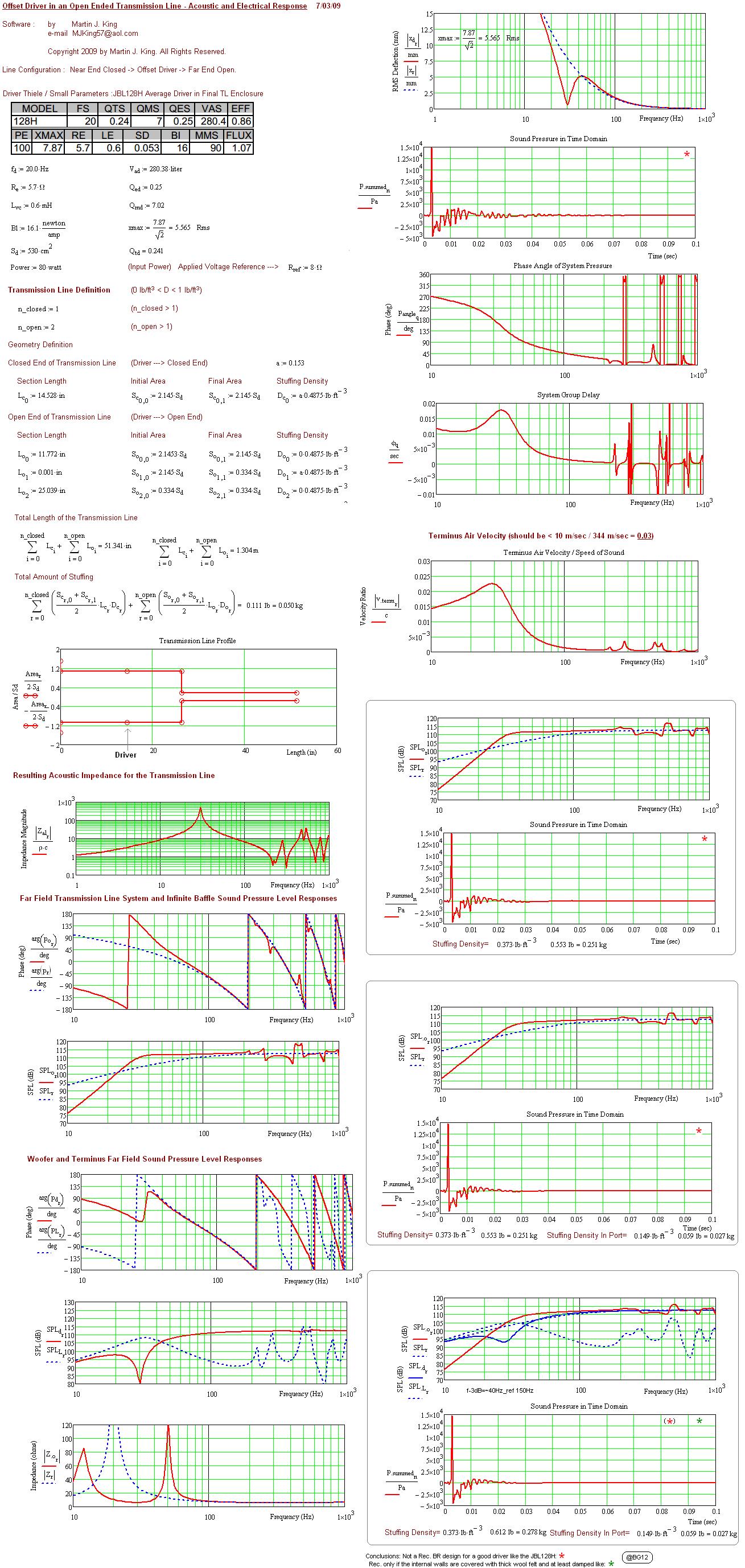

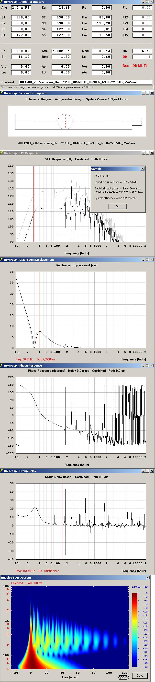

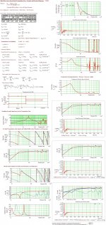

Hi all,
:2c: of observations:
If the subs are to be XO'd using LR4 at 150 Hz with no localization cues or phantom spreading down to the floor:
I recommend a stuffed OD_ML-TL with a non-stuffed port that do not contribute to easy heard artifacts, i.e. avoiding simple BR boxes with long resonant ports as stands for mains or for stand alone subs.
b🙂

Bjorno,
i would very much like to stay vented right know, more than enoughf i dont know about that yet, and theres nothing i know about tl speakers...
my "complete" subwoofer setup wil be 3 12" main subwoofers(acting like one) between the front speakers, one 10" or 12" ported subwoofer in the rear corner and a small sealed 12" subwoofer behind the seating area.
Hopefully i can integrate the subs seamlesly a bit lower than 150hz, the fronts have a -3db at 95hz and a gradual rollof.
can you post a link to pictures of a similar design as i dont really get get the concept?
best regards panduro and thanks for all the answers
