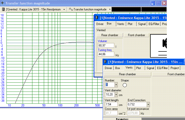

First I went to NotaxNotes and it said a working diameter of 212,8mm (this is based on T/S-derived and experience as he said). The formula is there for you to see. I am not working with the formulas as I use the software(s). This is my methodology. Ok, then I went to WinISD, did you checked it(?). All the softwares might have the formulas somewhere or then email their authors asking for that imformation. I don't know what your objective is, but you decide if you want to go the scientific way.
In WinISD it gave me a first alignment of 81L. I'm going to insert here:

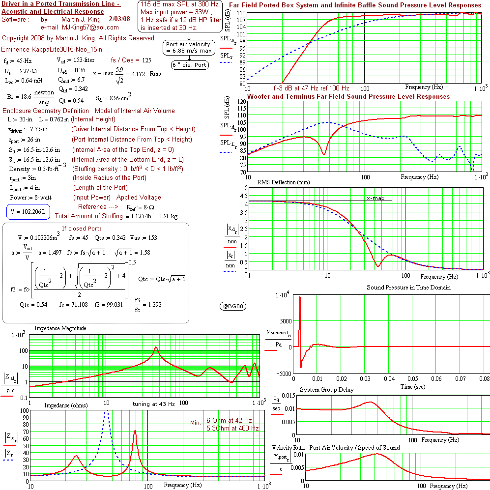

Port/ Driver placement is crucial if low ripple FR is a goal and IMO if XO: ed above 250 Hz, all the internal walls should be covered with at least a ¼” wool felt or similar in order to prevent internal reflexes to leak through a short wide port at high signal levels causing vertical image shift and larger MAA.
OTOH if XO: ed below 250 Hz (>= 20 dB/octave) the MAA or Location issue can be ignored as long as the driver is a low distortion type.
b
1(1)

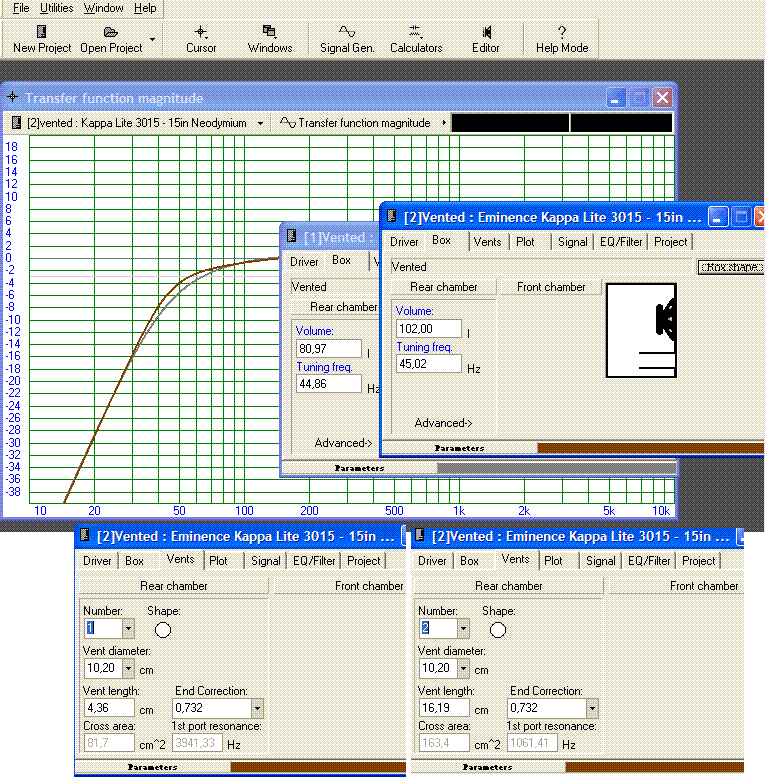

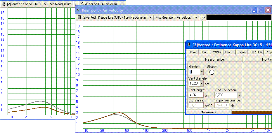

I used a second alignment, that you told me (102L) here:
As the first is with one vent of 10cm, I used a second try with 2 vents to be close to NotaxNotes 20cm.
Also note that this is for flared tubes on one side, because we can choose it, as this parameter was set first (assumed by the software) - one, two or none.
