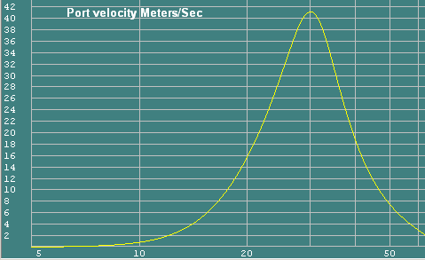

Port area vs efficiency.

I have a sealed and ported speaker for testing and comparison. Red is ported in 20 Liters and blue is sealed is 45 liters.. My in room measurements reveal that the sealed speaker has near identical low frequency extension to the ported speaker. Seems to align with witwalds explanation.. I continue to examine all aspects of in room bass performance and qualities🙂
No I don't think it does. The ported one should NOT have the same curve in the room, it should be elevated. But you can't compare the simulation versus actual measurements. You'd have to measure the actual response of each box. Likely in the near field-easy for the sealed box. For the ported box it's more complex because you have to scale the outputs as the ratio of the areas (or is it the square? I forget exactly, haven't done it in a long time).
"My in room measurements reveal" I expected the the acoustic measurements to resemble the sims, of course with addition/subtraction of room response but with noticeable lower frequency extension from ported vs sealed.. I will measure nearfield of both speakers and take look at 2m from both.. Thanks!
