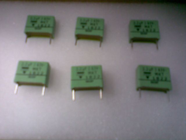

Ok the MKTs have arrived. But they look kinda big to be able to replace those existing caps (see blur pix). Their legs measure 15mm and the legs are not as leggy as the normal aluminum caps.
Looks like I be bending legs again... Aarrgh!
Easy on the leg, bend them slowly.
Solder a bit of wire in one or both cap hole for extension and you can then solder directly on the wire.
The Poppulse board is not of high quality so be careful or you'll pull out those copper trace.
Whoaa.. Welcome Pano!
And double whoa... I checked the Elna caps that are to be replaced with the MKT and it is like trying to put a square peg into a round hole.
The Elna's are a 10uf/16v 5-6mm caps. No way it can be done with the 15 mm MKTs especially the ones next to the ATMEL micro controller chip. It will mean a mod of the mod. Heh!
Any suggestions ChuckT?

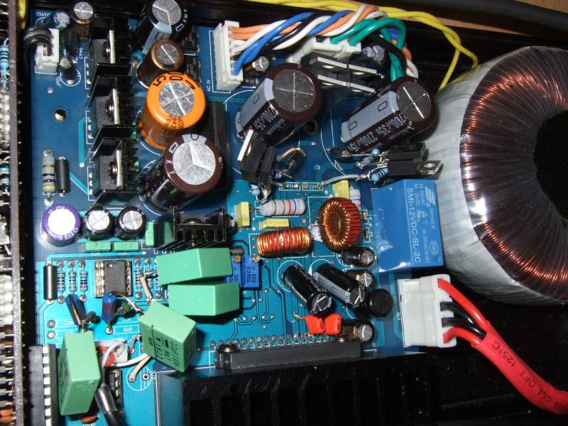

How do I mod thee? Let me count the ways.
I mod thee to the depth and breadth and height
1. Change the 6 coupling caps - I use mkt1822
2. Add a 270uf/35v ZL cap to the empty cap hole next to ta2022
3. Replace all the 78/79xx to Motorola MC78/79xxACT. I don't like Fairchild 78xx. The Motorola 78xxACT has better spec.
I could go further and use the Linear type(eg. LT1763), maybe later.
4. Replace various decoupling caps to low esr type.
Elna for Audio -> Nichicon PW 2700uf/35v (what I have on hand at the moment.
Chemicon KY for the +15v, Sanyo oscon for the 5v.
5. Replace the +/-35v rectifier to Fairchild Stealth diode ISL9R860P2.
6. Add a discrete regulator for the +/-35v. I don't know why this wasn't done in the 1st place, even if it didn't sound too bad. I feel better with regulation. I use the simple Zener referenced emitter follower. Don't ask me, I am new to discrete regulator too. Maybe someone can help me to improve this too. I use MJE15030/31, BD179/180 transistors.
Check below for very good info.
http://www.pedjarogic.com/gc/supplies.htm
7. Replace the coil to the 41hz coil that I have on hand. The old coil is far too hot, the 41hz coil is quite a bit cooler but still warm.
I am still looking for better inductor to replace it.
8. Add 2 0.1uf orange drop cap directly on the +/-35v pins.
Don't know why the whole +/-35v has only the Elna 4700uf and a 0.1uf ceramic close to the +/-35v pins for each channel.
9. Bypass the opamp and connect M62429 output directly to the ta2022 input. I know need so much gain and this gives a cleaner sound.
10. Replace the input resistors. I reduce input resistor from 6.8k to 220R using RMG resistor. The 6.8k is use to reduce the normal 2V input a lower level as M62429 can only take max of 1.7V.
I use deq2496 with direct out so output level should be lower than 2v.
11. Replace most of the smd resistors to better type: SUSUMU 0.5% and feedback to more expensive IRC 0.1%
Thats it so far.
I think there are still a few more thing that can be done like replace the caps in the output filter, add a snubber for the PS but don't know the values.
Amazing I did so much with a baby crawling around...:rolleyes:
Don't ask me about the improvement, too difficult for me to describe.
Here the inside pic

Changing the 4700uf Elna seems easy enough. The Nichicon you use is the LLS series?
Read my list again, I bypass the opamp, so the corresponding caps are not required.
Nichicon PW 2700uf/35v , just what I have on hand. A higher uf one will be better. Other low impedance caps will be ok too.
Replace with mkt1822 and the quality of the bass will be better (not quantity)
Also I recall replace Elna to Nichicon helps a bit too.
