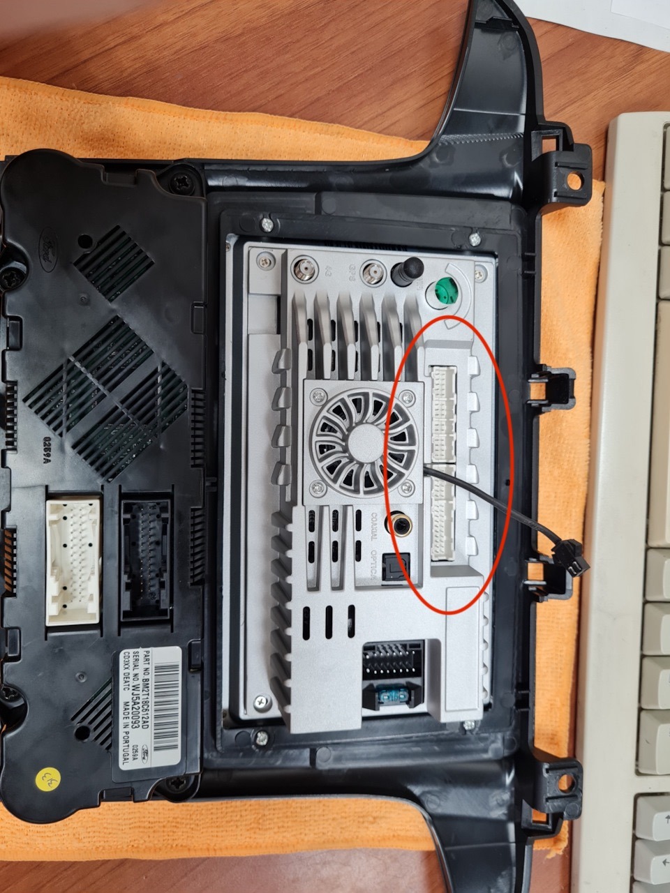

I have an Android head unit with the following setup:
The problem is when I’m switching between radio/Bluetooth or any other source like launching the car link or putting the device on mute I hear a strong pop sound from the subwoofer
Also, when I tried another head unit (the original head unit) the problem disappeared
I tried to measure the output wires and the RCA output using a multimeter in DC mode and I noticed that the reading changed when switching the source
Here are two videos for the measurement process
Speaker wires measure:
RCA measure:
Any recommendations to solve it
- Speaker output socket: for the door speakers
- 1 RCA output socket: connected to the amp using a splitter
- Remote power wire
- Kenwood amp
- JBL subwoofer

It would need to be a circuit diagram of the head unit's circuit board. Popping with external devices could be those devices but switching between various internal functions of the head unit itself would indicate that the problem is internal.
Does it pop with no source connected to the head unit and only using the internal sources?
Yes it pop without connected source and I believe it’s internal as you mentioned
I’ll try to find the circuit diagram but I believe it will not be easy to find it
I can take photos of the motherboard if that would help
Photos probably won't help but cost nothing. The components near the RCA outputs would be of interest.

Not NEARLY good enough. I'd need to know the exact two pins where they go into the board and the circuit components that connect to those pins. It may not be worth the effort to get that information.
